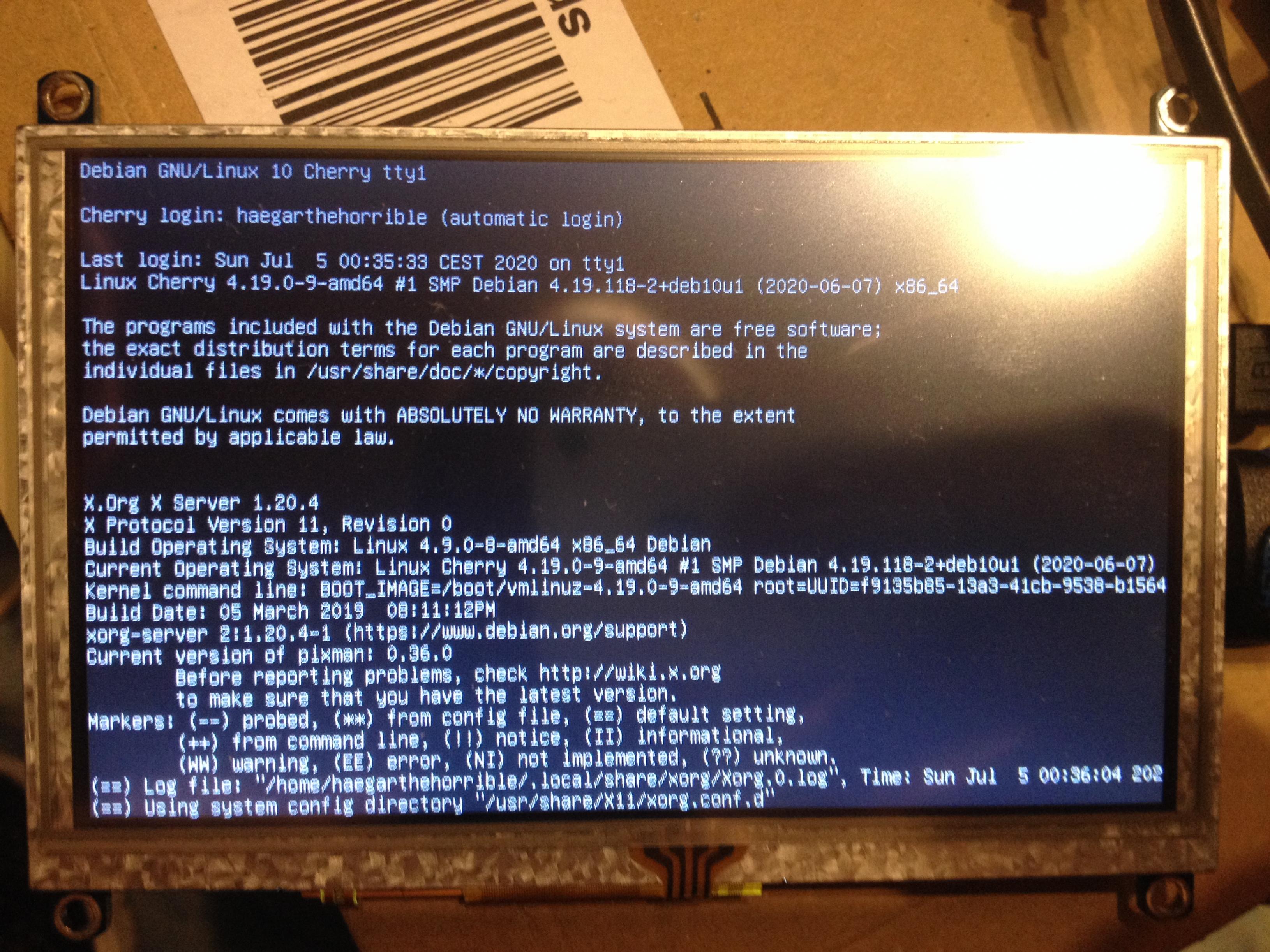

I'm closer now.
It seems like i need some kind of X.
I did install different things but i'm not sure what really is needed.
Then i did:
This starts X and the Terminal and then touch is working.
If i do:
directly on the machine then Peppy starts, display is right (not shifted) and also touch works in Peppy.
Only thing i still can't figure out is how to start Peppy on boot.

But when i do:
it does not work.
If i do:
Code:
~$ cd /home/haegarthehorrible/Peppy
~/Peppy$ python3 peppy.py

Must be wrong because it seems to be the default behaviorThe display backlight control works only for displays connected through DSI interface. It doesn't work for any other display (SPI or HDMI).
PCs have the power saving for monitors on most of the time (no matter if VGA, DVI, HDMI).
I wonder you did not have your screen going blank/off. It happened to me now and that was the reason to look around why it does happen. Its the first time i have a monitor connected to Debian because i always work over SSH with Putty.
If you Google, a lot of people have that also with the Raspberry and ask how to disable that.
There is also this site: Setting the screen saver/screen blanking - Raspberry Pi Documentation
I thought running this commands will disable it and I'm done:
Code:
~$ export DISPLAY=:0.0
~$ xset s off
~$ xset -dpms
~$ xset s noblank
The funny thing is that if Peppy runs the screen does not go off. There must be some background stuff running in Peppy that keeps the screen alive?

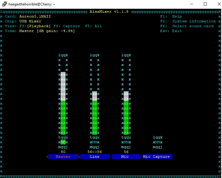

Volume Control
Sorry i did miss the wiki entrie about volume control.
I'm using an old USB soundcard.
I did now:
Code:
[volume.control]
type = amixer
amixer.scale = linear
amixer.control = Master
