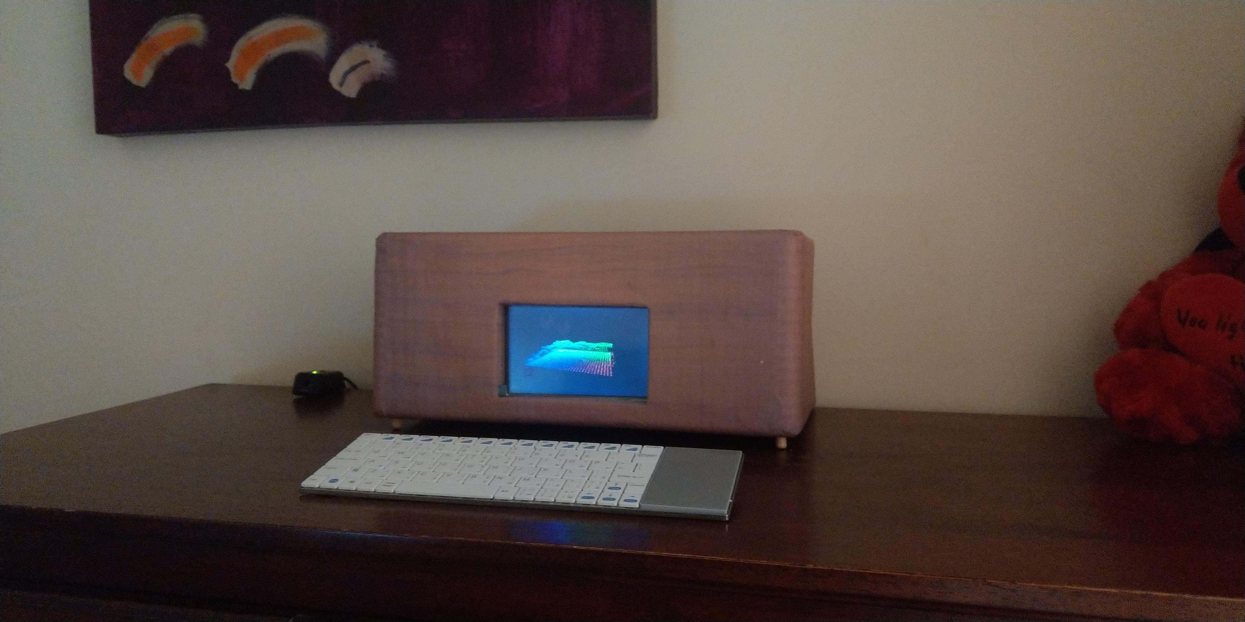

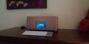

btw this is what I made.. made from scrap.

You have pretty good looking Kodi project. I tried Kodi long time ago and decided to create my own player So I'm not the right person to ask about Kodi.
If you will face any issues with Peppy player installation please let me know.

I'm glad to present the new project by Tobias (Germany). Like his previous project this one also has VU Meter based on the Nixie tubes.
Gallery * project-owner/PeppyPlayers.doc Wiki * GitHub
The self-made plywood housing consists of:
- Raspberry Pi 3 A+
- Kuman 3.5" 320x480 Touchscreen
- Turner Edition Disk Image for Waveshare 3.5'' (/boot/config.txt changed to dtoverlay=waveshare35a)
- 5V/11A Power Supply from Pollin (too much power, but it was at a good price)
- USB Sound Card
- Logitech Z200 speakers (disassembled, amplifier switched on by a relay card to avoid strange noises)
- IN-9 Bargraph tubes
- 150V DC supply (self made PCB, using Z-diodes powered by DC-rail of the power supply)
- PWM-power stage like here: PWM-VU-Meter PWM VU Meter * project-owner/PeppyMeter.doc Wiki * GitHub)
- Rotary-Encoder for volume
- Raspberry Pi 3 A+
- USB Sound Card
