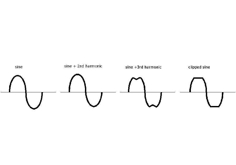

what is 2nd harmonic distortion? what is third? what is the harmonic content of a tetrode/pentode classAB2 output stage in clipping?
2nd harmonic distortion is the simplest form of amplitude distortion... and it is the result of an amplifier that treats the positive and negative going phases of an incoming signal with different amounts of gain. if you were to look on your oscilloscope at a sine wave with some second harmonic distortion, it would still look like a sine wave but one of the opposing "humps" would look bigger, or smaller, than the other one. simple. if it were pure 2nd, there would be no clipping, rounding, notching, etc.... just one phase's amplitude is different from the other. this is why it is very hard for 90% of the population to hear it, according to feldkeller und zwicker, who wrote one of the most complete and utterly german treatises on distortion ever written. so don't think i'm just pulling that out of the hat... anyway, many people describe 2nd harmonic distortion as lending a "chorus-like" fattening to a signal, especially pleasing with things like strings, which have a lot of upper harmonics that compete (deliberately) with the fundamentals. hmmm...
3rd harmonic distortion, ahh, the guitar players distortion. sometimes confused with/called "soft clipping" (!). this is the primary distortion of the tetrode/pentode and while it resembles clipping, there are some important differences...
think about a square wave... what is the relationship between a sine and square wave of the same frequency? one definition of a square wave is a sine wave with the entire series of odd order harmonics added, starting with the 3rd.
because the output stage of most guitar amps is PP, the 2nd (and the even harmonics above) produced in the output gets cancelled leaving the odds and 3rd most of all. if you drive the amp into 3rd (on the way to full on clipping), but with not too much of the higher order odds, you get some "metallic edge" and "bite", but its not nasty sounding. you can still play chords and the dissonances are low order simple and interesting ones: mostly upper 5ths (music notes) if you are playing simple major and minor chords. if the ratio of higher odd harmonics is increased (more square wave), it gets increasingly difficult to play chords (think of a fuzz box like the big muff pi...) and the dissonances can be nasty between certain intervals (minor 2nd). some people (head bangers) will still like it... but probably not a blues player!
well, couldn't we mix some 2nd from the preamp stage with some 3rd from the output stage to get a nice blend? hmmm...

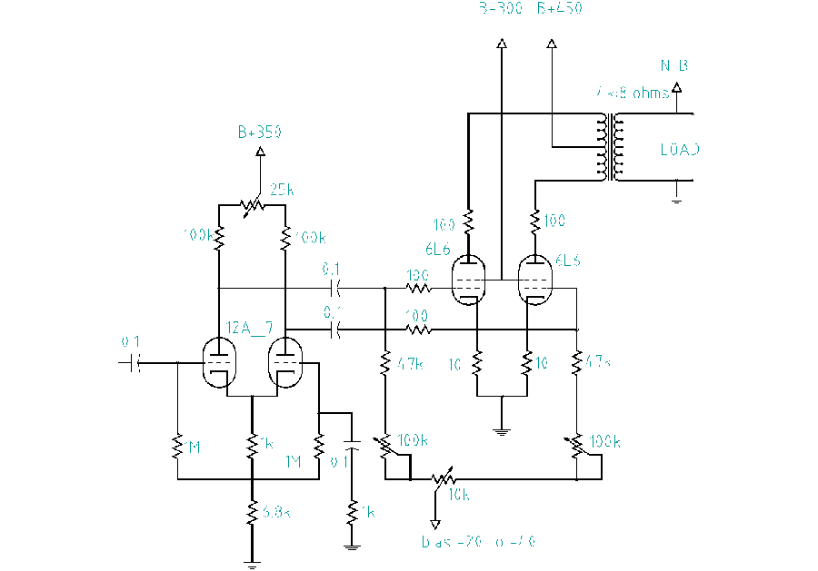

OK, back again...
so we were somewhere around dealing with the coupling of the driver stage to the AB1/AB2 driver stage with an eye on achieving a special kind of distortion.
i tried to make a point about fender amps and the driver stage used in most of them... and that is the output tubes are really a part of the way these amps distort... unlike marshall amps, which depend on the preamp to provide the color and the output stage just makes watts., relatively clean ones, right up to clipping.
the bias for most fender guitar amps (and therefore most guitar amps...) is a little lean even for AB1 operation and if the driver stage really was able to dump some current into the grids it would be AB2 we would be talking about. but they can't because of two simple reasons: 1) a 12AX7/12AY7/12AT7 doesn't have enough current to give, and 2) the caps are in the way.
now why would the caps present a problem?
the answer is TIME.
capacitors are electrostatic storage devices. they have a finite size that can only hold a finite charge, and, depending on the way they are charged up or discharged, this can go quickly or it can take its own sweet time. the thing that determines how long is called the LOAD. the source of current charges them up and then, after a time, the charge is discharged into a load. maybe it should be called the "mother load"? thank goodness that stuff isn't up to me! in driving a class AB1/AB2 amp, the load has two branches... the grid resistors that provide the bias for the out put stage and the grids... once they go positive. so, before clipping is reached and the driver stage is swinging below the diode line, the load that the driver stage sees is mostly just the grid resistors. but once the swing moves past the diode line (0 volts bias), suddenly there is another load, the grid current drawn into the output tube and towards the plate. the amount of current drawn by the grid before grid current sets in is pretty stable and depends mostly on how hot the tube is... it is on the order of 10 to 25 uAmps for a 6L6 or el-34 that has been broken in for awhile (brand new tubes still have metal oxides on some of the surfaces from the activation process and these will evaporate within the first 100 hours. all tubes from all manufacturers do this and the tube will behave funny at first). thats not too much but you can still do ohms law and see that the typical 220K grid resistor will drop 5 and a half volts at 25uAmps. so if your bias was -38v you actually have -32.5 volts on the grid.
now lets say that all of a sudden the signal clips the diode line... what happens? the cap which is discharging its jolt into the grid resistor now has to share its little package with a gaping hole.... a 6L6 with 0.1 volt positive bias and with 450 plate/screen volts (the plate/screen voltage determines the grid current now... not the control grid) draws about 500uA (+/- 200uA). lets do the ohms law again... 220K times 500uA = 110volts. but we only have -38v! so the bias at the grid will be pulled to someplace far from where it is supposed to be. but now the cap is discharged and recharges in the opposite phase for the amount of TIME it takes. what had been a fast clip has been dragged out. if the guitar player is insistent (as they tend to be), and there is no let up to the clipping signal for a period of time... the cap drags the driver stage plate voltage into it and decouples the new voltage drop into the grid and the tube starts to turn a funny color of red. loss of bias. IF the driver stage, which is often latched at this point because the load (the output tube grids), is pulling the driver plate voltage further and further down as close to ground as it can, can do anything at all, it isn't much. the signal is compressed to some fraction of its true self. self destruction nears. the output tubes grid welds evaporate and maybe a grid/plate short just for good measure. end of story. the cap slows down the recovery time from clipping and holds a positive charge that can be added to by successive clipping until a state known as "runaway" occurs. its fun to witness some one else's fender or marshall amp do it but a real bummer if the amp was yours.
this can be minimized by observing the manufacturers recommended maximum grid resistor for fixed bias operation... 50K ohms for most of the tubes we are talking about. nahhh, forget it!
the problem is that a little drag on the recovery time kind of sounds nice! and it also adds yet another distortion effect that is much loved: compression! also known as "sag". i'll do sag from the power supply some other time, but i wanted to post a little circuit for your entertainment...
this is basically just a fender amp AB1/AB2. i left out the un-necessary stuff. there are enough adjustable things here to test and see just what will cause what. the plate pot gives you some AC balance control (you can add some 2nd harmonic here if you want). the grid leak pots are a safe way to "load down " the driver without risking runaway. the idea is that as the swing on the driver increases, it has a harder and harder time swinging... this gives "sag". you can adjust how much you like and then measure (with the amp off of course) them and solder in the right value. the values are deliberately less than ideal. the grid bias balance pot SHOULD be added to every guitar amp. the resistors on the plate and cathode SHOULD be too. you can measure plate current at the plate around the 100 ohm resistors. the 10 ohm cathode resistors are for sag and safety. don't measure current there, it tells you nothing because the screen current is also going through the cathode. it should not be too hard to add these things to the underside of any guitar amp to be removed if you need to sell it as original.
enjoy!

JC,
OK, so are you saying that the time constant has something to do with sag? So I load down the PI and that creates compression? 50K will draw enough AC current to make the coupling caps run out of gas? Do I ajust the the outout grids together or create an imbalance (guess I should try it and find out) If together then I can use a dual gang pot.
Are you saying the 25K pot hooked to the PI plates is where I add the even harmonics? I guess one side swings more volts than the other and then this shows up in the transformer like even order harmonic distortion.
I'm inclined to swing the PI balance pot all the way in one direction and then turn one grid pot all the way up and one all the way down to see what happens.
BTW, what ever happend to the postive grid region and AB2? Typical newbie impatience.

hey blues,
yes the time constant has something to do with sag... but its a dangerous game as the tendency to shift the bias for longer than is really good for the amp is the payoff. instead of sagging that way, i am suggesting a "safer" way... by loading the driver stage with the grid resistors instead of by way of the cap charged with grid current.
class AB2 drive, with a cathode follower or transformer, will not help the distortion characteristics you are looking for (in my opinion...). by providing a low impedance drive to the output stage, you keep the amp cleaner.... not dirtier. the amp doesn't clip or distort as much in class AB2... it just keeps going until the tube heats up and melts, or the driver stage finally gives up and then clips... if power is what you want, by all means... consider a transformer instead of a cathode follower because you won't need any additional power supply. just by adding a 1:1 interstage trans (anything from 5K:5K to 10K:10K in the midband), you will lower the DC resistance of the grid circuit by a factor of 10 (at least), making the clipping performance much better... using a 12AU7 as the driver and changing the plate resistors to a pp tranny would be the only changes.
but i think that you might want to try some of the things in the schematic first. you can slow down the onset of clipping by compressing first... this is why the adjustable grid resistors are there. you can use a dual 100K linear (or log, if thats all you can get). normally, in order to get maximum gain and swing from a tube like a 12AX7, the grid resistors in the following stage will be 2 - 10 times bigger than the plate resistors. by intentionally undersizing them, you "load" the driver stage. at small swings the load looks OK but as the swing gets bigger more current is demanded from the driver creating "sag". this also tends to increase the 3rd harmonic in the output stage rather than just clip. this is a classic and better way to do this than using a 470K grid resistor and a 0.1 uF coupling cap... because you can destroy the tubes and your amp with them.
the various pots are to have fun with... and for safety and reliable service.
jc

Thanks, JC.
I'll wire this up and report back to the forum on how it sounds. I may call the balance pot for the phase inverter 'Chime' control since it will add some even order harmonics.
Thanks again for the primer on tube distortion. Much appreciated.
Blues
Blues
