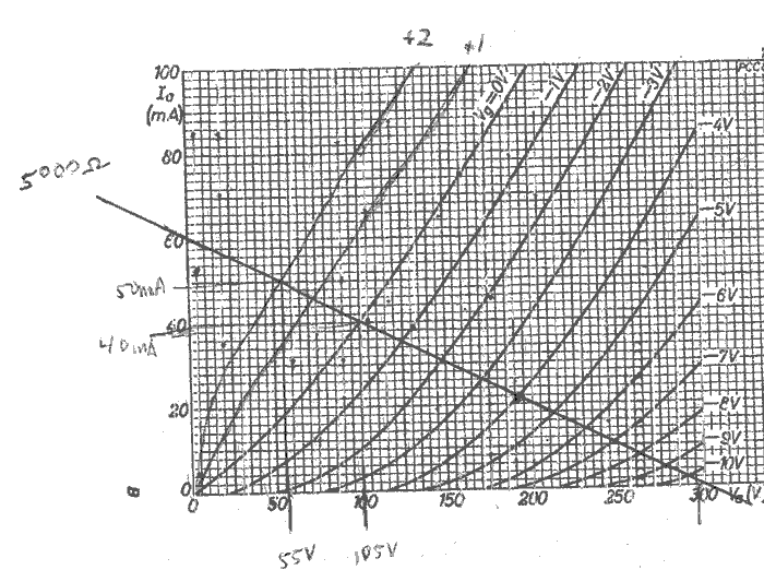

Here's what I mean, graphically:
OK, now i understand the problem and the communication breakdown... my own misunderstanding. its just such an unusal way to describe the action of AB2... one thing needs to be clear: the swing in the terms you describe is not a straight line in AB2. its a bent curve with a distinct "knee", bent to accomodate the extended lessening of plate resistance in AB2 operation. and yes, the closer the plate swing gets to a short circuit, the more power you will develop in the load. if i get a minute, i will try to take a picture of this next week on a scope at work and i'll post it.

Making a triode's anode swing to 0V is difficult; the Vgk = 0V anode curve is usually a long way away from 0V. Forcing the anode to swing to 0V requires that the control grid be driven positive - AB2. Because the anode now swings further, AB2 extracts significantly increased power from a triode. Conversely, a pentode can already swing its anode close to 0V, so AB2 doesn't help much.
SY said:
Only if the tube has low perveance. As EC8010 points out, a high perveance tube will swing the plate close to zero volts anyway, so the power pickup is not large.

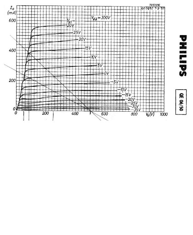

Repeat after me:
CLASS 2 INCREASE PLATE CURRENT.
In pentodes it actually increases the saturation voltage (as Fuling's graph illustrates), but the gain in current offsets that for a very long while (you can keep increasing current, reducing impedance and gaining more power, until the grid melts!).
In most pentodes, screen voltage is indeed increased, making for a good easy-to-drive situation. Sometimes it doesn't have enough perveance even at max. screen voltage, transmitting pentodes for instance, so you may still need grid current to reach full ratings.
Or you can completely blow off all ratings and try getting 500W out of a 6L6 (as Gregggggeek has musingly suggested ... which reminds me, I was going to draw a loadline doing that ...).
