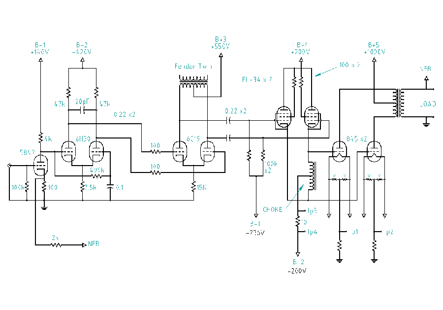

hey all,
merry christmas!
i have a schematic here of a class AB2 845 pp amp i designed that blackie built into an even older 845 class A pp amp i built about 10 years ago. the problem was that the owner changed speakers and started using planar ribbons. he needed alot more power than the 30 watts he got from the class A pp 845s. the maximum supply voltage was only 1000 volts so the only way to really increase the power was to go AB2 or B. to improve the efficiency, in other words. so the driver stage and power supply became a little more complex...! but this amp made 166 watts into 4 ohms @ 5% thd with the same supply as the 30 watt class A amp. that tells you why class AB amps are the commercial norm and not class A. i will find a picture of the amps and post it too...
i had a time converting the autocad file into a GIF (thanks SY!) but it works sort of... if i could have economically increased the main B+ to 1200 -1300 volts, this beast would have easily hit 200 watts. there are only two coupling caps and the inductors are fender twin output trannies without using the secondary and a custom plate choke wound for me by jack eliano. the second owner damaged one of these so he replaced them both with yet another fender replacement trannie, a bassman i think? the output trannie is 5K 200W from jack. i think i remember the -2dB point as being 40 something khz at 150W. anyway, just as an excercise to see if i could do schematics here...
jc

Maybe I should reconsider those cathode followers, mostly because of the potential problems to apply feedback that spans over two transformers.
I DON´T want an amp i this size to be unstable!!
