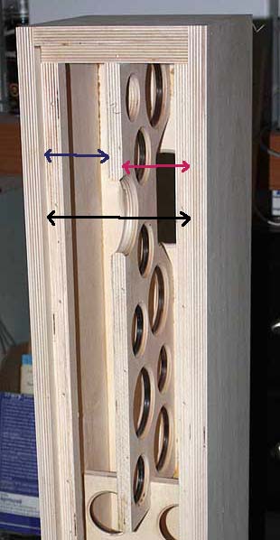

One of the side-effects that come along with the holey brace is that it changes the standing wave structure of the box. Without the brace, you would have 1 standing wave = the length of the black arrow. The brace, with its holes, now distributes the energy across 3 standing waves, black, blue, red. The shorter ones become easier to absorb with the damping material.

Hi dave,
Your bracing is great, but seems complicated to make. They may be made by CNC tooling.
Tony.
A brace dead centre is not very effective at killing the 1st panel mode. As you can see in the sketch, a centrally placed brace clamps the panel at the null of many modes & thius can encourage them.
One of the rules of bracing is: A brace should divide a panel into unequal sub-panels.
In addition to the vertical driver brace, cross-braces are also recommended.
dave
They will have little to no effect on cabinet bracing. They will thou help hold the damping material up.
dave
edit: i see Tony beat me to that last bit
I'm going to disagree with you there (to a minor extent); they should bring a slight benefit as they're near the terminus, where there's a reasonable amount of stress. Very small, no argument, but probably better than nothing; more useful in holding up the damping of course.
Is there an advantage to using the 'hole' bracing as opposed to window type bracing(square or rectangular openings)? It seems like the window type would offer less of an obstruction to air movement and wouldn't affect the cubic footage of the enclosure as much. Of course the openings of the bracings would be rounded over just like the circular openings. Any thoughts?
Depends how much meat you leave. The circle does leave a stronger brace (it follows after "the arch"). The orientation of the brace is important. These braces are vertical which do not impede air flow (any side to side is a bonus as illustrated in post #144).
