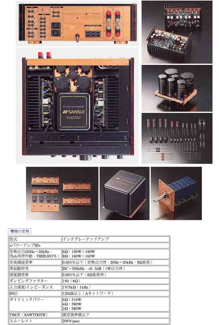

Equally, we played both 10.2 and 12's on my beloved vintage (1990) Sansui AU-a907DR. Weighing in at nearly 34Kg (phew) with its monster "Silent Weave" transformers, 10.2's and 12's like their lips when they see this amp being connected. I only paid a couple of hundred bucks for this amp, buying it in Tokyo, it cost almost as much to ship it to Hong Kong because of the weight.
SANSUI ƒvƒŠƒ�ƒCƒ“ƒAƒ“ƒvAU-ƒ¿907DR‚ÌŽd—l ƒTƒ“ƒXƒC

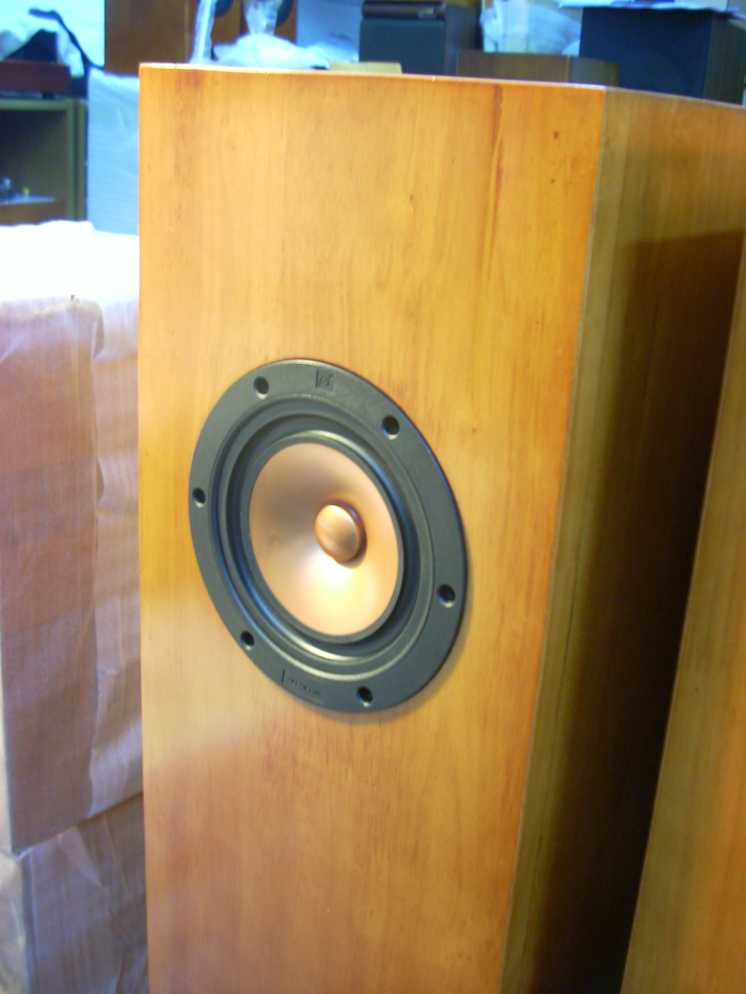

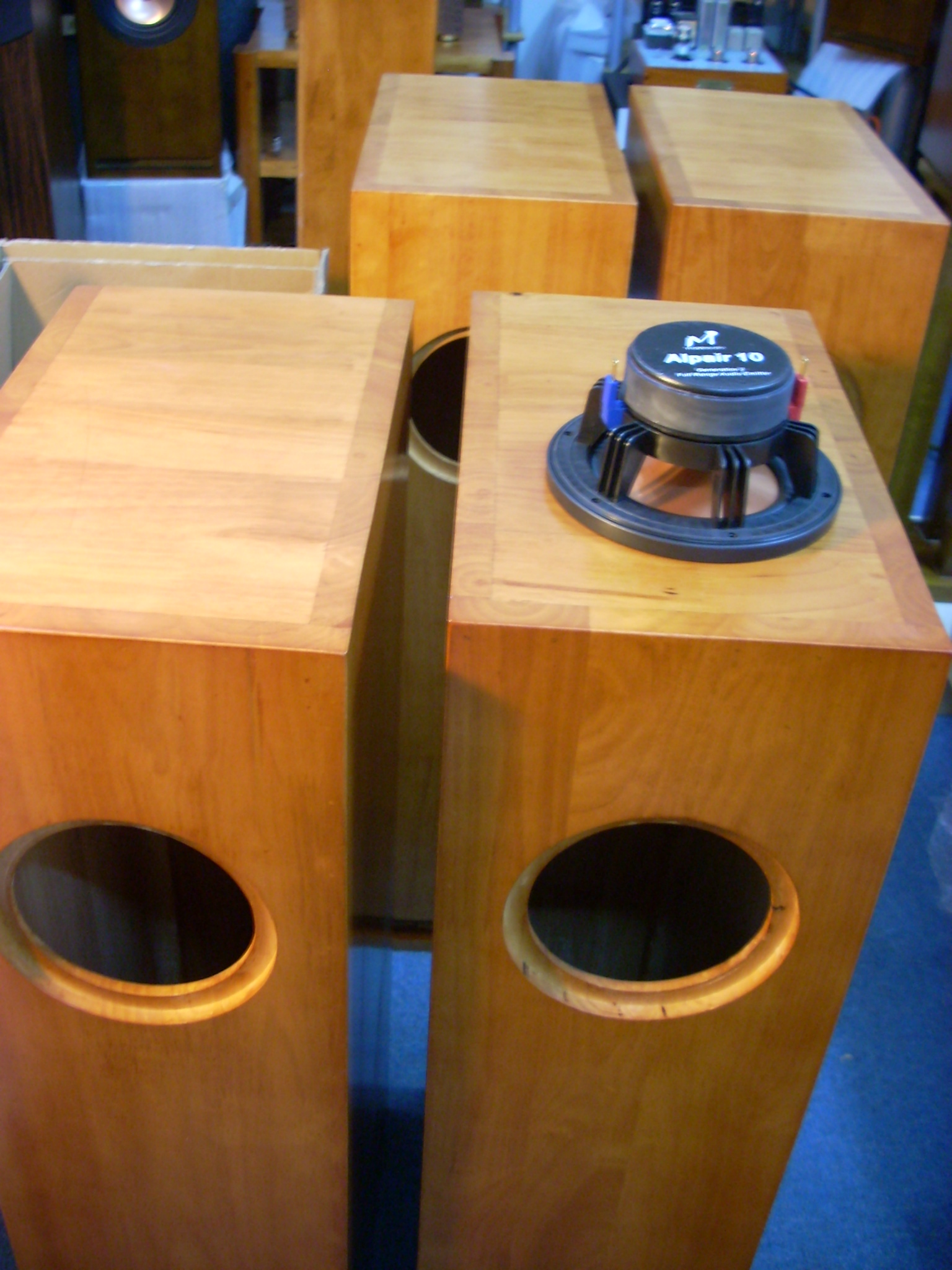

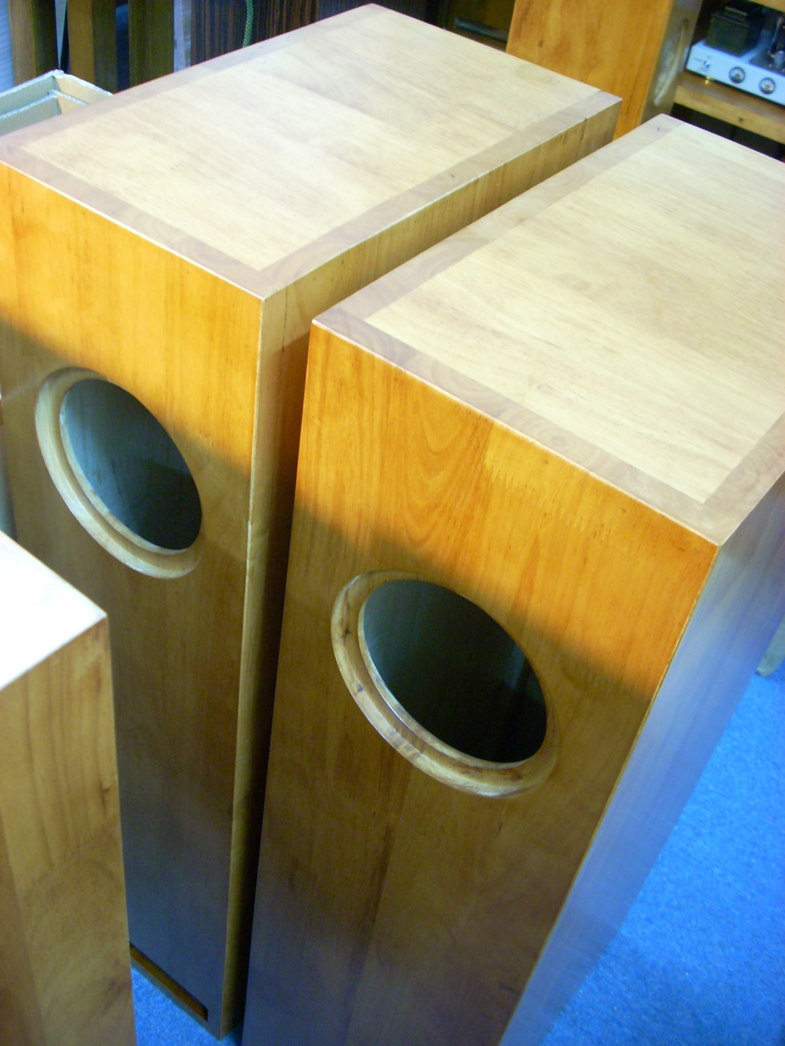

The new design of Pensil 10.2 cabinet is much deeper than the old Pensil 10's cabinet as Alpair 10.2 pushes more air than Alpair 10.
The dimension of my Pensil 10.2 cabinet is 243Wx411Dx942Hmm.

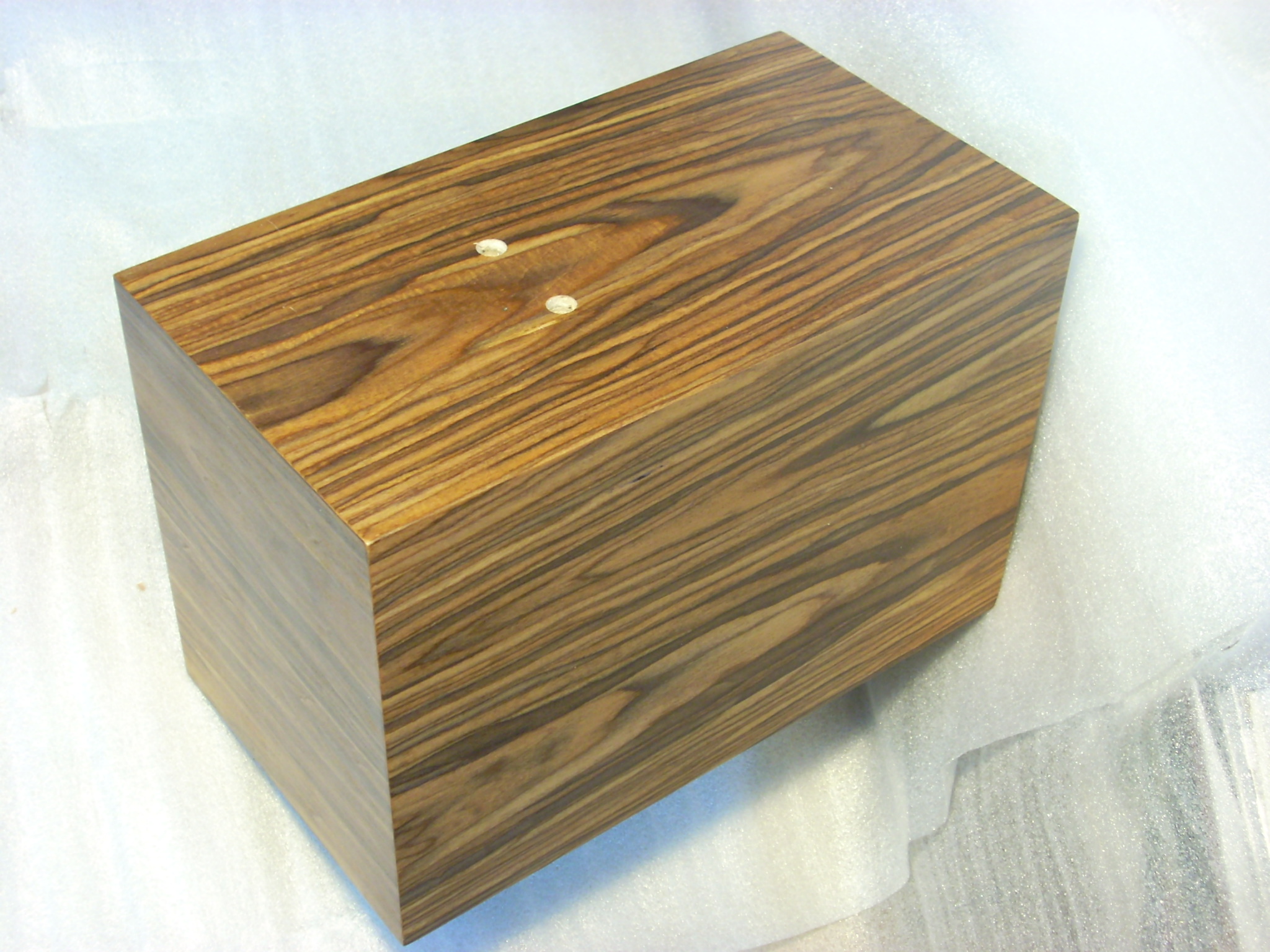

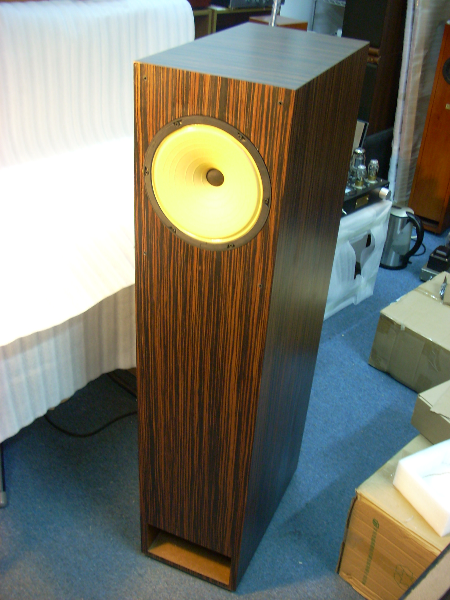

This is a China made 8-inch paper cone full range driver, using a big TQWT cabinet. It is a high efficient full range driver at 95 dB. On listening and comparing this driver with Mark Pensil 12, Pensil 12 can achieve more balanced sound and deeper bass. There is no enough low range for this 8-inch driver. It is MDF cabinet with ebony veneer.
What's that speaker in the background with the Ebony wood and the grill?
