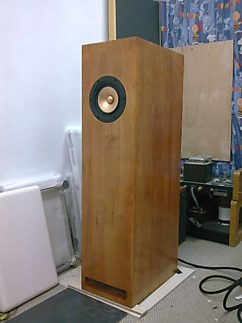

My cabinets are not from SAC. May stick the ebony veneer from a same source. I like the textures of this black wood much more than this.
Wow! Simply stunning! I wish I could do work like that ...

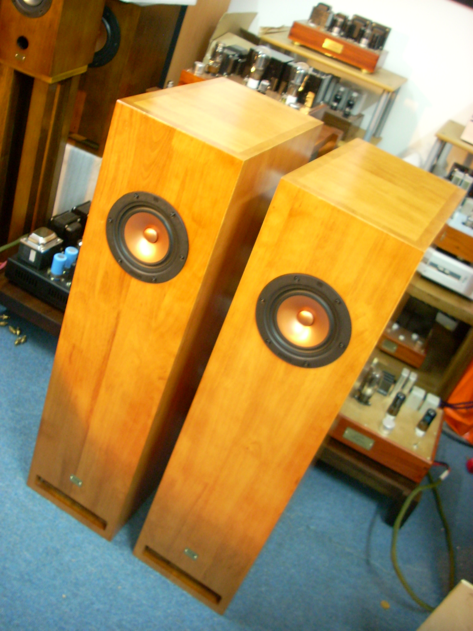

Eagerly awaiting your (further) listening impressions!This is Pensil 10.2 (oakwood cabinets) at Kenneth's place.
I'm uncertain which enclosures to use for my 10.2's, probably Dave's "Fonken-prime"-- (maybe that should be "Monken - Prime!)
The Pencils are also attractive, maybe both!
Best, Don

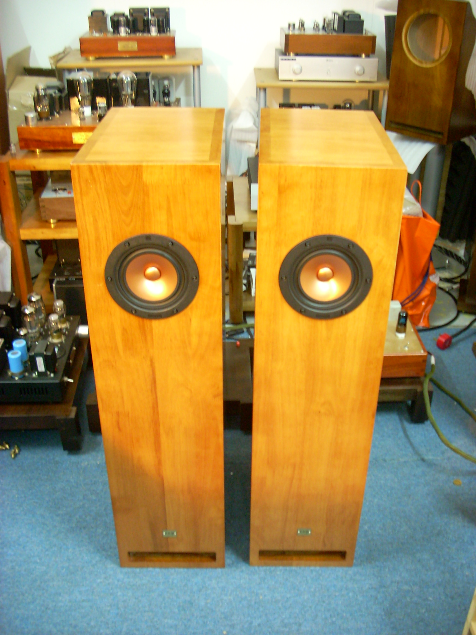

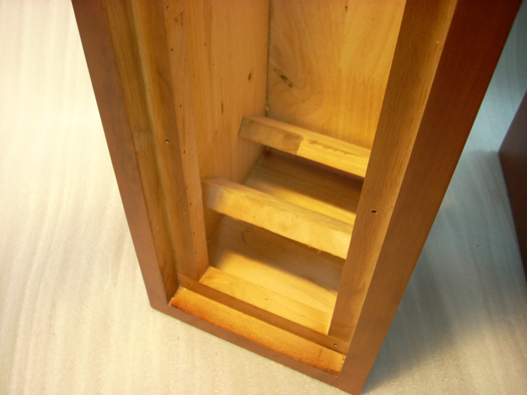

A new pair Pensil 10.2 finished yesterday. It took me 5-6 hours for assembly and installation. Great style and nice looking for the finished Pensil 10.2. I love them. Thanks for the efforts made by Mark and Scott on Alpair 10.2 full range driver and Pensil 10.2 cabinet.
Cheers!
Tony.

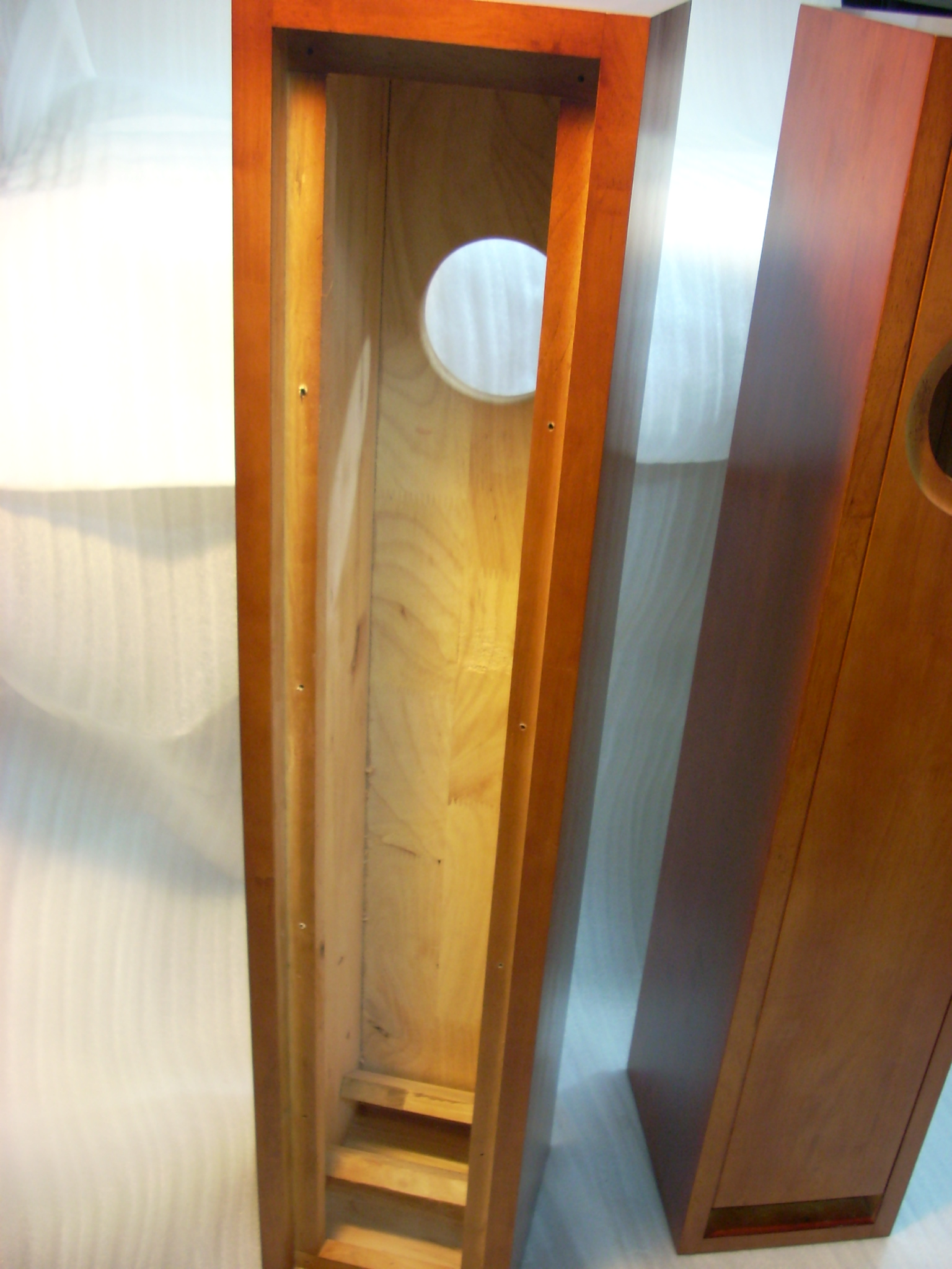

Beautiful work. Are those bottom braces a new addtion to the plans? Perhaps a more practical alternative to cabinet bracing than the super pensil type of bracing? Or do they possibly shape the sound of the cabinet? Just curious. 🙂

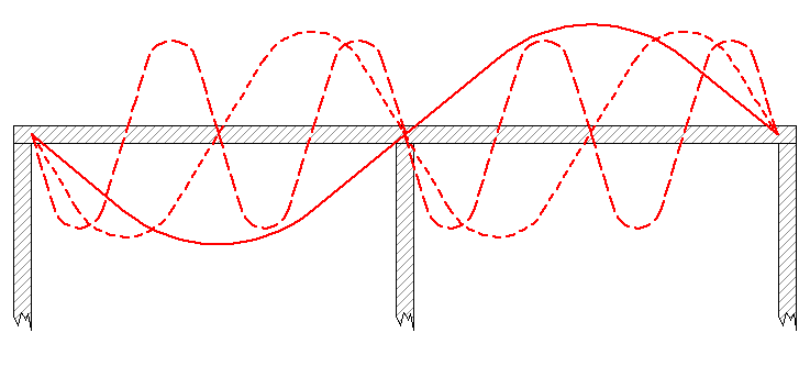

Oh I see. Thanks Scott. I have a possibly dumb question. In many box plans, including the super pensil, it seems as if the verticle bracing behind the speaker isn't centered. Is there a reason why it's offset to one side rahter than smack dab in the middle of the driver? I'm guessing for motor ventillation (if it has a center vent) but I could be wrong.

Thanks, Steven,
The bottom braces are the function which stops damping material inside Pensil cabinet dropping down to bottom and block vent. All of my Pensil series cabinets are made this bottom braces. See my Pensil 7 cabients.
They're not as effective
They will have little to no effect on cabinet bracing. They will thou help hold the damping material up.
Thanks,
Steven

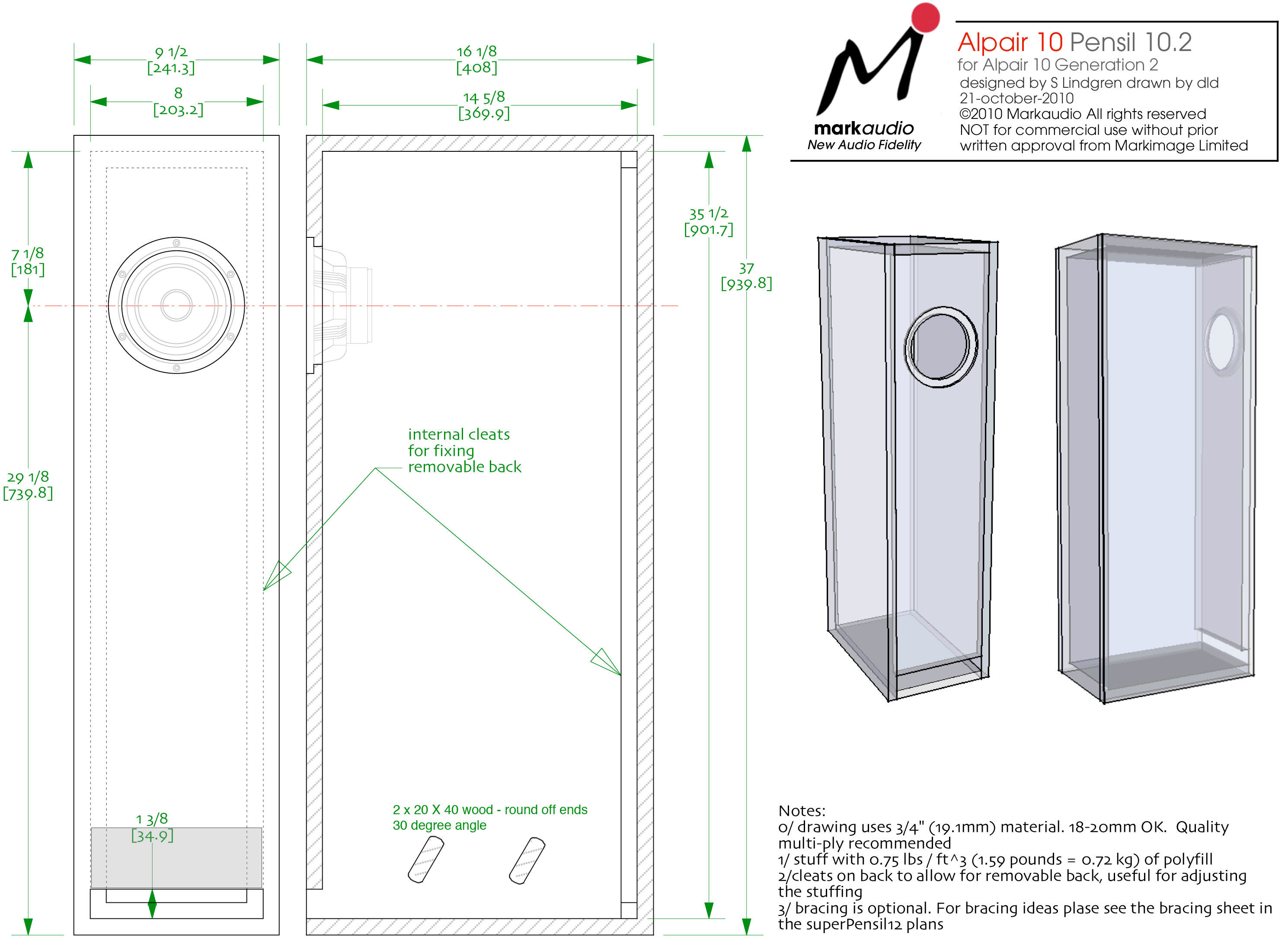

actually to distribute resonances of unbraced panels to (ranges of) multiple frequencies at lower amplitudes
A brace dead centre is not very effective at killing the 1st panel mode. As you can see in the sketch, a centrally placed brace clamps the panel at the null of many modes & thius can encourage them.
One of the rules of bracing is: A brace should divide a panel into unequal sub-panels.
In addition to the vertical driver brace, cross-braces are also recommended.
dave
