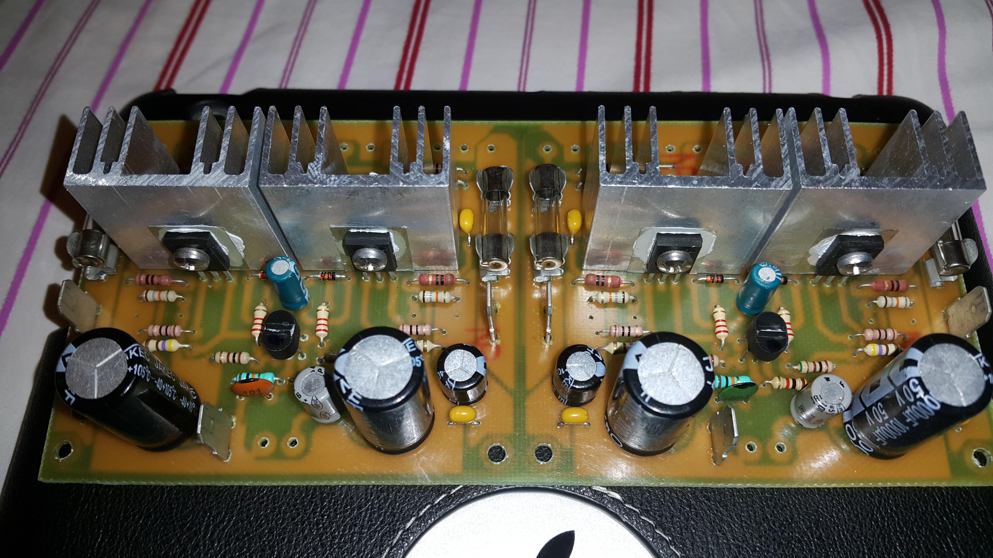

i find problem with board. oscillation solve with regrounding
but another problem find. when speaker connected, rca not connected then re-plug in rca while signal present, the circuit burn!! :-O
the v+ wire from psu to amp module burn off. the psu mr.evil cap multiplier.
sorry, english bad. so maybe i re-explain. amp on, speaker connected, rca not connected. then i correct rca. amp v+ wire burn.
other hand, speaker not connected, rca plug out, back in, no issue.
Do you have Zobel at its output? If not then try installing one and see.
Also, never run the amp without fuses on both PS rails. It's more about your own safety than the amp's.

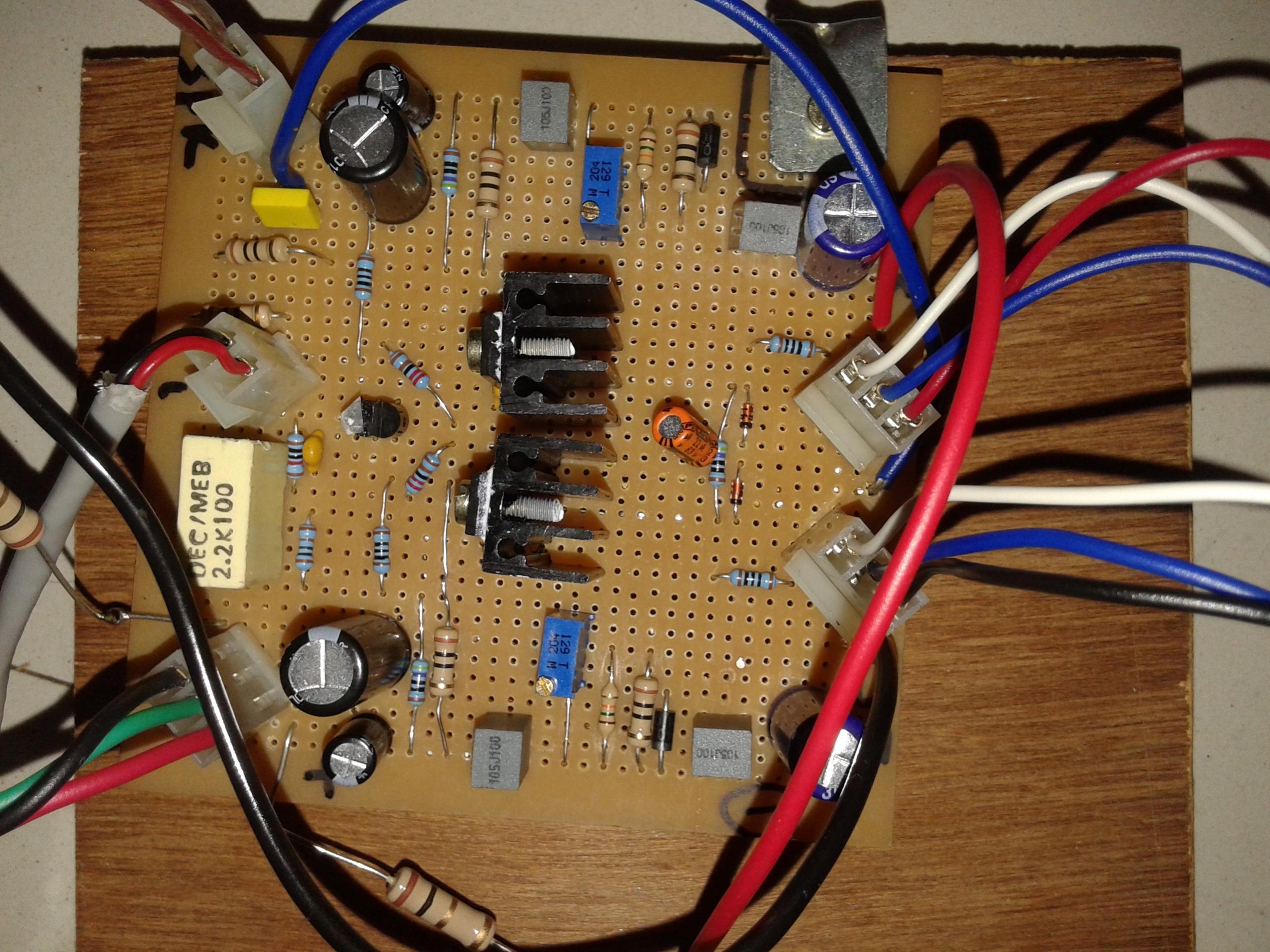

Hello Shaan, and fellow diy'ers. I finally got around to complete my first perfboard PeeCeeBee and is currently playing some music. I have 3 more boards to complete for my bi-amped setup.
I could get the offset to 0 mV, with the following bias settings:
IQ: 96 mA
VAS bias: 11 mA
FE bias: 1.54 mA
After my initial adjustment last night, the VAS and FE bias currents seem to have reduced by 20% today.
Can I keep the settings as they are now? The challenge will be to attain the same settings on the next board.
The sound seems rich and detailed in my preliminary hearing on an old Bose 201 test speaker.
Thanks Shaan, LC, and gang to help me build and enjoy my first discrete amp.

Hi bro! Congrats and bravo!
The bias is okay. You can set the same set of bias on your next boards same way with the potentiometers easily. Just start with max resistance.
If you plan to keep the FETs off board then place another pair of 100R at the gates for best stability.
Keep up the good work.
