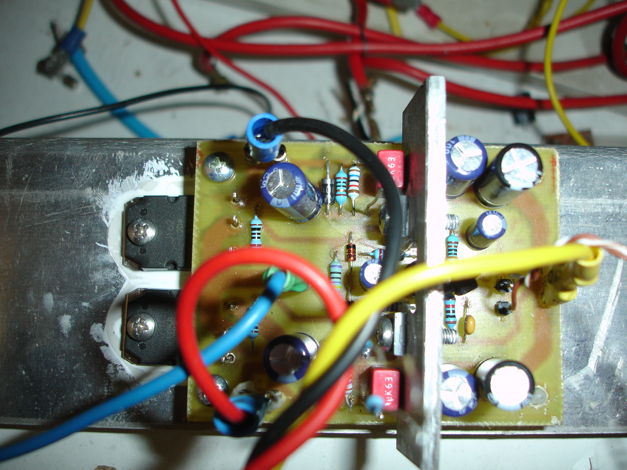

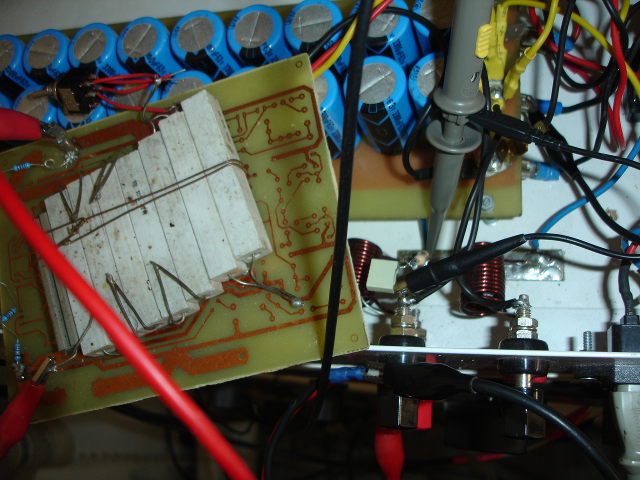

My own failure,sorry Andrej,sorry Gabor.
edit- The circuit design credit goes to Gabor and Andrej. I just shared my board layout of it.

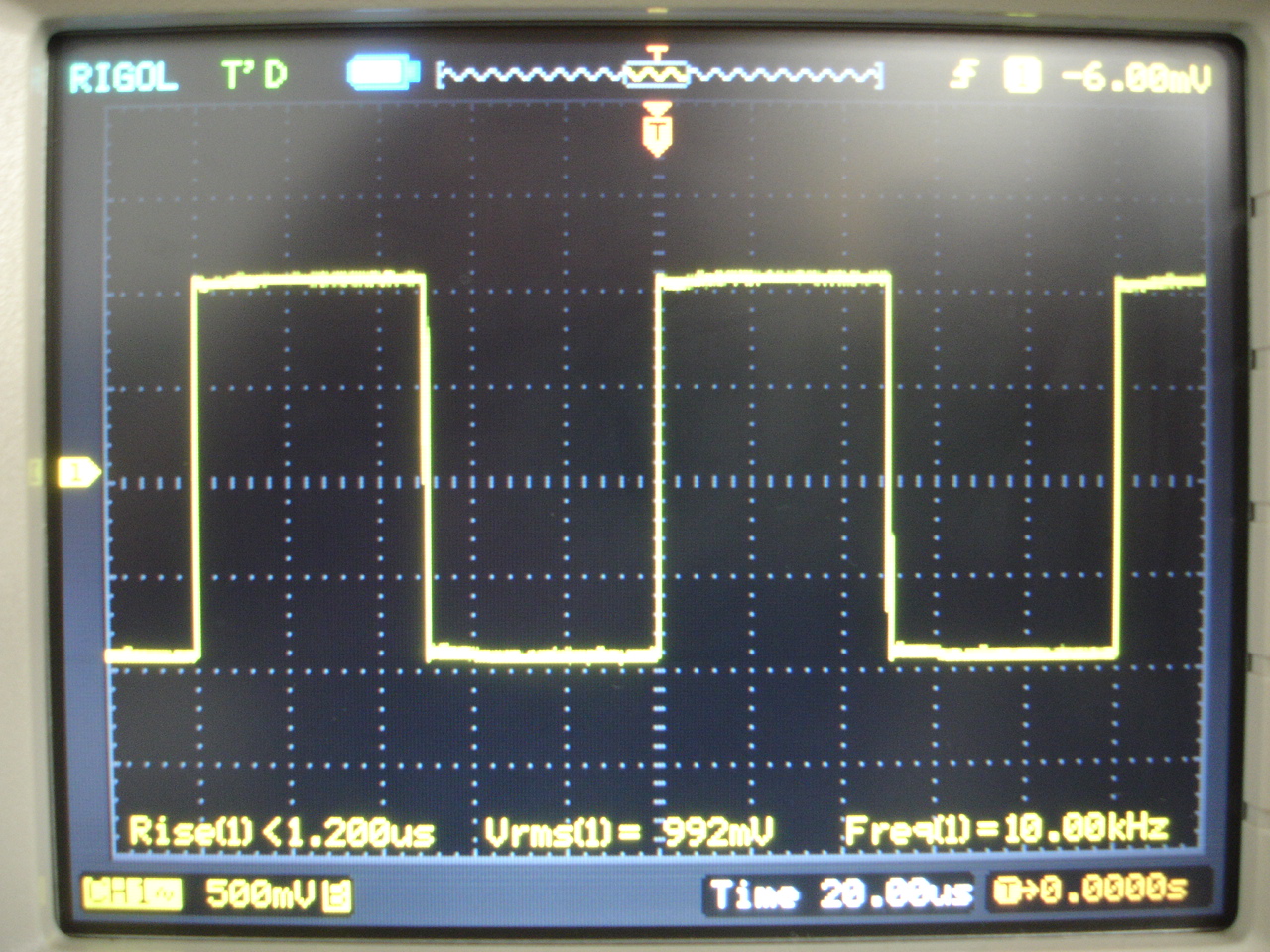

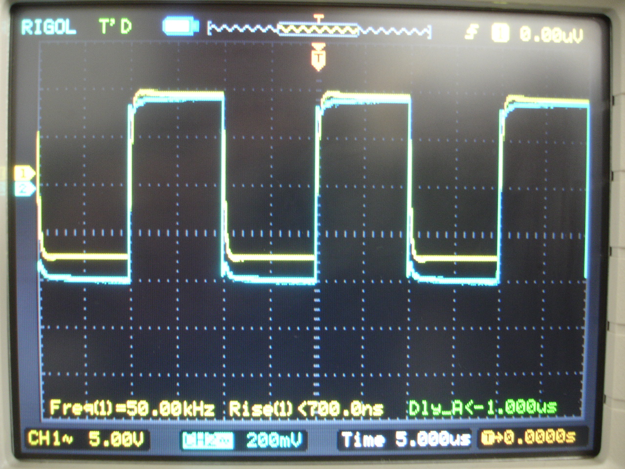

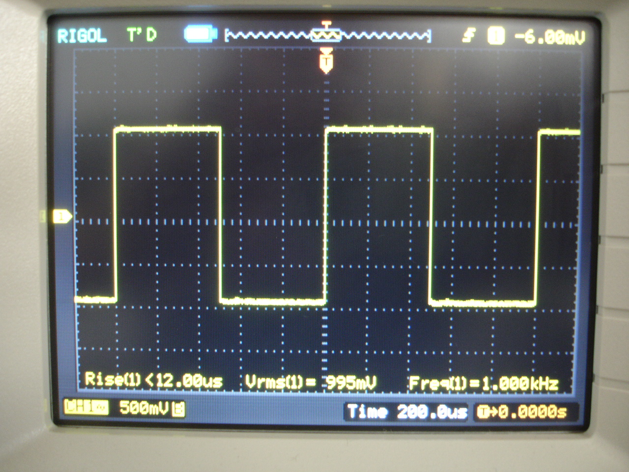

It does not oscillate with squarewave output in capacitive load, as thimios' plots indicate. I am using the same boards with same components and no compensation in my main system and sub amplifier for over a year and half and so far they have shown no ill behavior. If you use Zobel at output then this thing can drive any loudspeaker effortlessly. Of course you must not omit 100pF at input, otherwise it will try to amplify 500KHz RF signal too and zobel resistor will catch fire and you will hear sounds from random radio stations. 😀

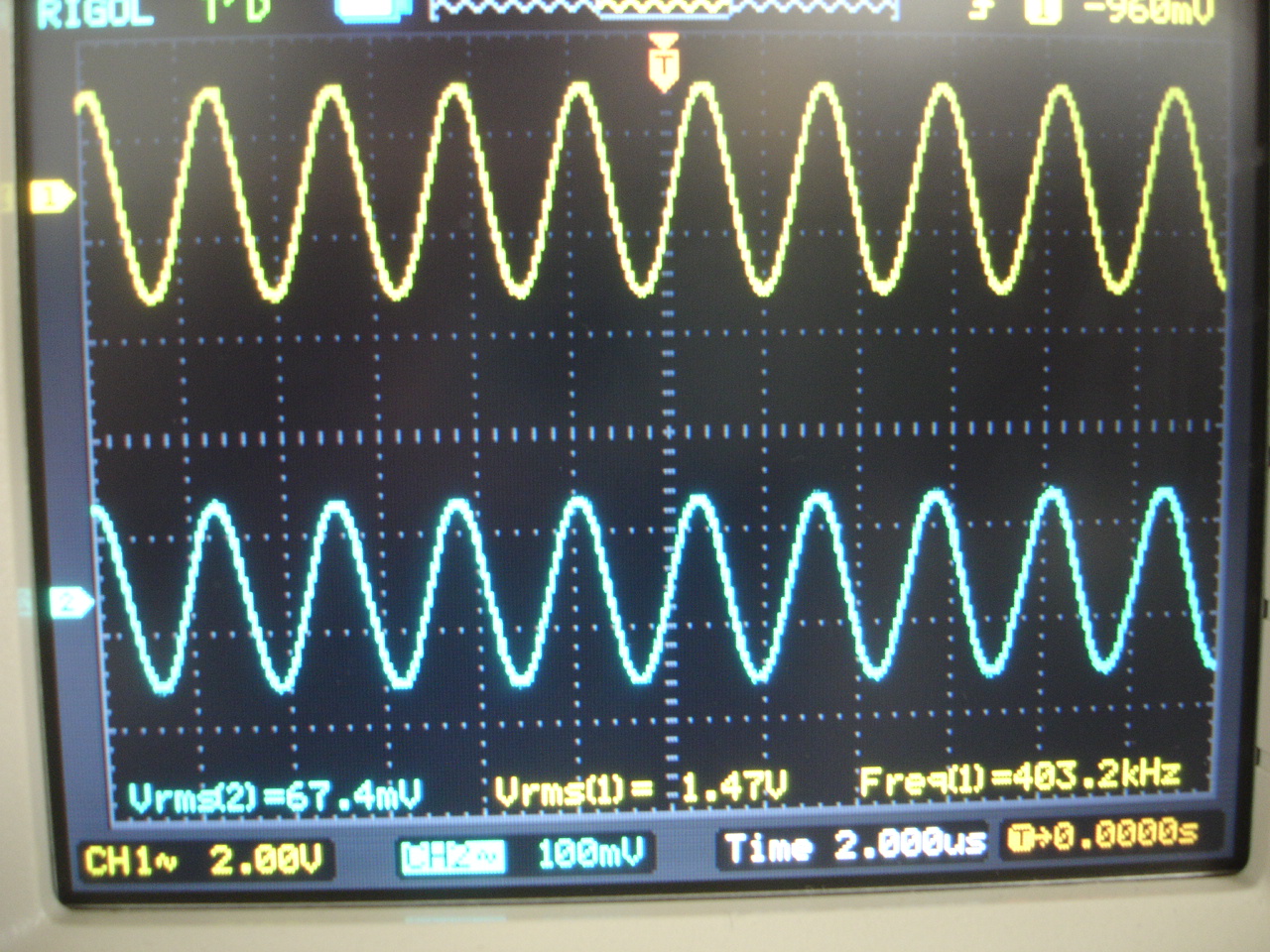

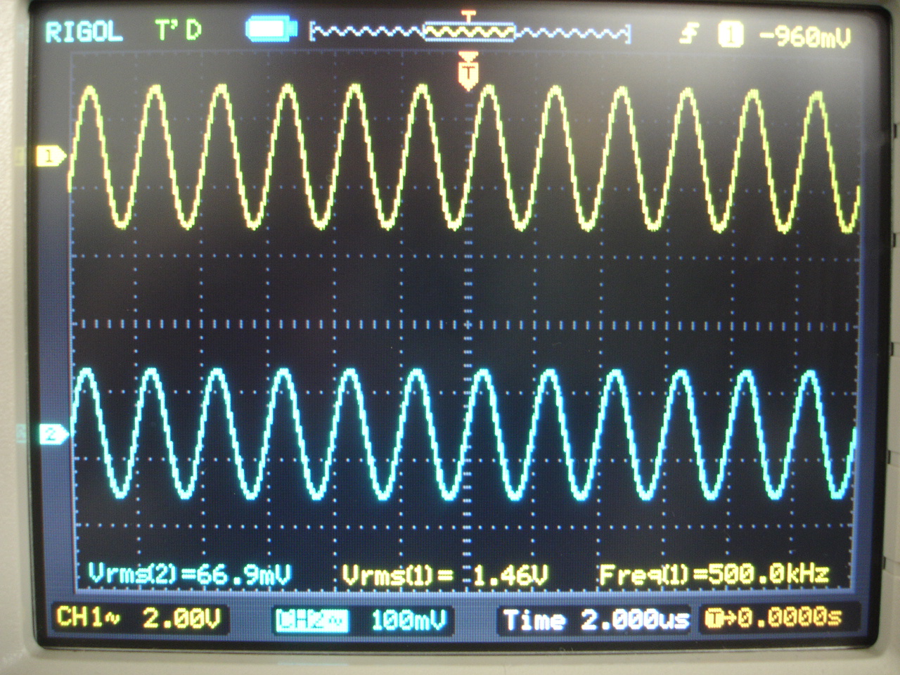

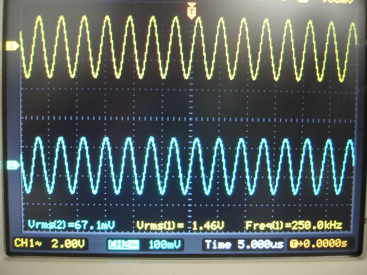

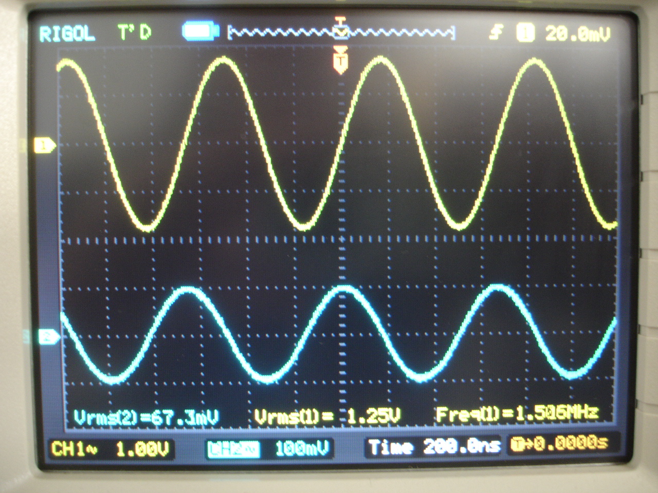

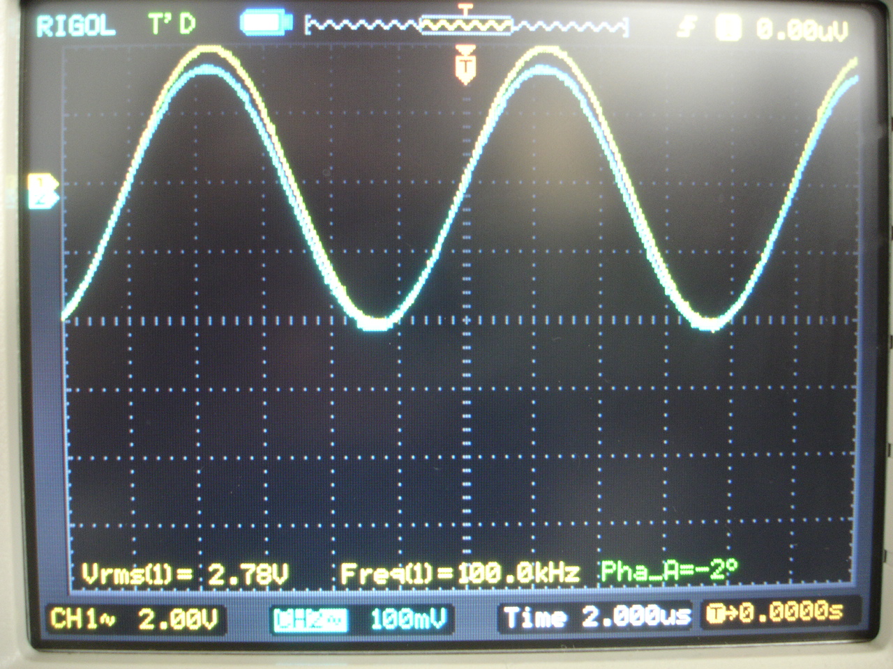

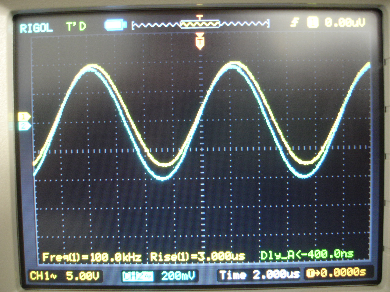

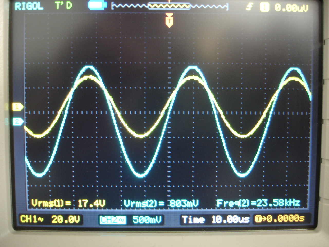

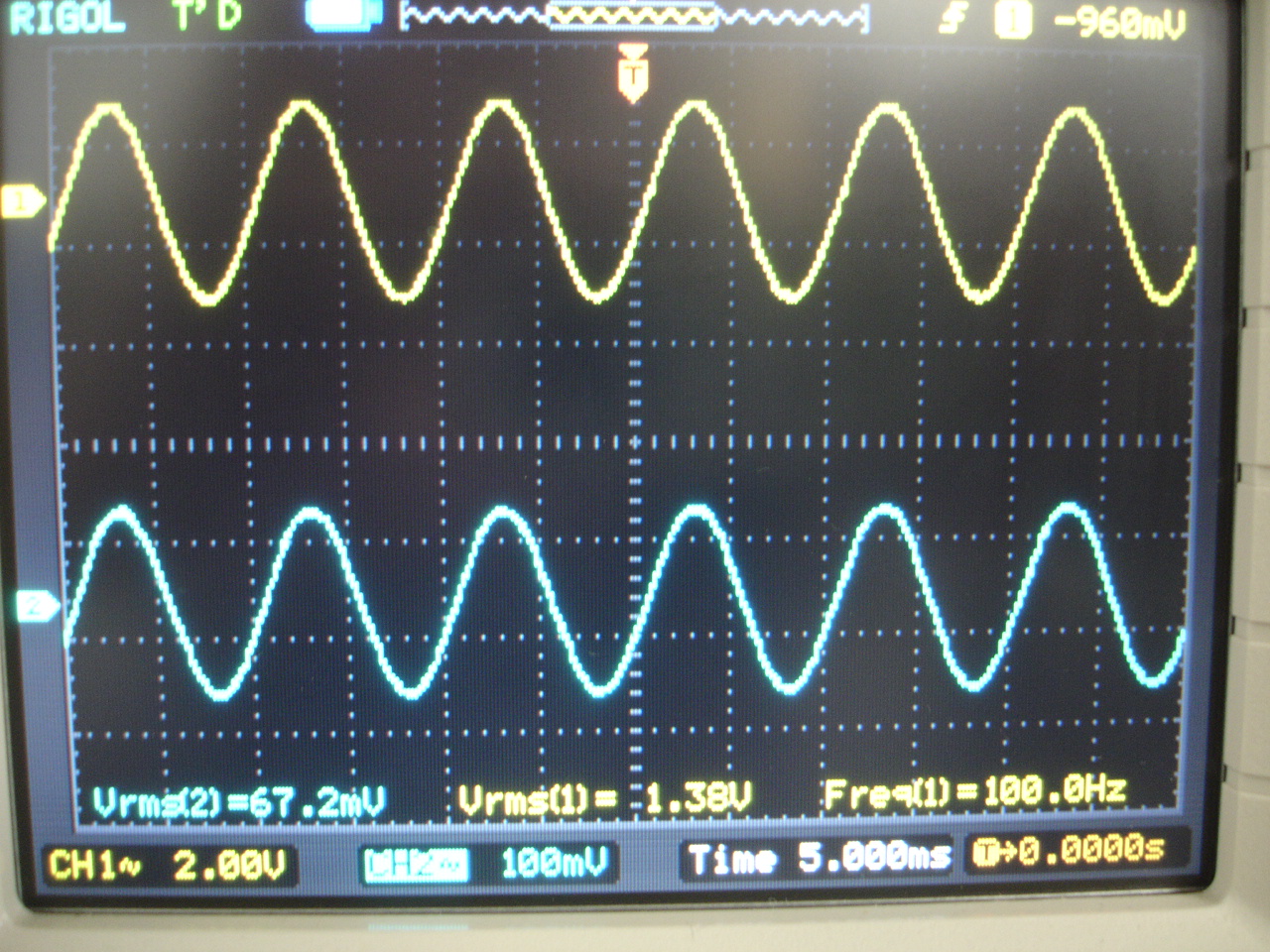

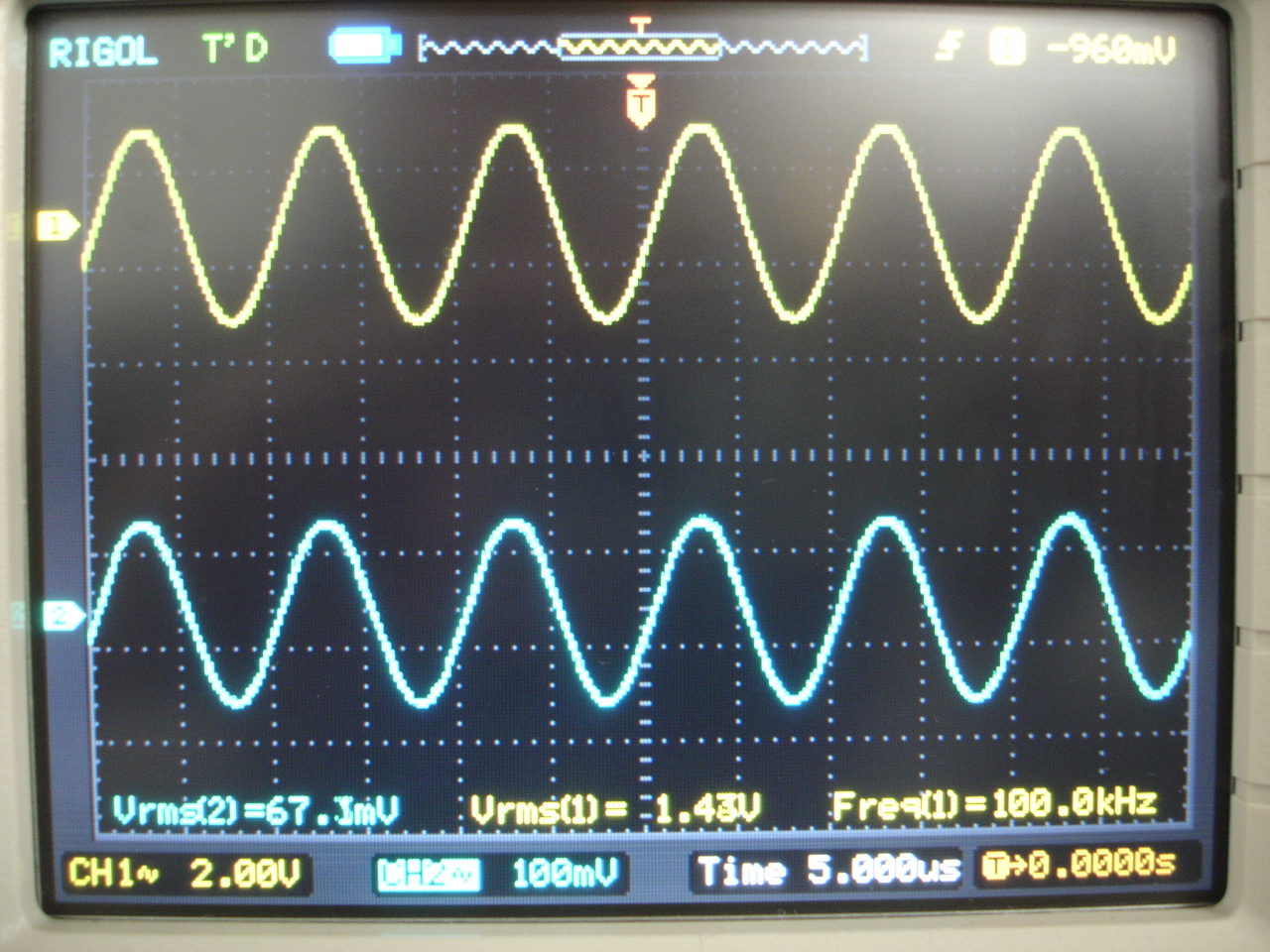

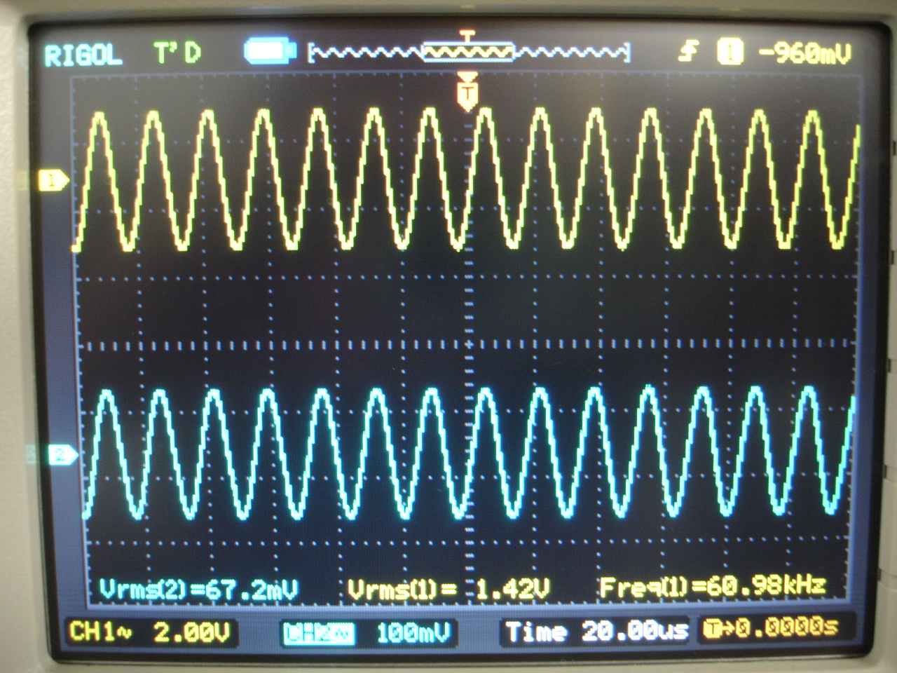

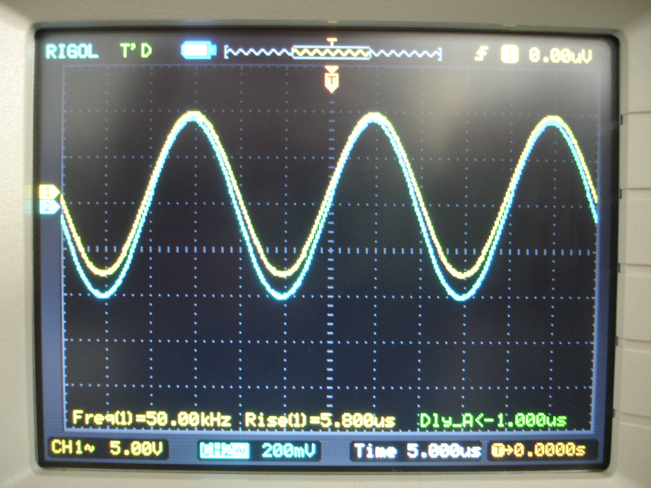

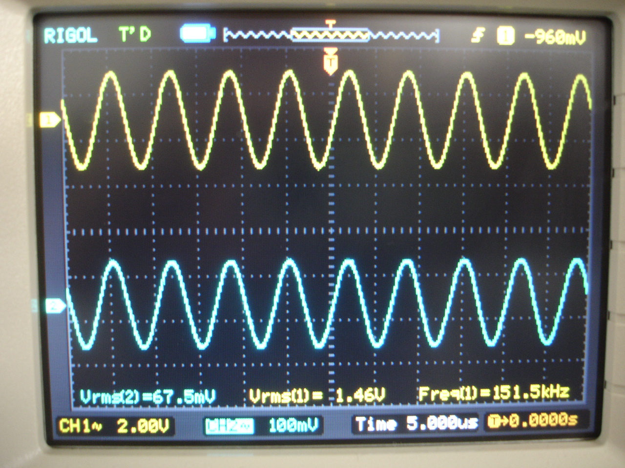

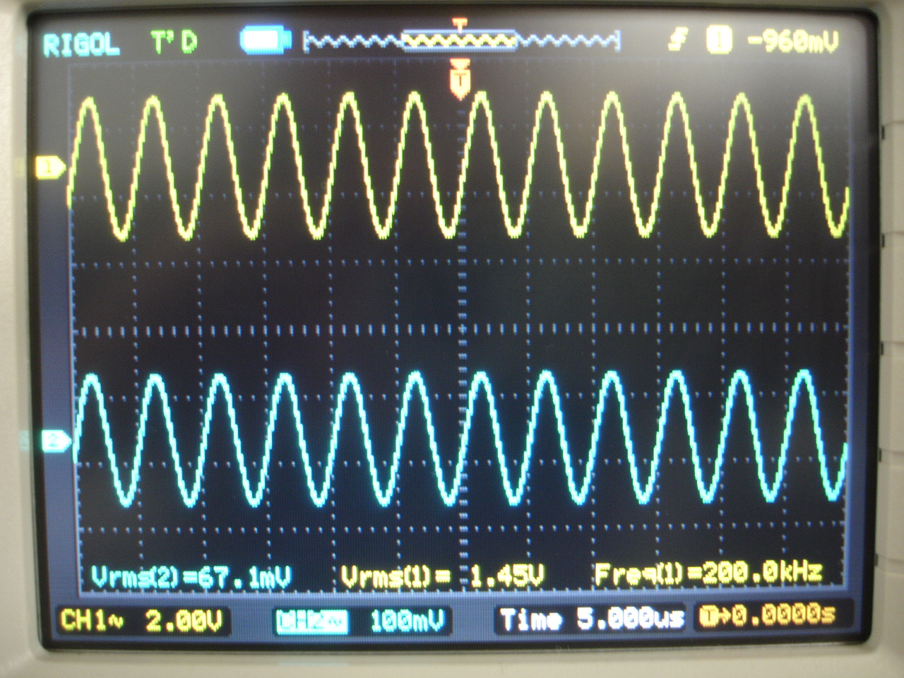

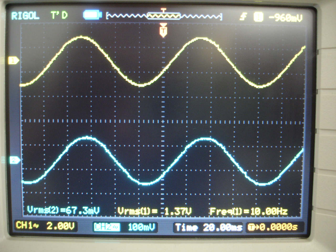

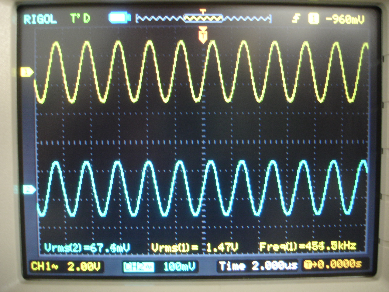

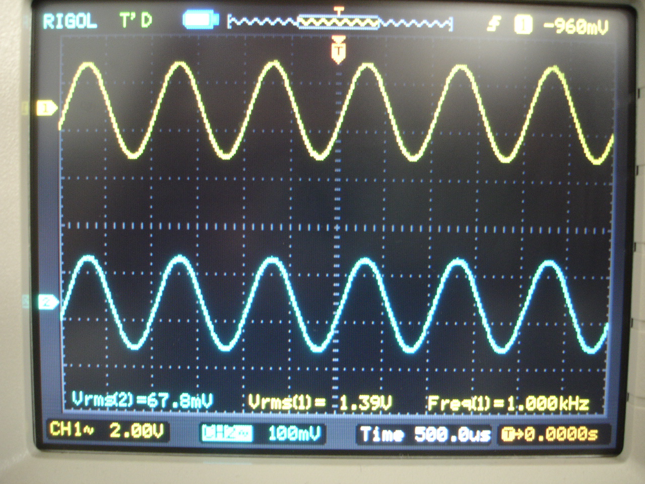

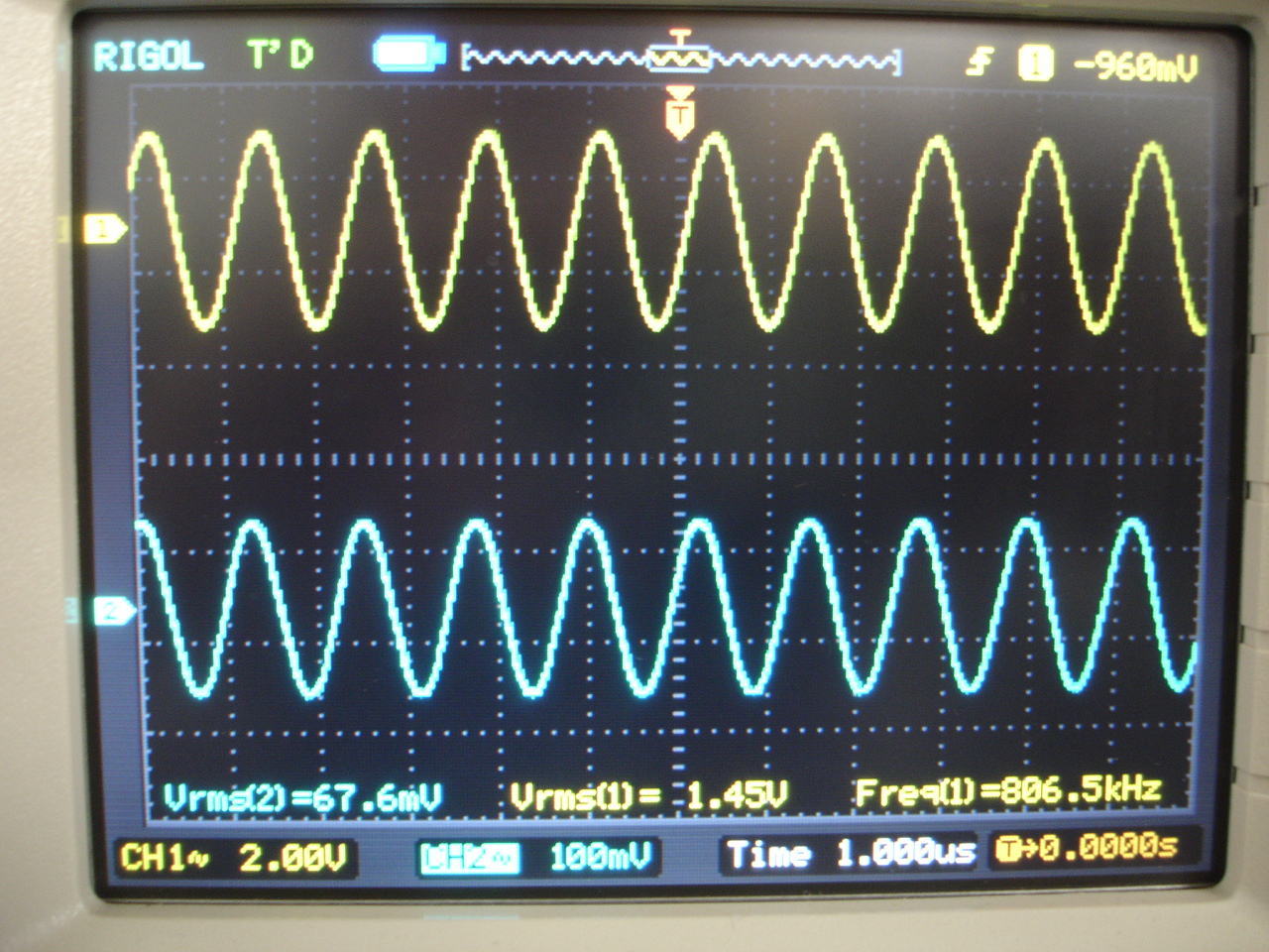

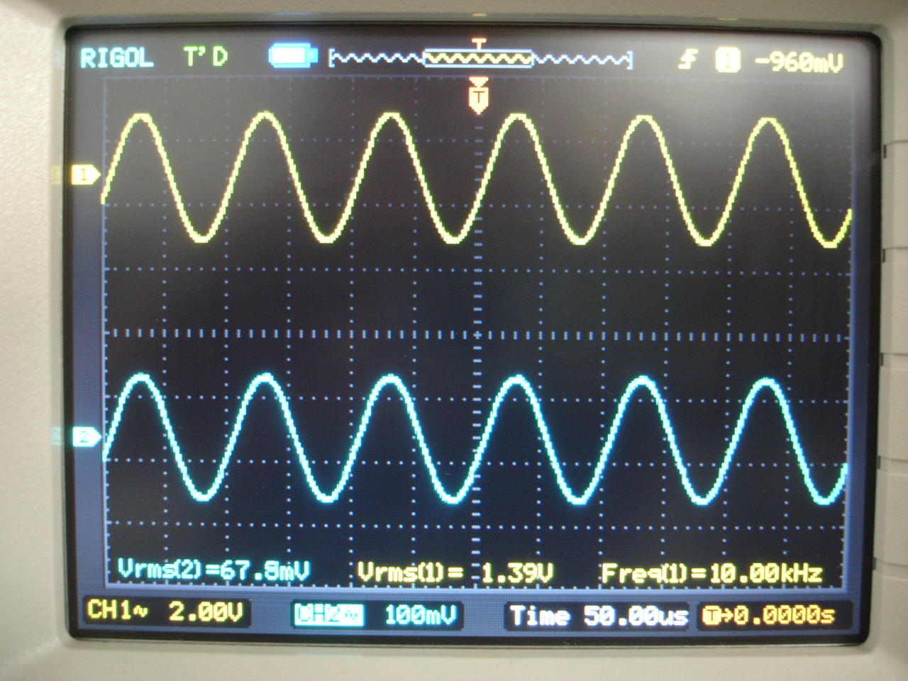

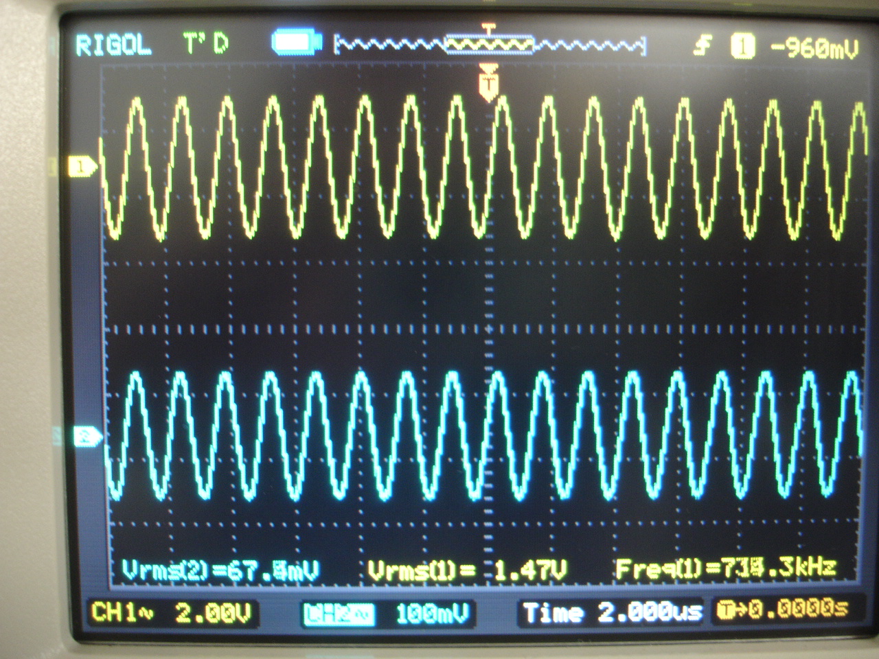

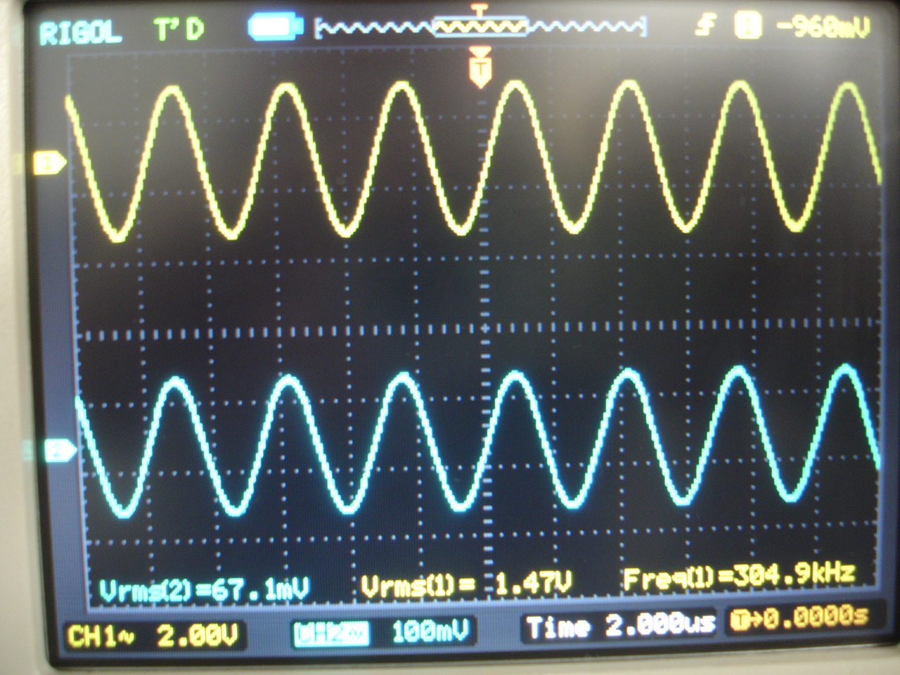

Now again on test procedure.
First testing on a real 3way speaker.
+/-32V
43.000uf/rail
offset=0mv(2M2//16K)
I rail=120mA
Rspeaker=8R

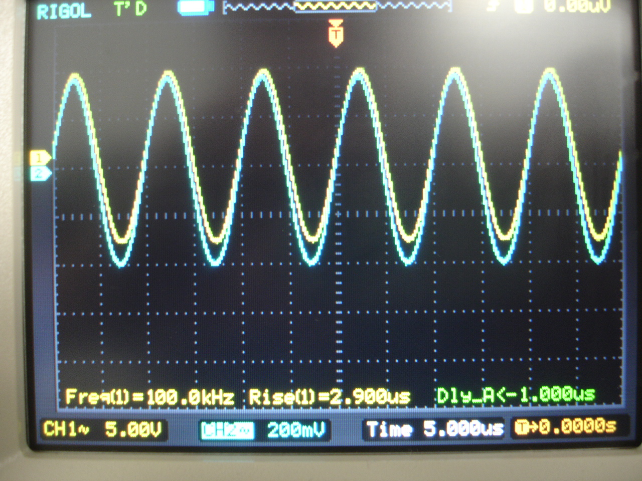

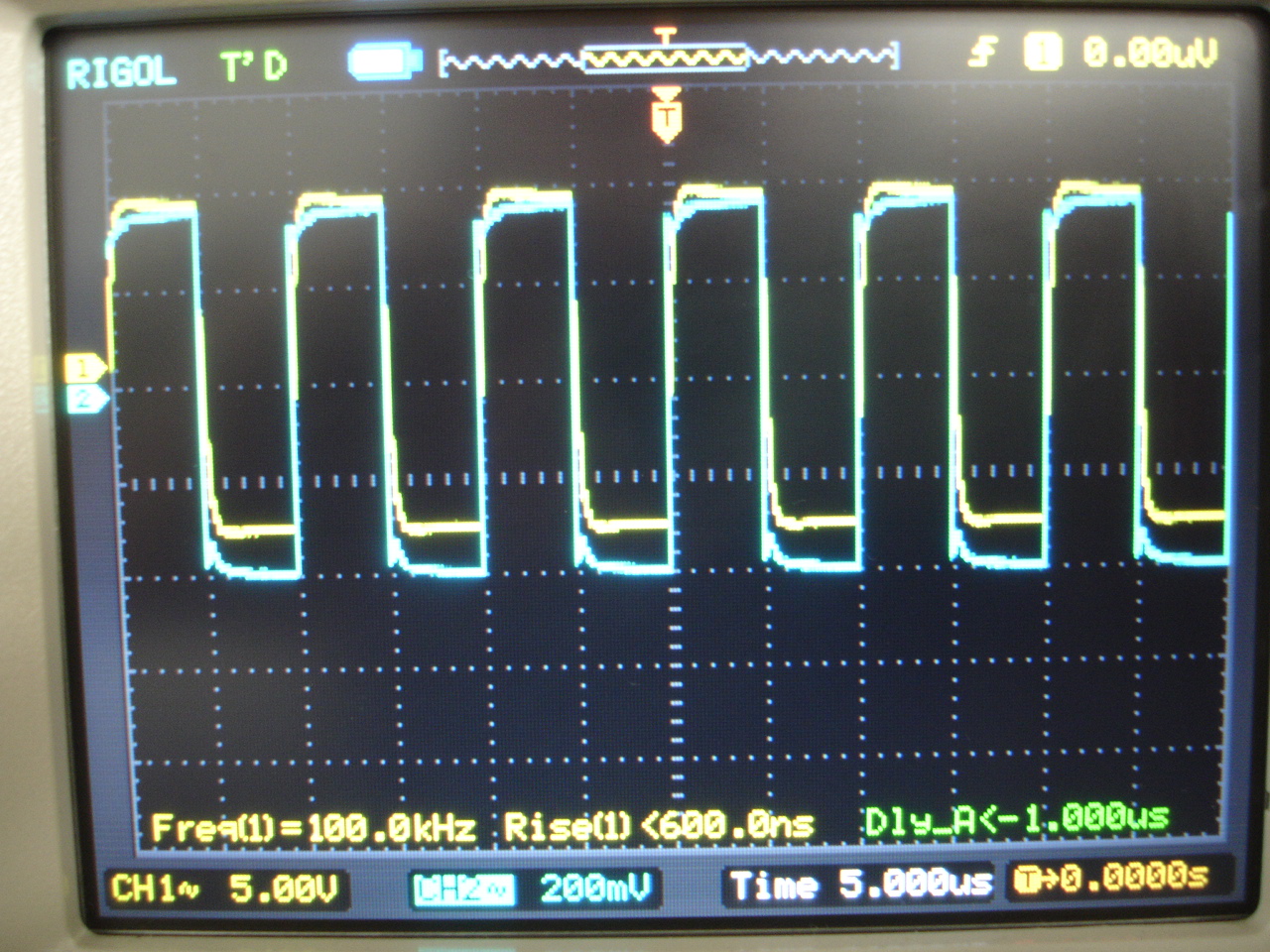

Peeceebee

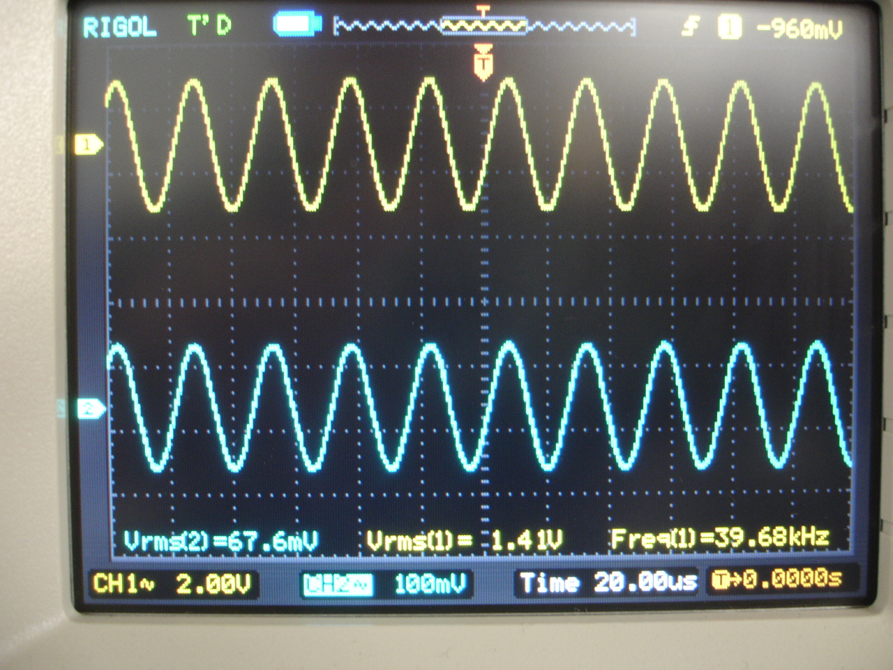

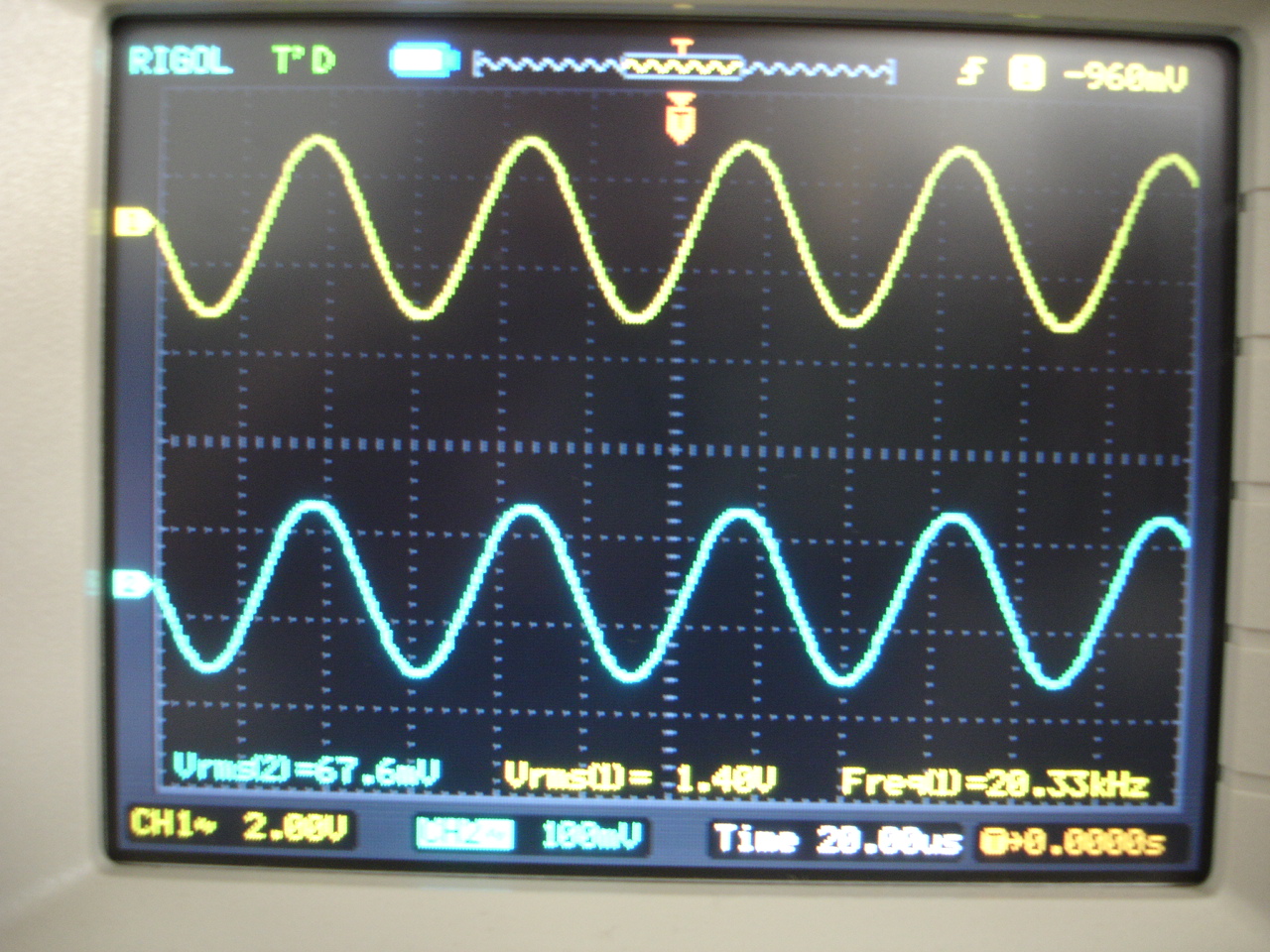

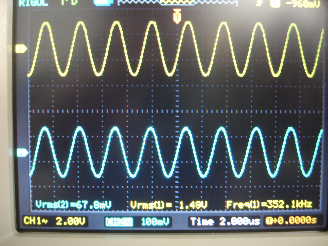

A bandwidth test on a dummy load=6R
Yellow wave is out signal
blue wave is input signal.

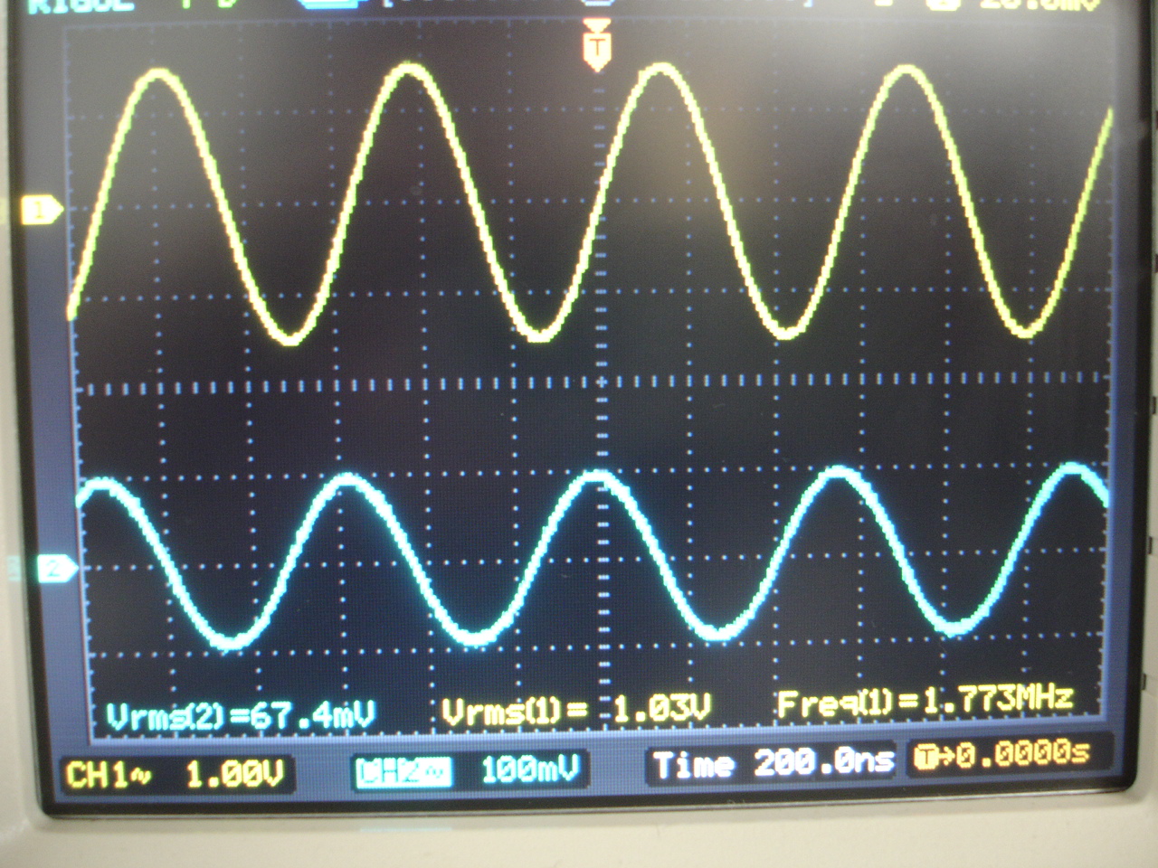

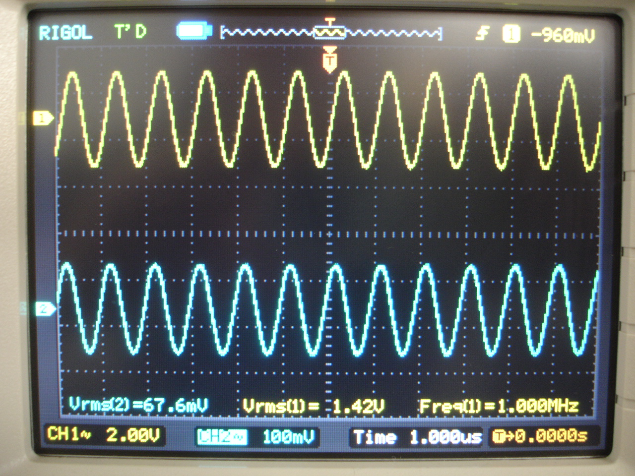

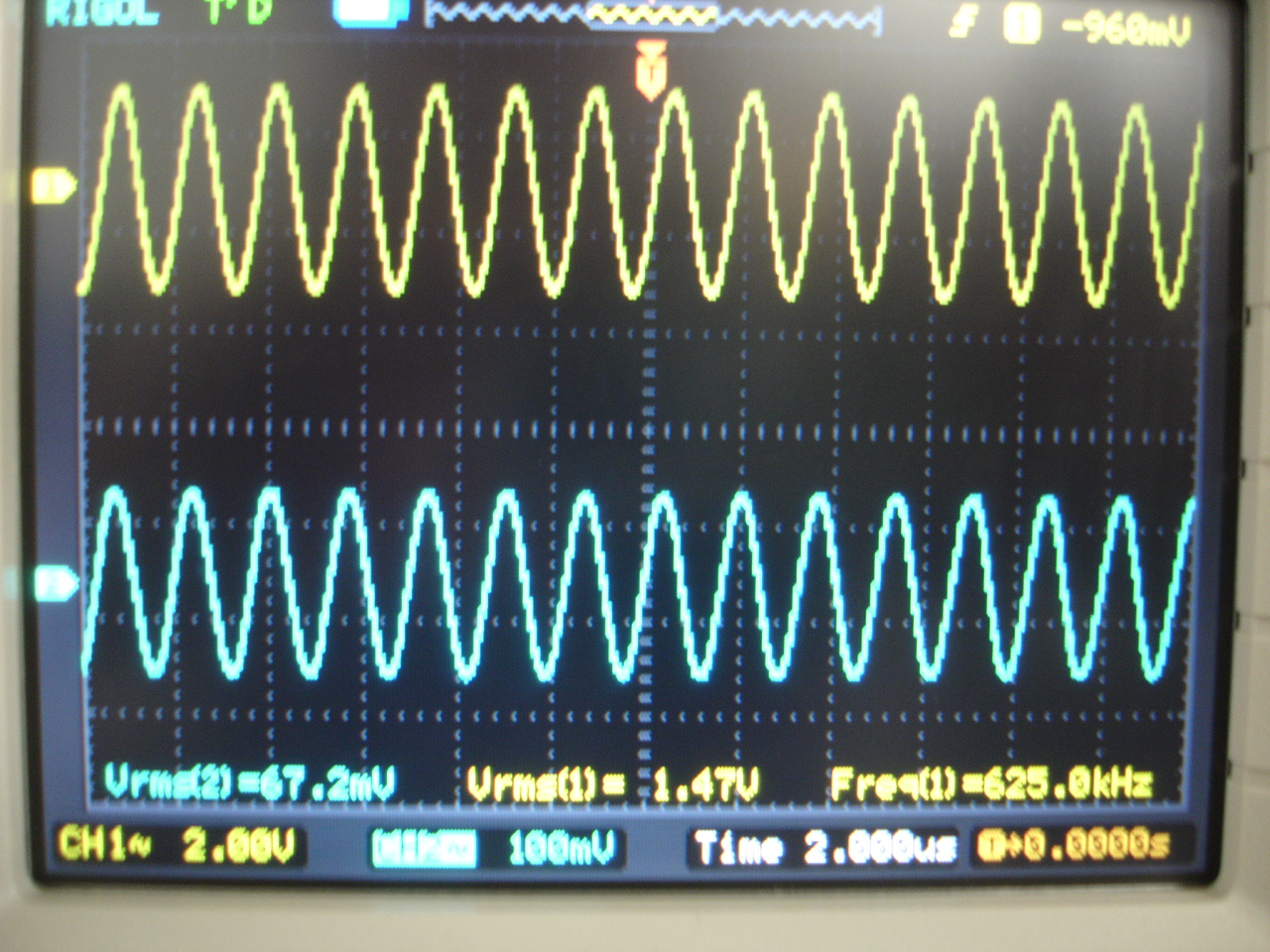

The rest

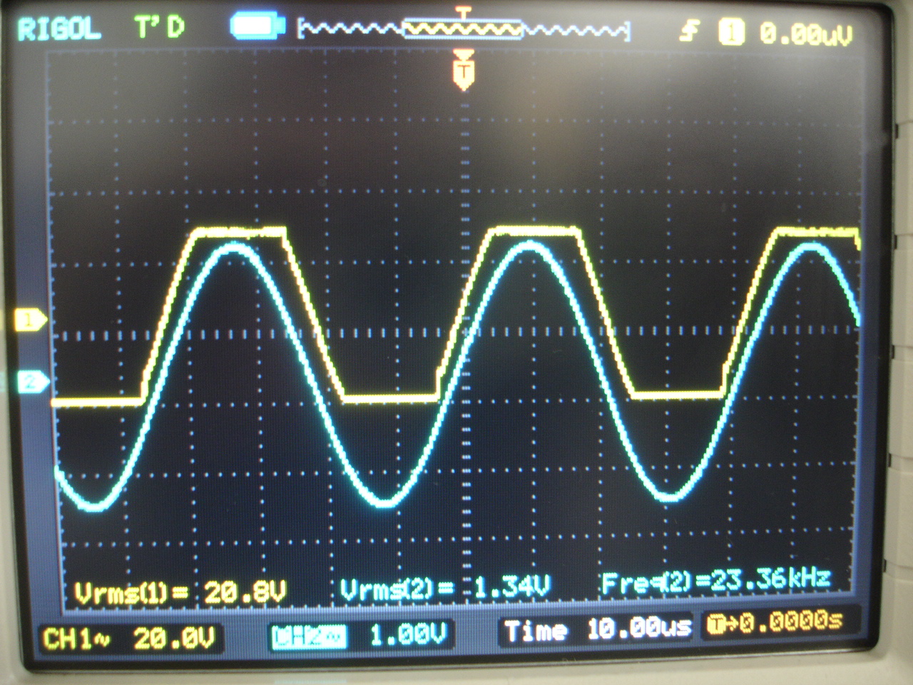

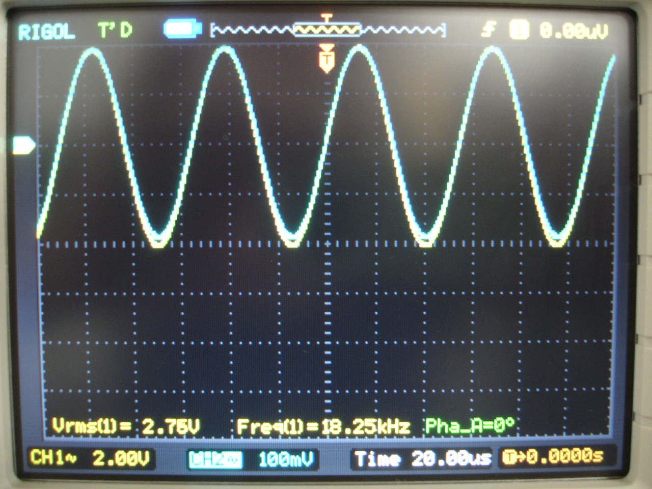

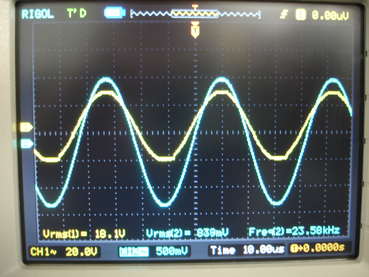

photo maximum unclipping level, last photo a step after clipping level.

Shaan, not necessary the best idea.Seems my choice of 2K2/100R over 1K/47R is justified. No additional compensation necessary to successfully build a stable and working PeeCeeBee.
It is traditional to use the feedback impedance to set the bandwidth of a Current feedback OPA. (In conjunction with the input transistors emiters parasitic capacitances).
But, remember, this capacitance is *not* linear. Means this has an impact on HD.
Hi Esperado.
Yes, not necessarily the best thing to do, as we always used to think(myself included).
However, as you can see the amp is stable without it(comp cap, that might be a must if 1k 47r is used) and the intrinsic capacitance being a few pF is not a concern at the audible frequency range.
My choice of 2K2/100R is based on the idea of limiting the GBW before HF phase lag becomes a concern. So far this config seems to serve its purpose well in this amp, i.e. a stable amplifier that can drive reactive loads well.
'High quality', 'high definition', etc. are more the effects of the bandwidth, sensitivity and distortion performance of the speaker drivers and that can vary from system to system.
Me and a few others here has found out the comp cap unnecessary to build the amp. This indicates that this amp can be run with this config by othes too.
Of course one can't be 100% sure until detailed tests are done, and I am greatful to Thimios exactly for doing this. Except for the -ve hard clip plot(which has more to do with a saturated device than an oscilating amp), I think those readings suggest this amp can run better without additional capacitor compensation at VAS.
