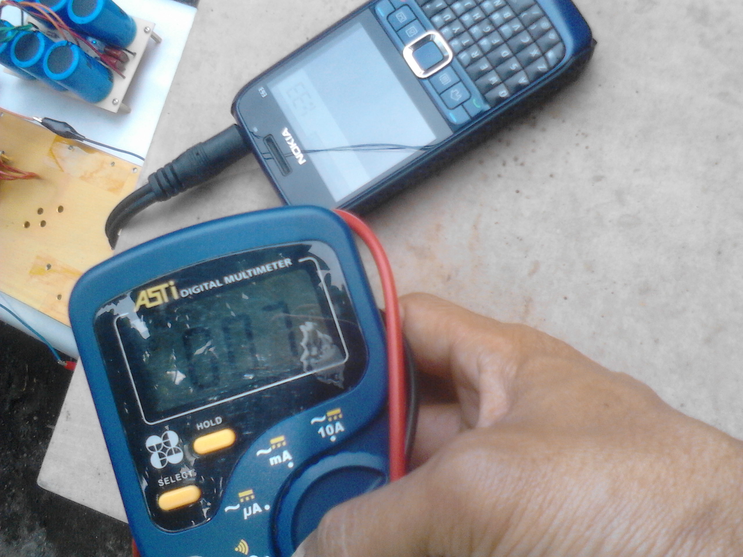

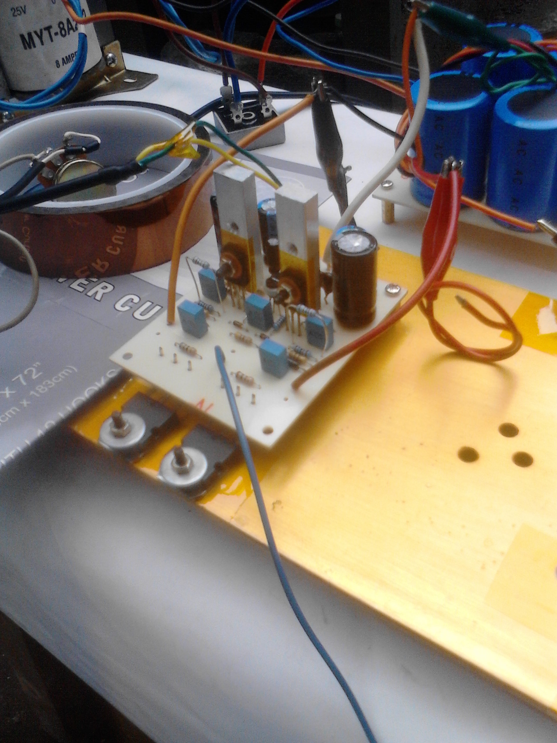

View attachment 401236..better late than never..😀
Peeceebee using Nafs lay-out (input diff 2SC1845/2SA992).
Many thanks Shaan and Naf! 😎
Congrats abetir! I sure you will have some experience similar to me.
Build a stereo and let it amaze you! 😀
Hi abetir.
Nice job! So the ball is still rolling in here. hehe...
Thanks for sharing. Enjoy your PeeCeeBee!
p.s.- I like the looks of those blue 1uF siemens caps.

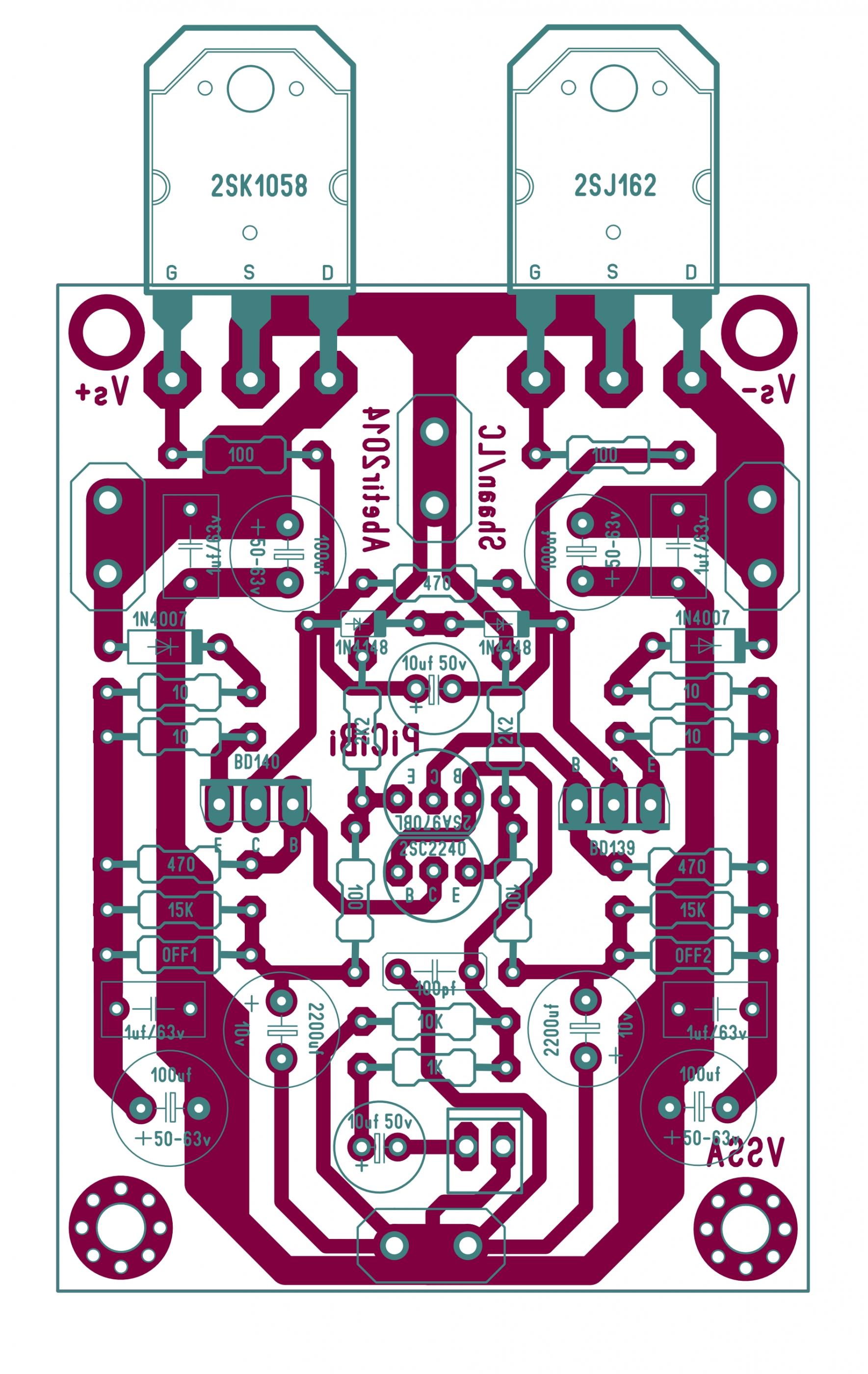

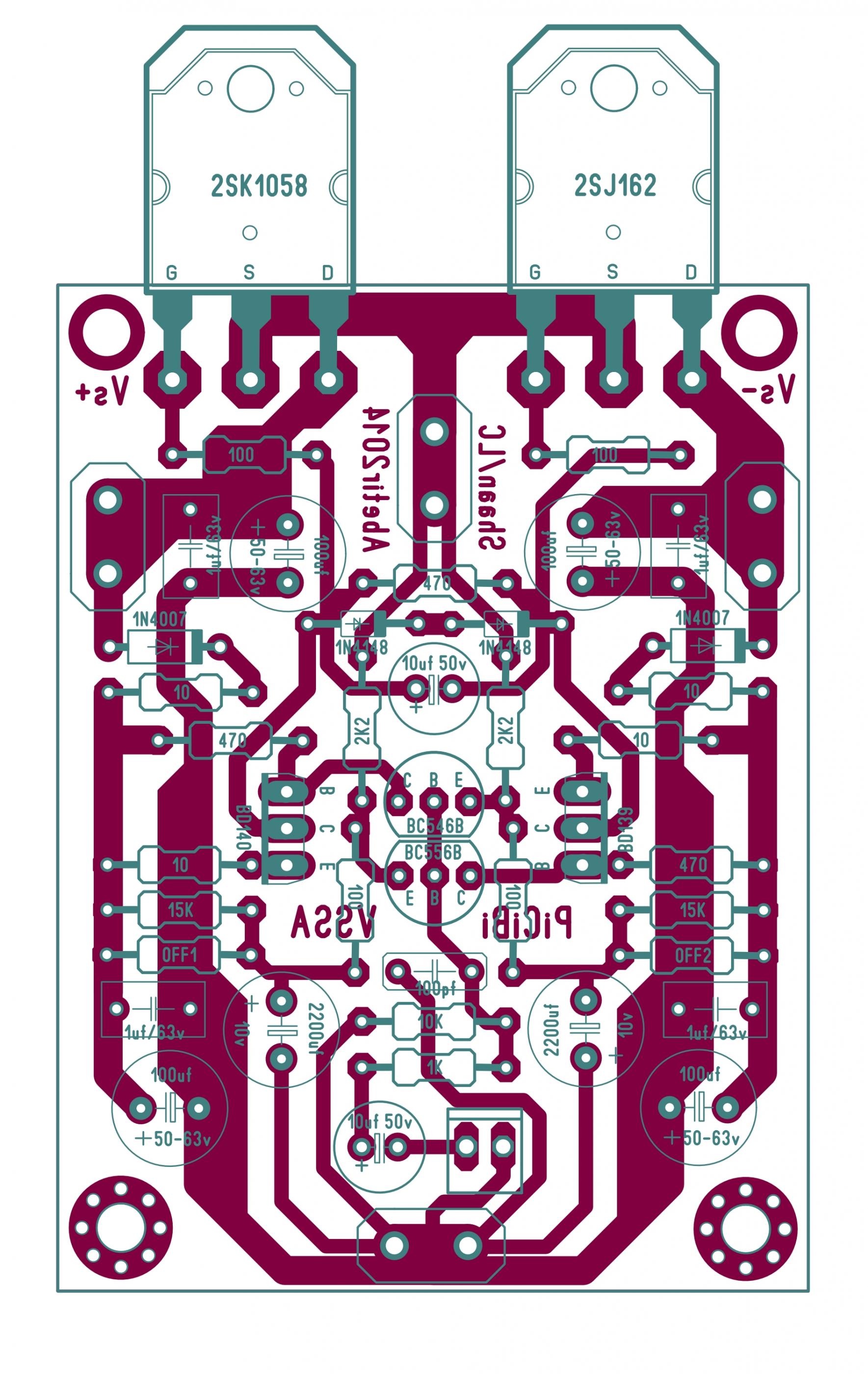

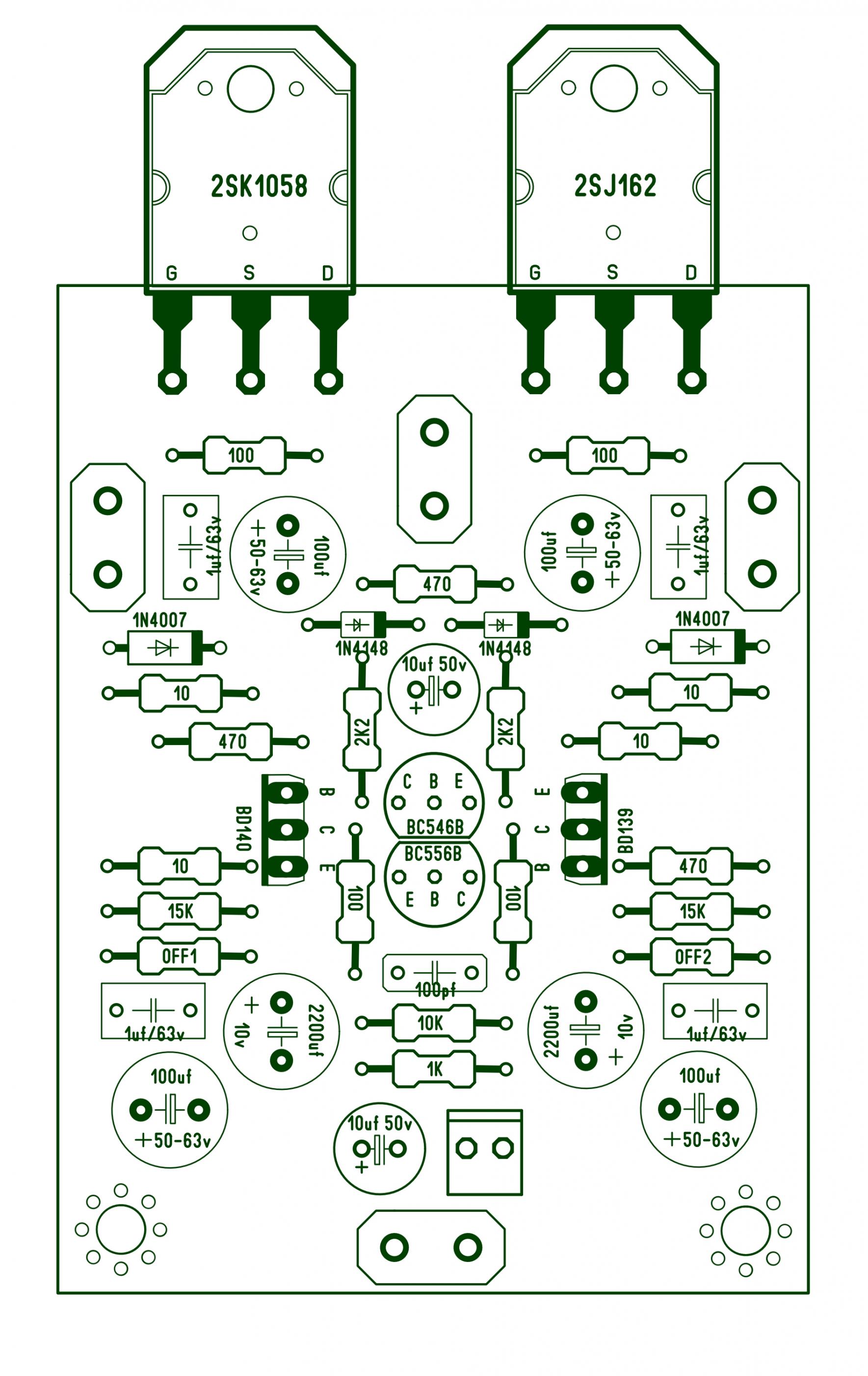

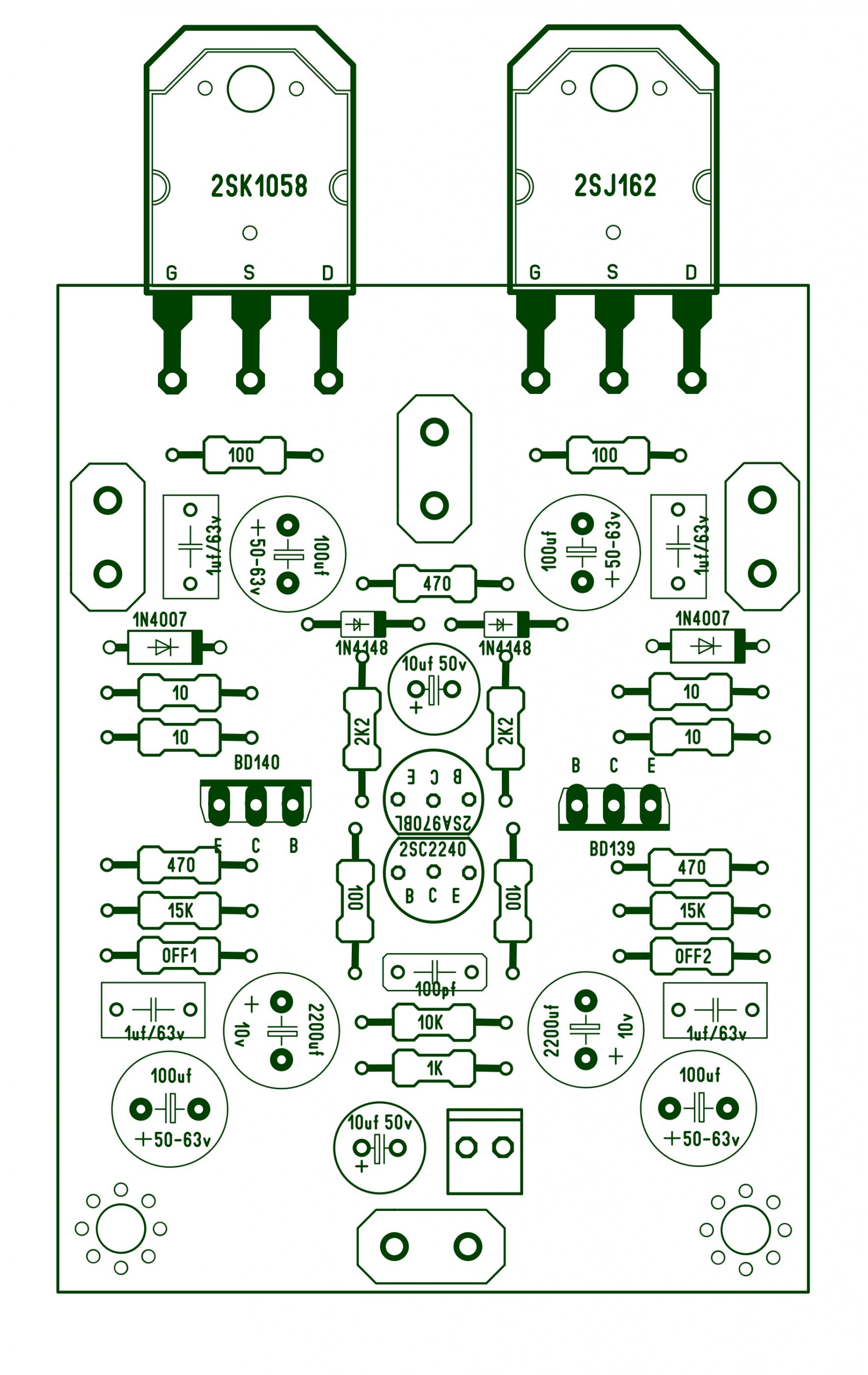

My favorite PeeCeeBee design was Shaan's and I made my own version following Shaan's original. I have attached the files for share, laserjet-toner transfer for home etching. Make sure to print a sample first for parts size comparison in your area. Two version exists, one for BCs and the other for 2SA/2SC (input diff trannies). I hope you may find them useful for your audio amp hobby.
Cheers!
P.S. v1.4 do not points to LCs original this is Shaan's PeeCeeBee.

Eagle?
Nice job man. I still can't scratch the surface of that program! 😛
