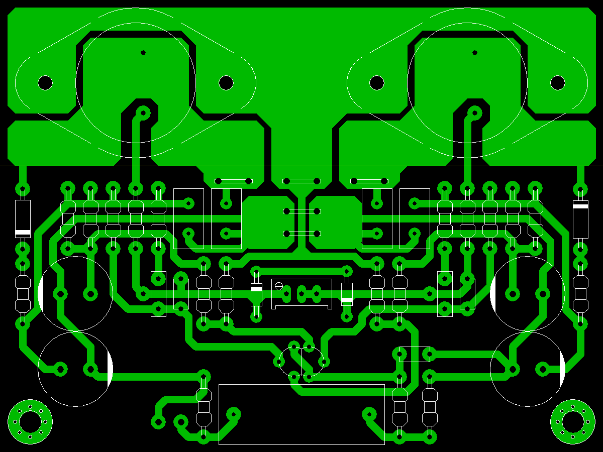

I want to make PCB that input pairs can use BC's pair or SA/SC pair so it can swap easily with different transistor. I'm an "orang lambat" so mine maybe not finish soon 😀
Waiting for Shaan if he let my "hand made PCB" can be post here
Regards
Go head Bli John with your own design I am sure Shaan will glad to see it.
Just remember to thermally coupled input pair. Make as short as possible track this is fast amp.

to Shaan it is OK if I post my PeeCeeBee design here?
(I want to made my own PCB layout)
Regards
Sure it's okay. It's a peeceebee so nothing to worry about! 🙂

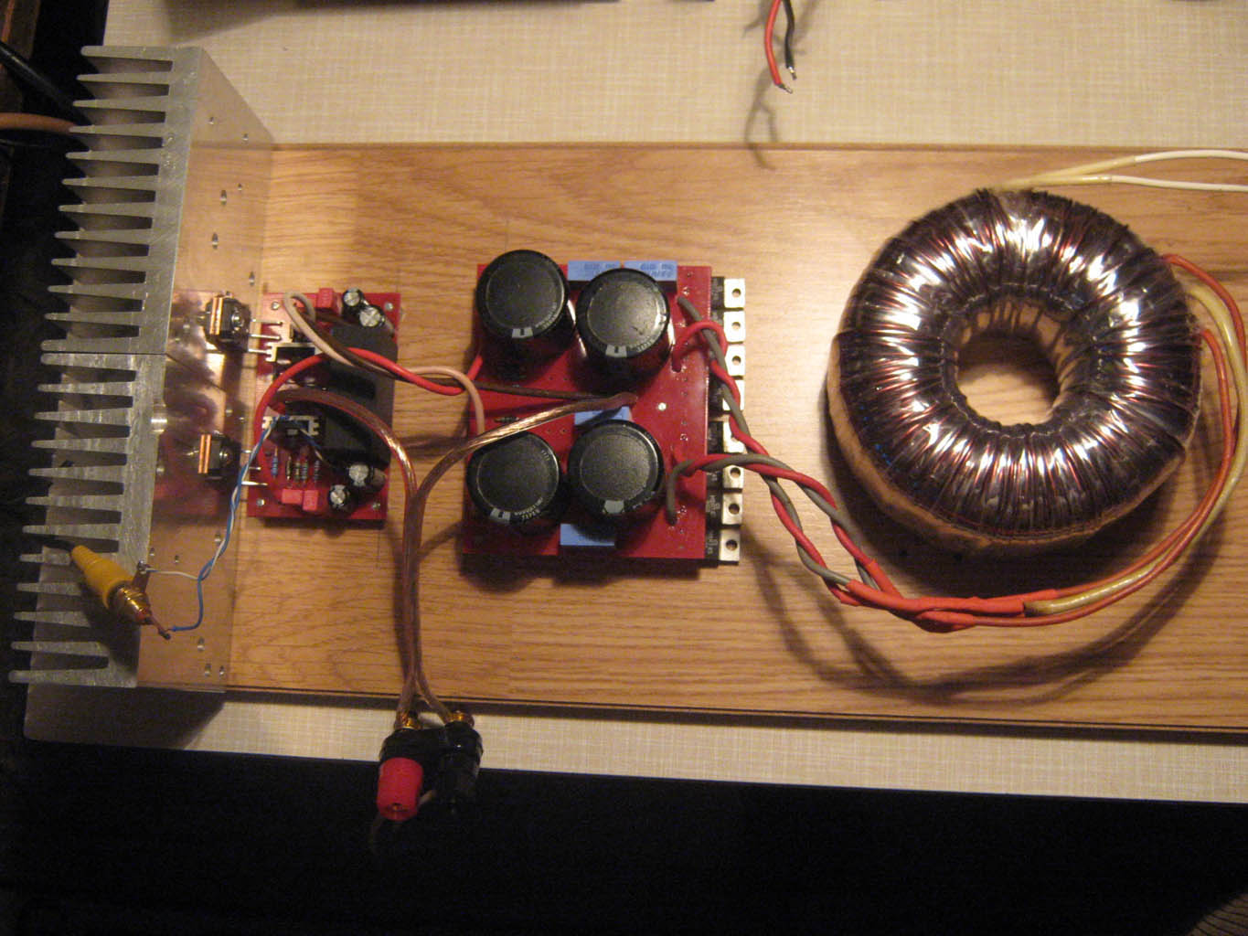

I removed cap multiplier. Now I have simple power supply with two Graetz bridges and 4x 6.800uF smoothing caps per channel. I can't hear any difference. Without signal, there's only silence: turn on, turn off, no buzz, no hiss, no brum, nothing. DC offset was zero without adding resistors. Perfect.
But...
Now VAS transistors begun to overheat. Again I had only few minutes to enjoy music.
So I removed trafo, put new one 2x 20VAC and got 25VDC per rail. Finally, everything was good, transistors almost cold, no problems except DC offset of 37mV. I'll solve it tomorrow.
Now I'm listening to music. This is very good amp, definitely it's value is greater then invested money. Like LC said "it really is a little wonder".

Q: Looks like you are encouraging people to modify your layout (please correct me if I am mistaken) in this thread, but not the schematic? I ask b/c I would probably change the shape of the board a bit for my own personal use, but don't like to step on toes in what is already an awesome thread... 😉
I'll leave it to Shaan for the definitive answer, but I believe so long as it remains the 'Poor Man's' VSSA you are likely good to go. This means:
1) Single sided PCB for ease of home construction
2) Through hole components and no 'Unobtainium'
3) No CCS
@Shaan & others: Very impressive thread!
Hi PMI. :wave:
I published the layout because I got requests for one in the VSSA thread and PM.
It is very compact and has non-polar electro at the input, I didn't add Zobel and Cdom(intentionally) for keeping it as small as possible(for me). My story ends here.
But each diy-er has his/her own circumstances/requirements, under which they design their own peeceebees and post them here. If my layout satisfies their needs then they might use it as it is, or, make their own based on the same schematic(yes, the schema is fixed 🙂 ).
It's fun and all are welcome.
I just want to encourage fellow guys here to try this tiny little amp and get shocked by the sound it produces for the bucks invested. I'm confident that everyone who tries peeceebee, will be satisfied(nothing is being sold here b.t.w. 😉 )
But...
If dc offset is only 37mV it probably won't hurt any loudspeaker.
