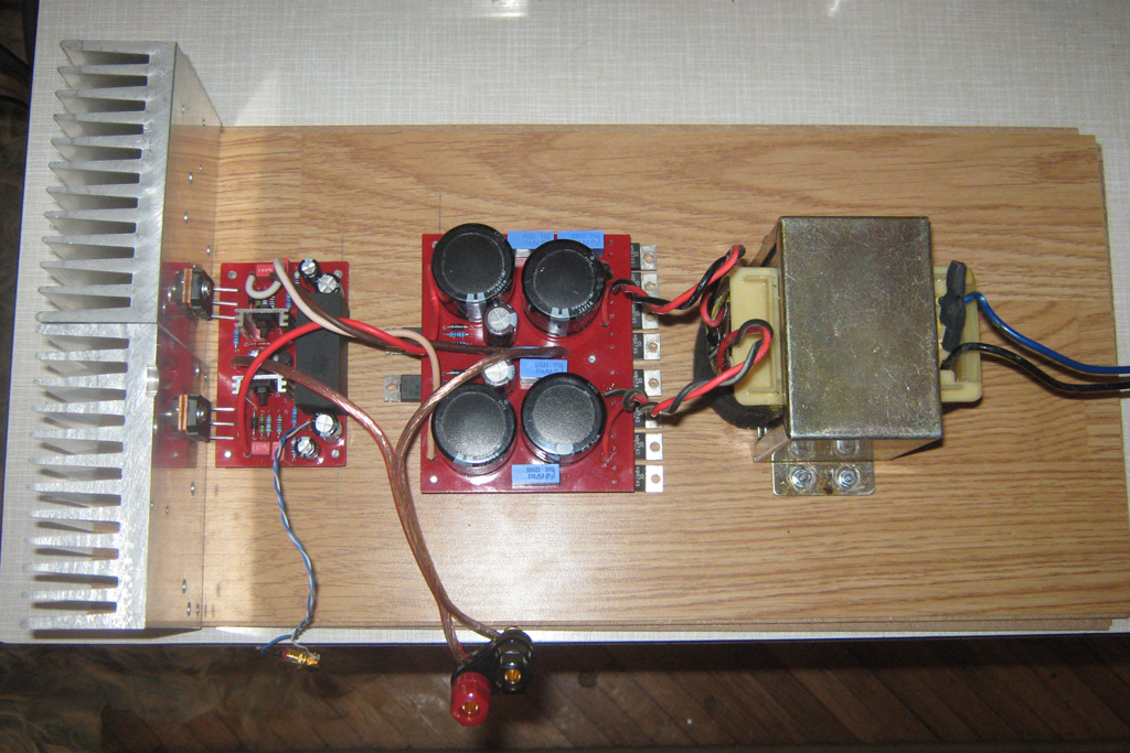

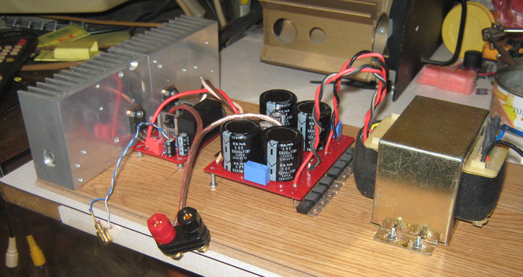

It works!
For now just for a few minutes. Mosfets at cap multiplier get hot, so I must put them on heatsink. I planned when some day I make enclosure, to fix mosfets and rectifying diodes to bottom plate.
It's too early to speak about sound, all I can say is this is poor man's amp, but the sound is very rich.

Congrats dobrivoje!
Just a thought... with the cap multiplier it's no longer a poor man's amp, is it? Did you try a simple dual supply with only bridge and caps?
...Did you try a simple dual supply with only bridge and caps?
I already explained that I used cap multiplier to lower supply voltage to less than 35V. Cap multiplier is simple - one mosfet, one electrolytic capacitor, one diode and two resistors. Ripple is much smaller and you don't hear thump at start up.
Anyway, I'll try without cap multiplier and report soon.

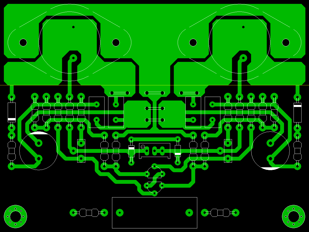

Sounds like a Star Wars character. A partial rendition for my cache of 2SK135 / 2SJ50 outputs, still a work in progress...
Nice layout kuetemann.
However, the 1000uF electros at the feedback node seem to be missing; the 100R doesn't look like connected to ground in any way(AC or DC).
I did mention it was partial and a work in progress 😉, there are a few components not yet placed on the board and missing connections. I just wanted to give a snapshot, more to follow. And yes, the devices are some of the original Hitachi laterals.
