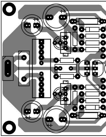

Shaan,
I think it is a very nice and clean layout, and it places the dual mosfets and VAS transistors very well now.
The 470R which was in paralel w the two diodes is absent, so I assume you are planning on a fixed voltage spread. I would not have a problem with that, but it may be worth noting for other people.
The diameter of the largest electrolytic is 16-mm (?)
That's all from me,
Pete
Sure, I do not see a big issue, but since I have a bunch of parts sitting here, I thought I would post some dimensions, so we can all plan ahead.One can use two spacers if one isn't enough, simple.
That's all from me,
Pete

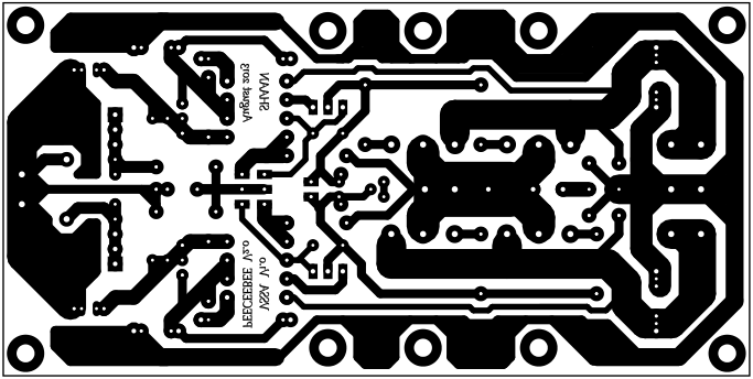

PEECEEBEE V2.0 Double MOSFET
Dimensions: 5" x 2.5" (127mm x 63.5mm)
Have fun.
Have fun.
Thanks for your help.
Pads have been added for trimmer(470R or 1K). So if one wants to play with the bias then replace the 4148 diodes with the trimmer.
0.4" (10.2mm) 🙂
Again thanks for the time you spent on scrutinizing the layout. Big help.

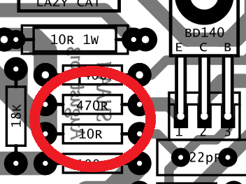

Important: Non-critical error in Silcscreen of Dual FET PEECEEBEE V2
The 10R and 470R resistors at the positive VAS got swapepd. Apologies. I'm still a fresher in this field. 😱
Please note:- The devices will not fail if someone places them in swapped positions following the faulty silkscreen.
What will happen:- The VAS and Output stage simply will not turn on, there will be no danger for the circuit or speaker(if connected).
The corrected silkscreen is in the next post.
