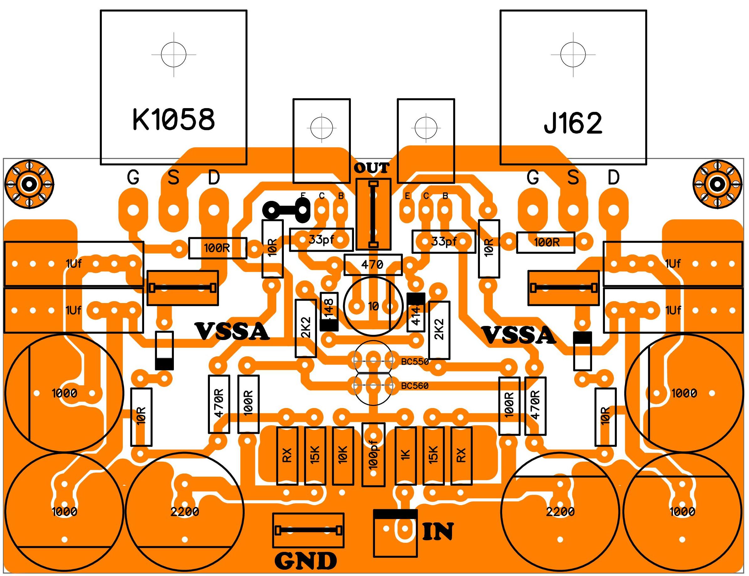

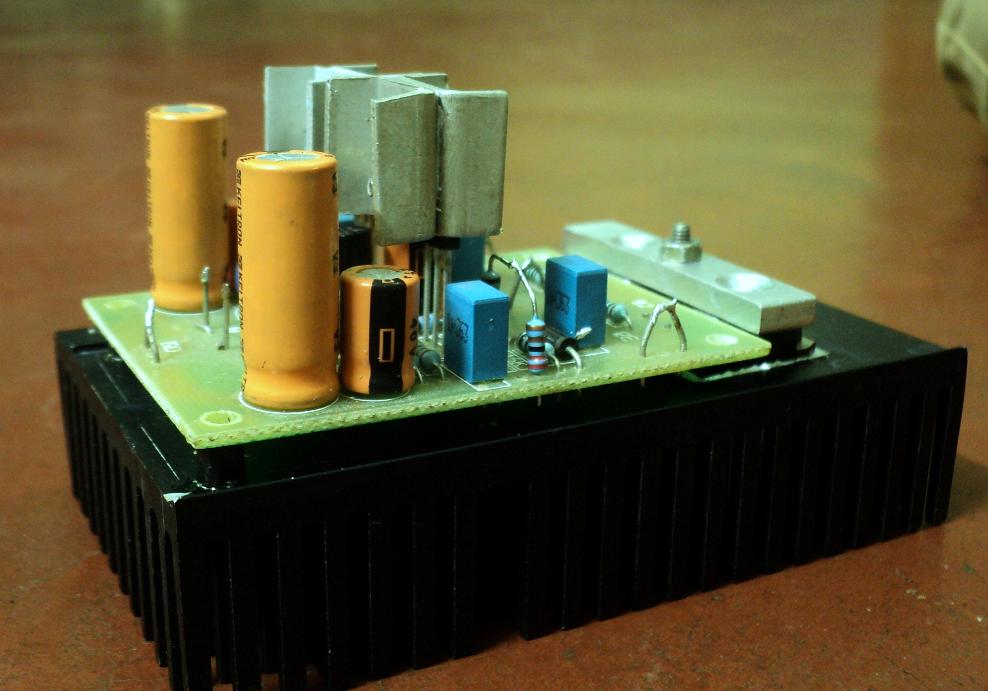

I drew this peeceebee before you made changes. I strictly followed schematic from post #1, just added one more pair of output transistors and source resistors. Size of peeceebee is 140 x 38 mm (5.5" x 1.5").
This is excellent option but, as PMI commented, for this mounting method we would need plated holes for output and VAS tranies, so that all these transistors can be screwed to the heatsink with pins bended, pcb mounted over, and then soldered from components side. Otherwise, it would be very difficult to have all transistors flat on the heatsink surface. And plated holes are not an option for all builders, only for those that can provide pcb factory services.
The unmatched hfe in the VAS transistors should not change the offset, or only a tiny bit. It will have more influence on distortion, through its effect on the positive and negative halves of the signal. We are all in the same boat in that respect. The "E" and "D" parts cannot be matched, and no version of BD139/140 has specs to impress.
In any case, matching the input pair seems more important, and easier to accomplish.

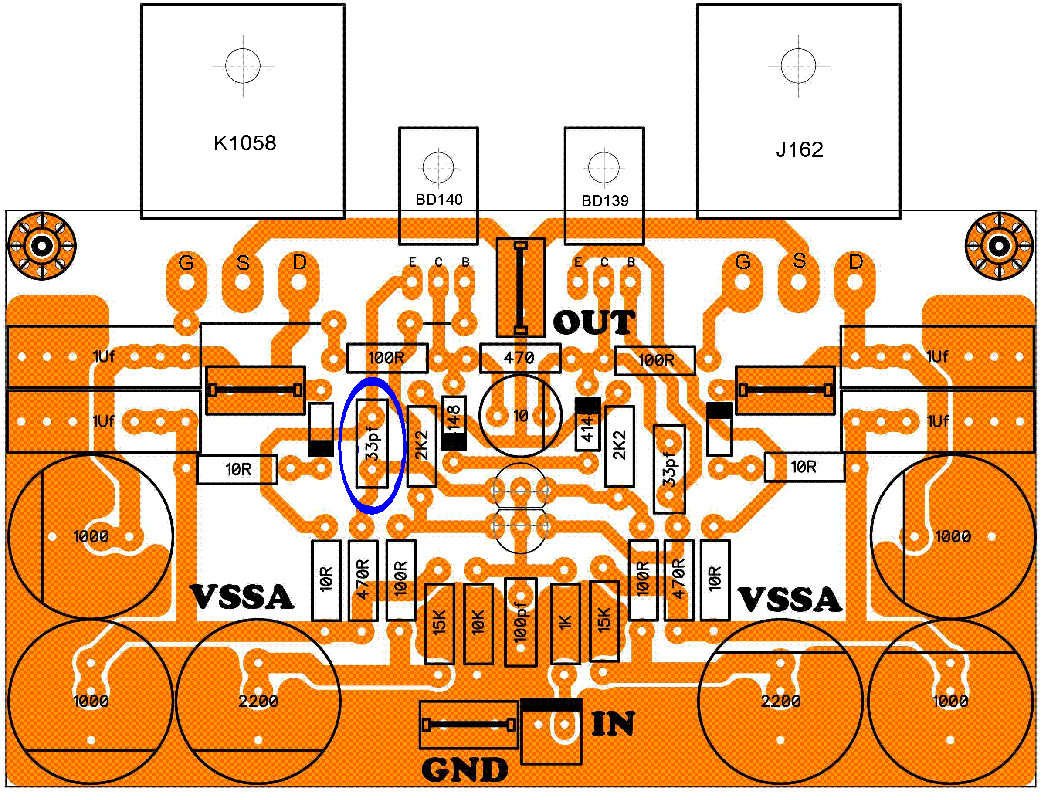

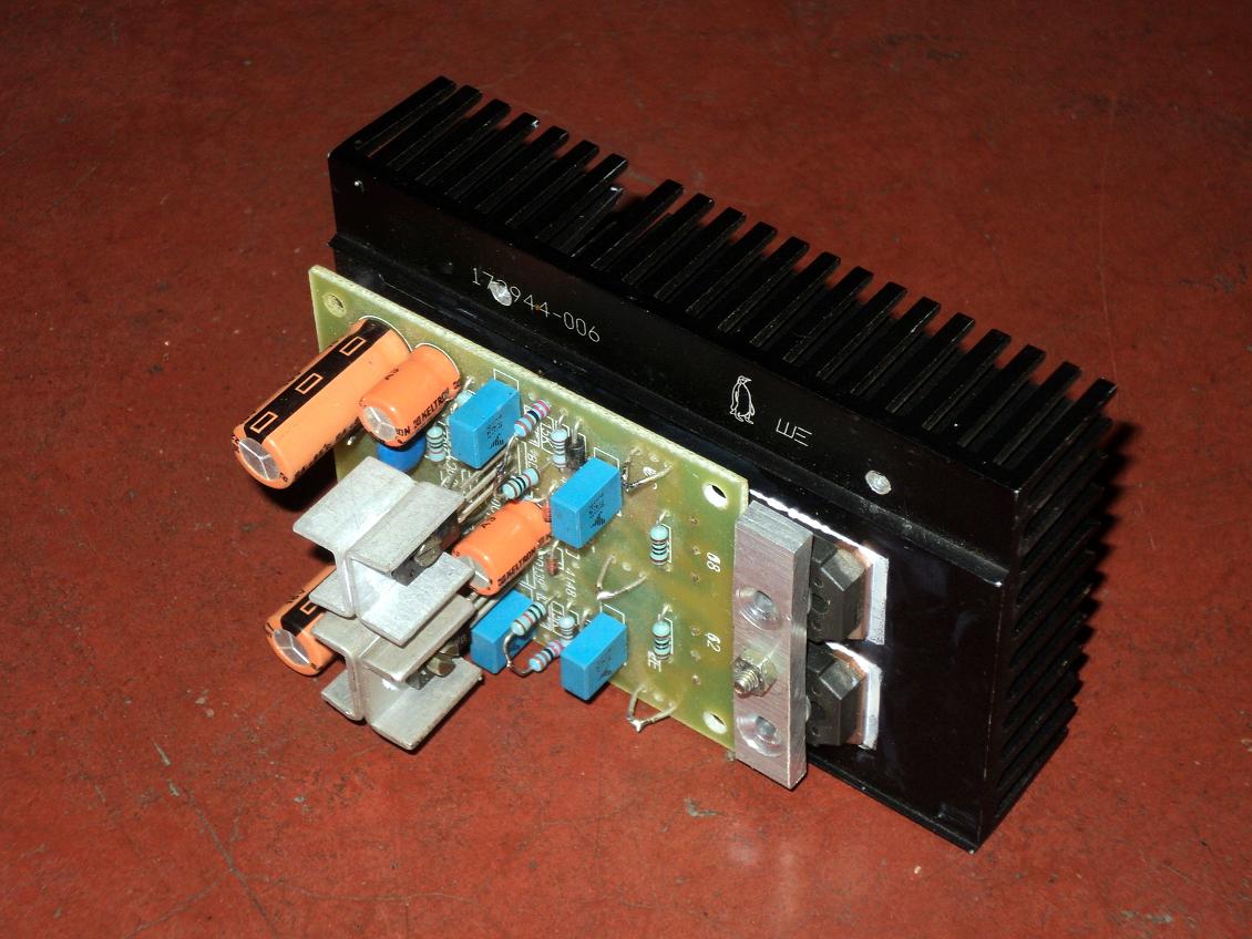

Thanks for remind me, that's why I want to make a new board (2 pairs OP maybe)Now what I'm thinking is make a new Peeceebee that can safely operate at +/-45VDC or more cause I don't want to screwed up my first made again , no more sparkling or smoke
Yes it's true...(I've done it before, make enough changes from an original concept, and taken in combination, the sound you liked at lower power levels is gone... )
for Shaan, please in check if this is correct?
Hi daman.
Nice drawing!
My thoughts:
1. Double the width of FET source and drain traces.
2. Move the 10R VAS degenerators and compensation caps close to the VAS transistors.
3. Add parallel resistors with 15K current sources(those 'off 1' and 'off 2' marked resistors) for easy offset trimming.
That's all.

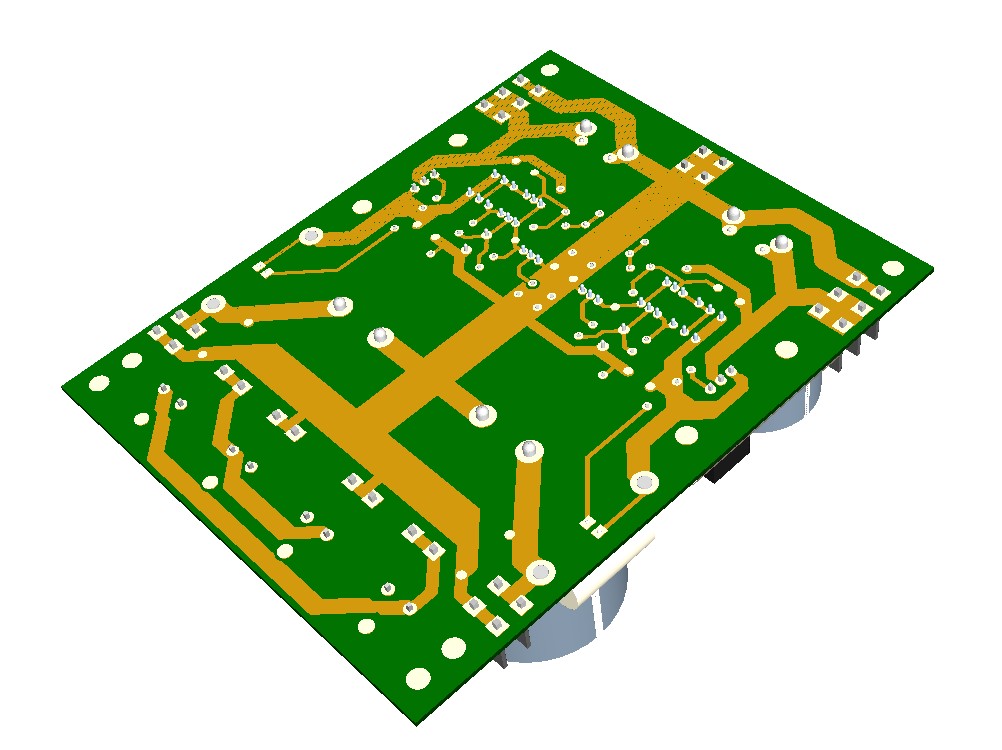

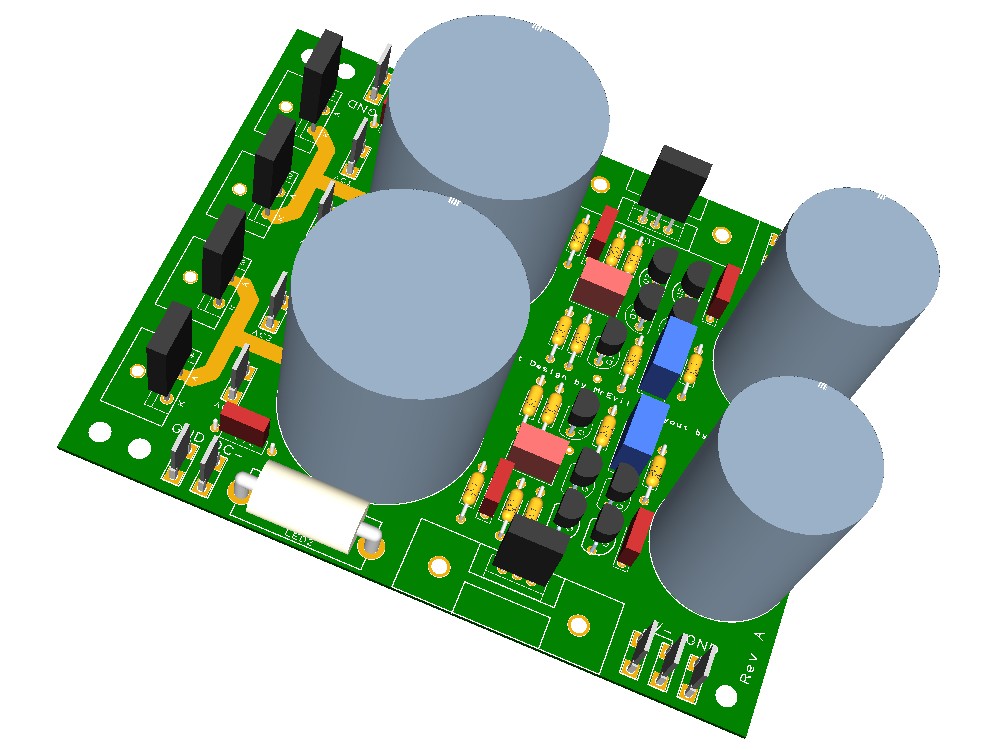

As posted above, I am working on a capacitance multiplier power supply for my version of PeeCeeBee. A couple of you have expressed some interest in the boards, and/or in etching your own which I heartily encourage... (even though it is not one of my personal talents... ) Finished boards will be supplied @ my cost plus shipping, $10 each or very close to that.
(Failing that, I plan to post pics of smoke, rising from my bench, for amusement and edification, chuckle)
3D renderings of the board are below, pics of the boards to follow in 1-2 days.
(This board is 2-layer, but a single-layer version can be posted to etch your own if desired as soon as I am finished testing)
The circuit design is courtesy of MrEvil, and documented in a separate thread. Like most things I work on, I have tweaked his original layout a bit, but credit for the circuit design should go to him.
http://www.diyaudio.com/forums/power-supplies/53359-finished-capacitance-multiplier.html
http://www.diyaudio.com/forums/power-supplies/51817-improving-capacitance-multiplier.html
I selected this circuit for low cost, and low dropout voltage. With a bit of care, this should give an output which is as clean as the SMPS recommended by LC for the VSSA modules in his GB, at a cost of about 20-25 Euro incl. the board. (less if you have access to some inexpensive caps).

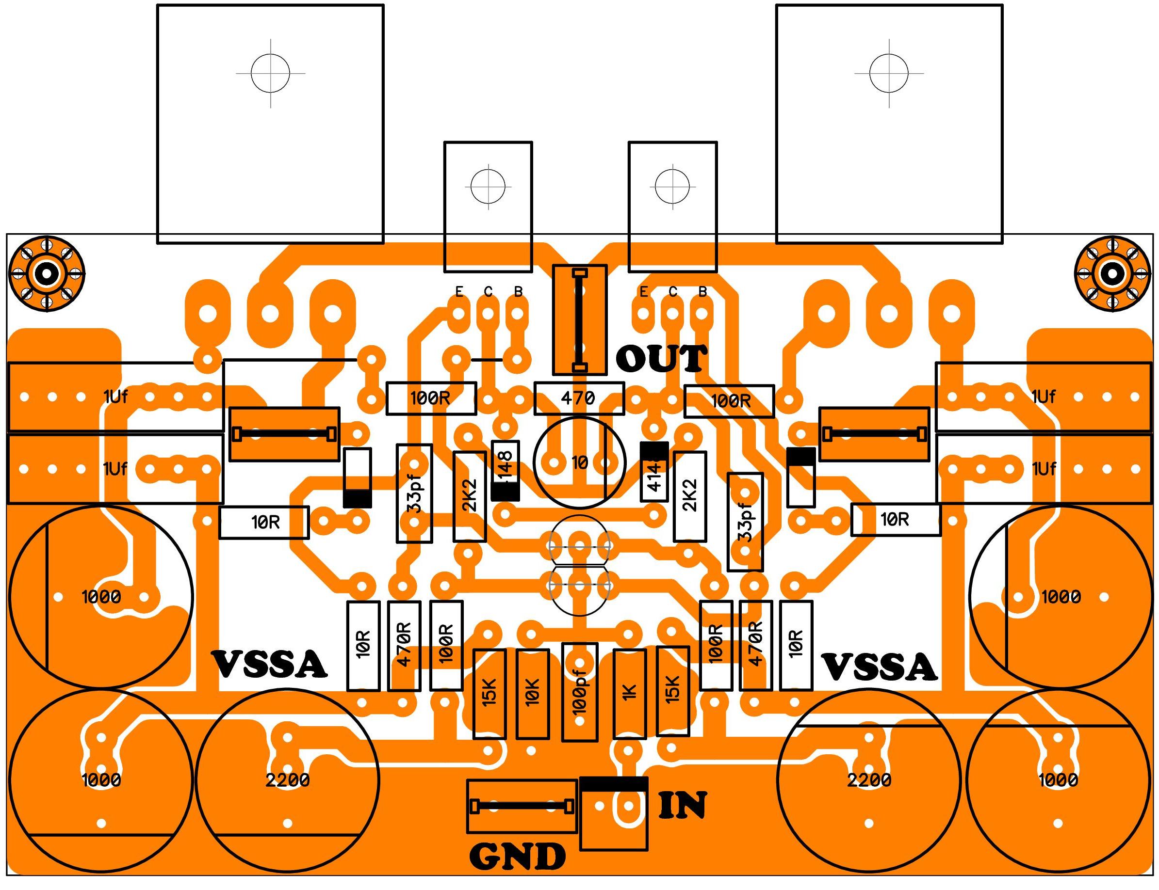

if this is correct???

How does this look???
Marvelous Shaan! another professional work from the master. Super !
