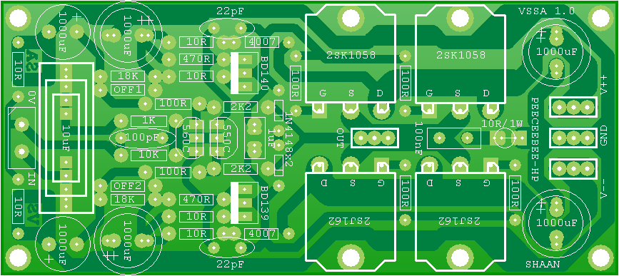

Almost at the end of drawing. Please comment...

Shann,
that's a very nice pcb! 🙂
I must say that I really apreciate all the effort you are putting into this allowing us to taste a very beautifull sounding amplifier! :violin:
Thank you, Shann!:hug:
Of course, my thanks algo go to LC.🙂
What's the recommended rail voltage?

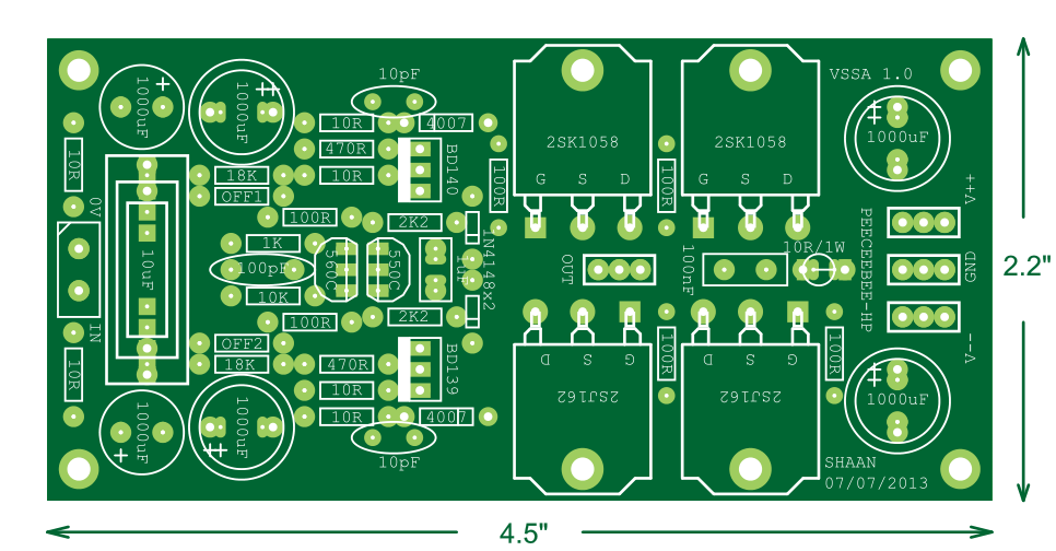

Now we have 5mm. Board dimensions: 4.5" x 2.2"
It looks very nice, clean layout with short tracks. :up:
Did you leave out the 470R that was in parallel with the two 1N4148 diodes in your original schematic? I do not see it on the board.
....I was thinking of how should the heatsinking for the drivers be done properly.

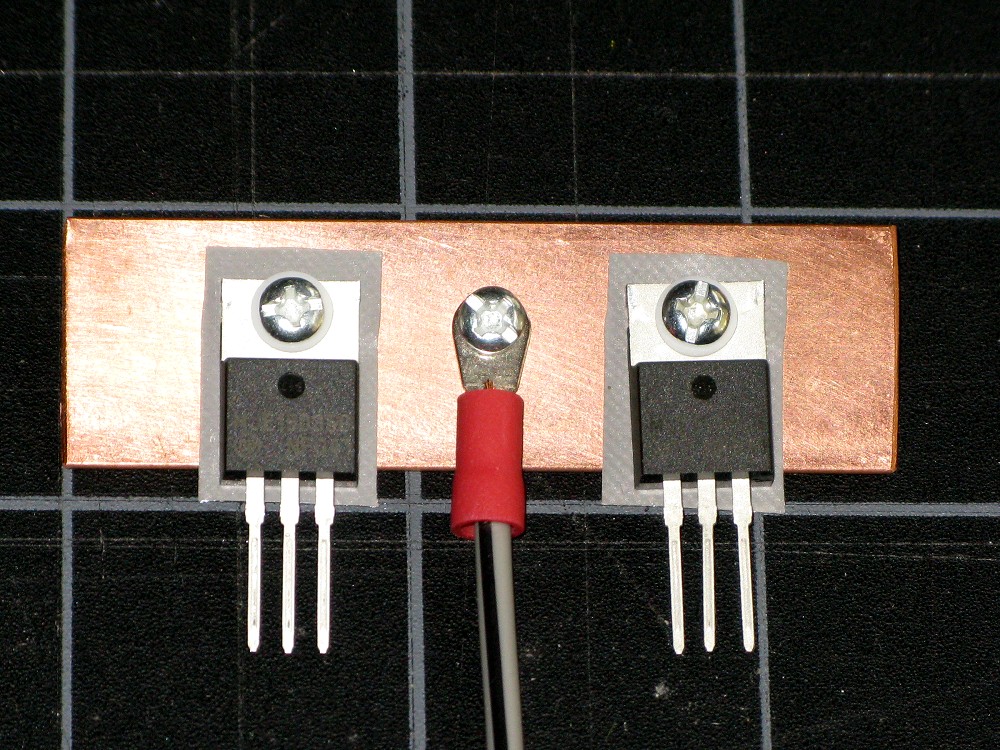

Perhaps it is time to consider a common heatsink for the two drivers, fixed to something else on the board. The higher the supply voltage, the hotter the drivers will run, and the more variance there can be if they happen to heat up unevenly. The heatsink or heatsinks will have to clear the two TO-92 transistors, and also the 10-pm compensation caps on the edge of the board.
There is also a comment in this thread about attaching a common heatsink to ground...
Thanks all for the comments. Problem areas will be taken care of.
Yes it is best to use single heatsink for vas, simple plate type, or with fins horizontal to the board(the inside of dead atx smps comes to mind, ya i've got two of them in my junkbox 😉 ).
I will try to accomodate the VAS heatsink on the board as suggested. Thanks everyone for the tips, also thanks for your patience.
Yes it is best to use single heatsink for vas, simple plate type...
I started working on this a few weeks ago, b/c you mentioned it in one of your first posts. There seemed little discussion of the heatsinks in general, so I did not pursue it further.
My guess is that assuming the same VAS bias, the temperature of the individual VAS transistors will deviate more with higher supply voltage.

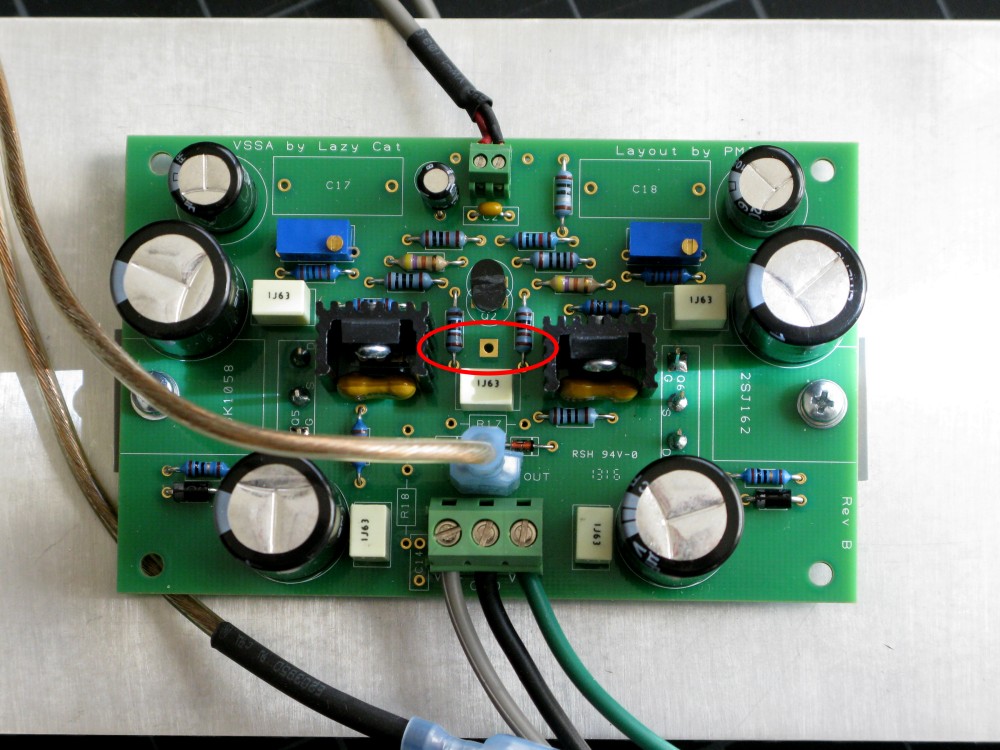

When I made my board layout, I also allowed an anchor-point on the pcb, so that a pin or wire could be attached to the board and help support, and/or ground a common heatsink that did not touch the board, because moving the feedback resistors out of the way was not very convenient.

Hi Pete.
Your idea of the anchor point is very good and I will try to implement it in the board. However, I think I'll take some time, some days maybe. It's giving this amateur brain mild nightmares right now 😀 and complete re-arrangement is gradually becoming unavoidable(not blaming anybody, I took the task myself).
...I think I'll find a way, haven't reached the limit yet I hope.
I have prepared pdfs of the version with separate heatsink for VAS transistors, it will look like the attachment in post >864<.
If anybody is interested in that version then I can upload the files.

I used simple unregulated +/-38,5V PSU. With this voltage total VAS+front end current is over 30mA, almost three times more than it should be. Small VAS heatsinks are very hot. But this is in fact normal since my circuit is made with 16k resisitor. Remedy is to use exactly 35V rails. If you want instant success with parts values on the schematic(s) you must have 35V rails, meaning that you should buy transformer that gives 25V on the secondaries unloadeed, not 25V loaded as I used. Another remedy is to use 18k resitor, or more. My front end BC...Cs are properly matched.
With the relatively small heatsink that I used (Fischer SK92) circuit parameters stabilize relatively quickly (30 minutes).
Biggest surprise is that I could not get DC offset less than 230mV, even with trim pot. I am not sure what is the culprit but I guess its different rank KSA/KSC VAS tranies, that is impossible to match (or unmatched feedback resistors). I used only one 1M trim pot, probably on the wrong side of the circuit. I tested both modules with similar results.
