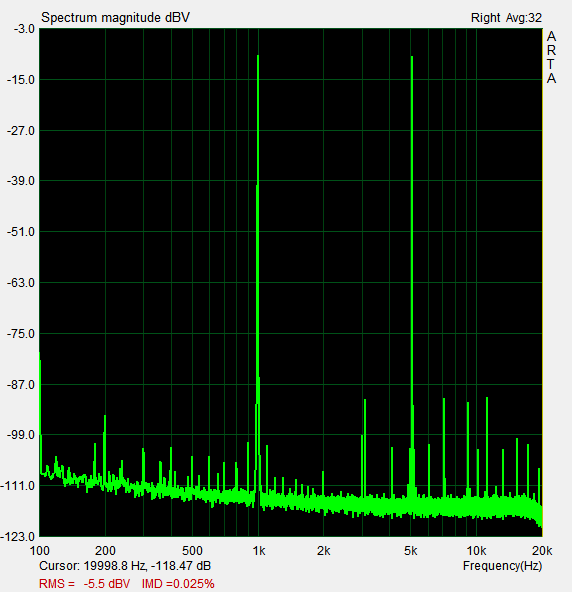

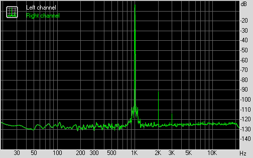

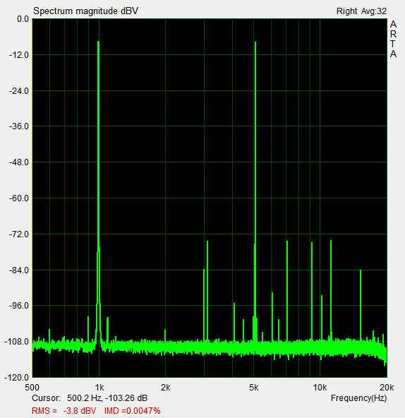

Hello Guys.
I'm currently testing a V3 that during testing I had some wiring issues and my V3 was oscillating.
now the wiring is correct and I got good thd results on 1khz measurements.
However imd of 1k-5.5k and thd measurements of 3khz and 5khz are considerable worse than I expected.
THD:
1khz : 0.007%
5khz : 0.079%
imd:
1k - 5.5k : 0.079%
Tests are against a 4ohms on 5 vpp.
this v3 is running at 28.8v with a vas bias of 18ma and mosfet bias ~120ma
So. What component could make high frequencies to be so bad?
Ps. drivers and mosfets were replaced after the oscillation issue was resolved.
my drivers and bcs are matched under 5% hfe.
Hi Bruno.
From a Class-AB amplifier with around 80dB open loop gain, the 1KHz THD performance seems normal. However, more information is needed for answering your questions about the problematic readings correctly.
What output voltage level did you take the measurements at and what is load resistor value? Can you test the THD and IMD of your signal source and share a couple screenshots of the source FFT?
Hey Shaan.
Thanks for the questions.
So I did measure thd of my source :
1khz 0.0038%
imd( 60hz - 1khz ) 0.0081%
I did measure 1k - 5khz imd on other amplifiers using the same PSU the same parameters.
amp1 - 0.0074%
amp2 - 0.014%
the parameters are load of 5 vpp @ 4ohms
So the problem seams to be on my v3.
correction the imd(1khz-5.5khz) of v3 is 0.039%

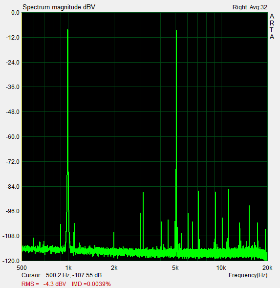

Hi Bruno.
I have more news, hopefully good.
Changed file playback source from PC to phone which has lower noise floor and also lower THD than my PC's onboard line output, and the graphs changed, significantly! Take a look.
Pic 1 - 1000Hz+5100Hz Source IMD, 0.0039%
Pic 2 - 1000Hz+5100Hz V3 IMD, 0.0047%

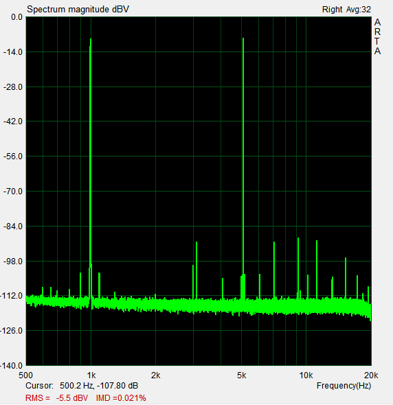

Hi Bruno. Please ignore my last messages. Read on to know why.
I spent the whole day to find out why the IMD reading was such unrealistically low in the last measurements as this amplifier, in its default config, simply can't have 0.004% IMD.
Turned out I made a mistake in my measurements; told ARTA to measure for 1000Hz+5500Hz while signal played was 1000Hz+5100Hz. As a result it showed erroneous IMD reading.
The correct readings are attached below. 5VPP into 5R (two 10R in parallel).
Pic 1 - Source 0.021%
Pic 2 - V3 IMD 0.029%
This is a more realistic IMD reading which is also consistent with the design's limits.
