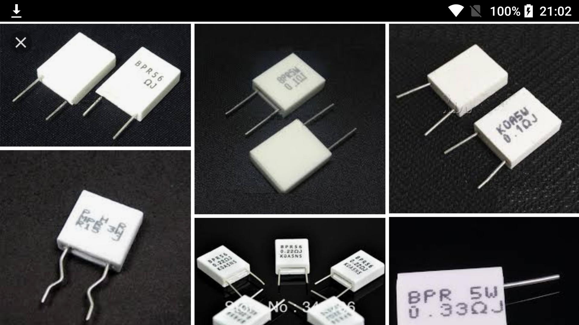

Question on parts. What are you using for the 0.1R/5W resistor. I can only find Wire Wound resistors & the smallist one i could find, the body is 12.5mm long.
MFG P/N - RWHSE09TQ000R1FS
Rick
These will fit perfectly and are easy to get. Wirewound vertical mount resistors.

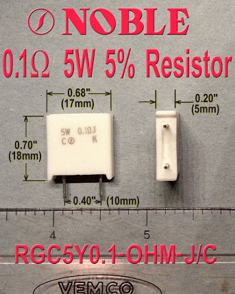

0.1R / 5W
... or the the MPC74 series from FUKUSHIMA FUTABA. The MPC74 (5 W) and the MPC78 (2 W) are declared as »Audio Grade« with low distortion, non magnetic and noiseless: Height 18 mm (± 1.0 mm) / Length 14 mm (± 1.0 mm) / Thickness 5 mm (± 0.5 mm) / RM 9 mm (± 1 mm) / R ± 10%
