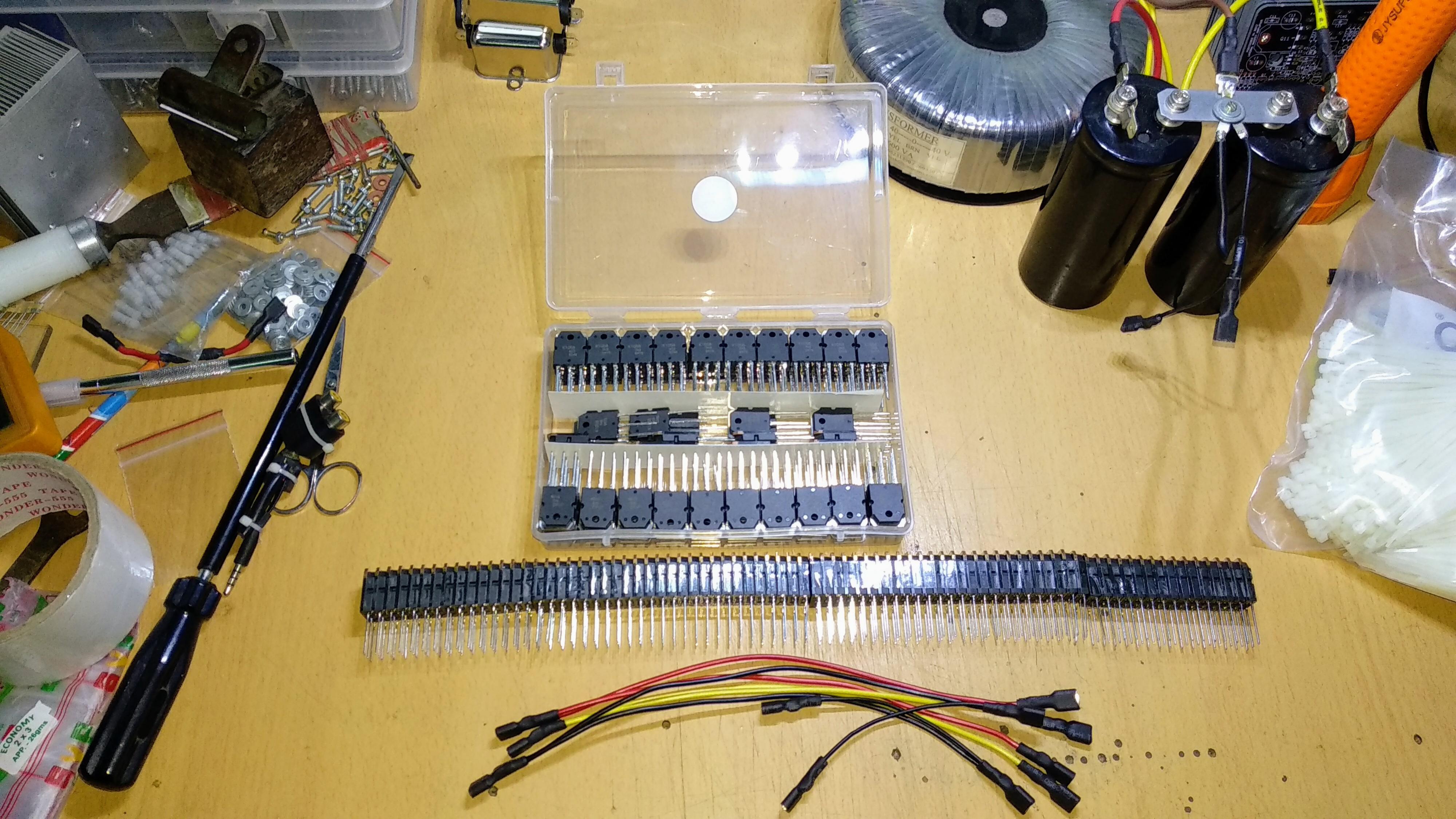

Lotsa laterals
Additional 40 pairs of the MOSFETs arrived today. 50 pairs from last batch in the box. Who needs some silicon? 😀
