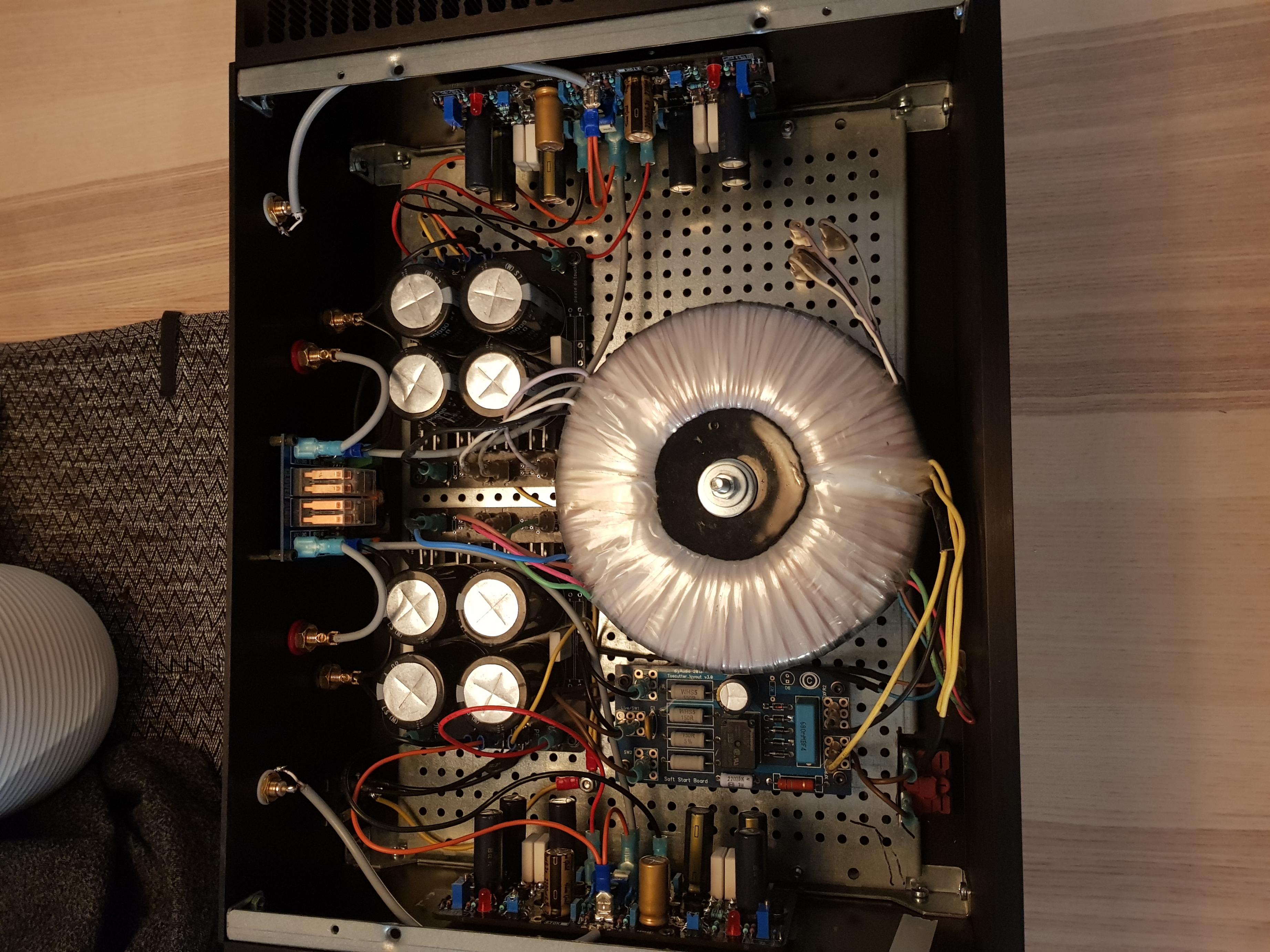

My PSU(dual) ground is lifted with 10 ohm resistor. My heatsinks are grounded through main earth. I have a constant slight hum/noise which is not amplified. :scared:

Hi Medisinmannen,
have you got separate grounds for left and right on your speaker protection board? If not, disconnect the board and run the output cables directly from the PCB to the speaker posts. See if that makes a difference.
I noticed that your speaker cables from the pcb run right next to the transformer. You might want to relocate the two cables away from the transformer.
It looks like you connected the grounds from both PSU directly to the chassis metal without any loop breaker. This may have caused the noise. It being not amplified is another indication that you have ground loops.

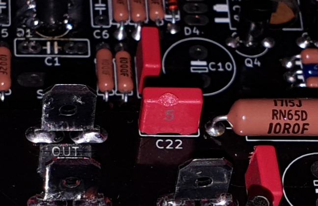

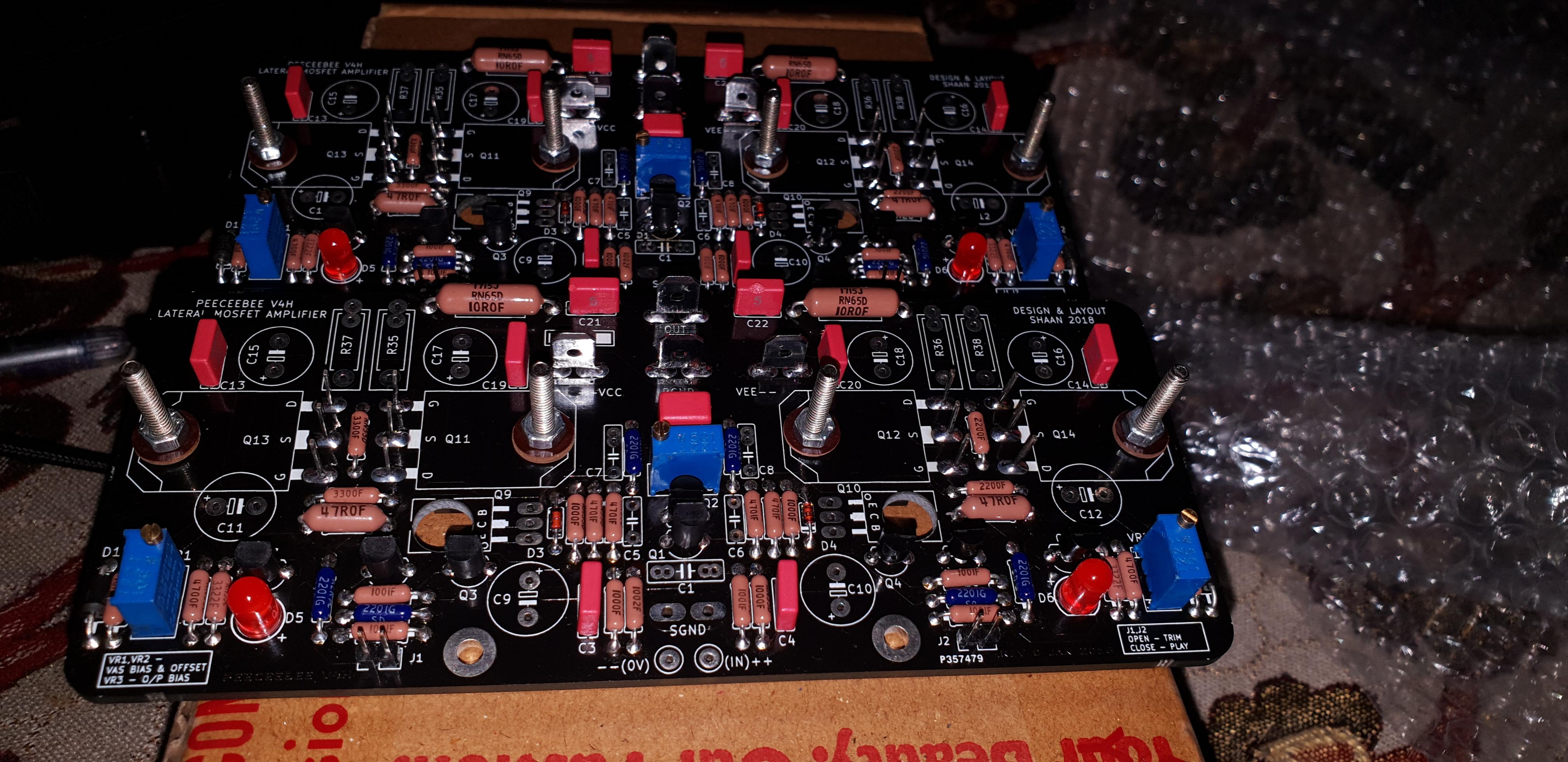

Hi
I got my v4h boards and the parts a while back. I have now started to put in the components together. I accidentally touched the soldering Iron to one of the 100nf 100v cap. should I replace it?
(And if you are wondering about those nuts and bolts, they are their to align the mosfets to the holes on board)
Bharat Singh
