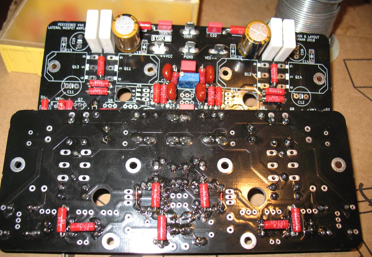

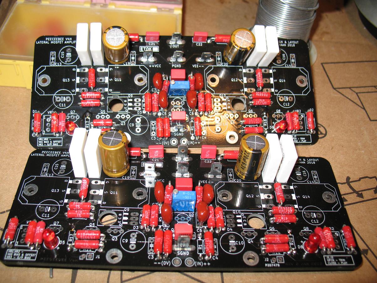

Here is my progress, it was not easy because of the size of the resistors I ordered. I usually use 1/2W type and automatically I order those. I did not want to return for exchange because of the shipping cost plus they take of percentage for restocking.
I soldered some part on the bottom I could not do another way.

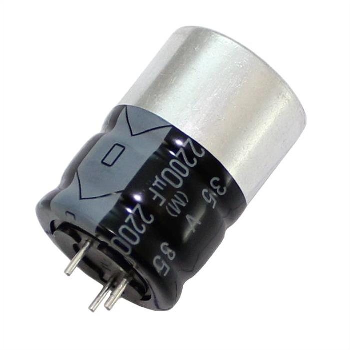

I will order some parts more (some electrolytic) the one I got way too big by size. Nichicon FG 2200uF 25V or ROE 2200 16V.

... You are not wrong. This is a industrial type of an ELNA capacitor !
Yes , not bad Kane
Hi Gabor,
I like PRP resistors (not attracted to magnets).
I assume that you know that you have to clean off the flux on the boards after soldering.
I use alcohol with a tooth brush. Usually I do it before soldering the trimmers and electrolytics.
PS I prefer 1/2W resistors.
