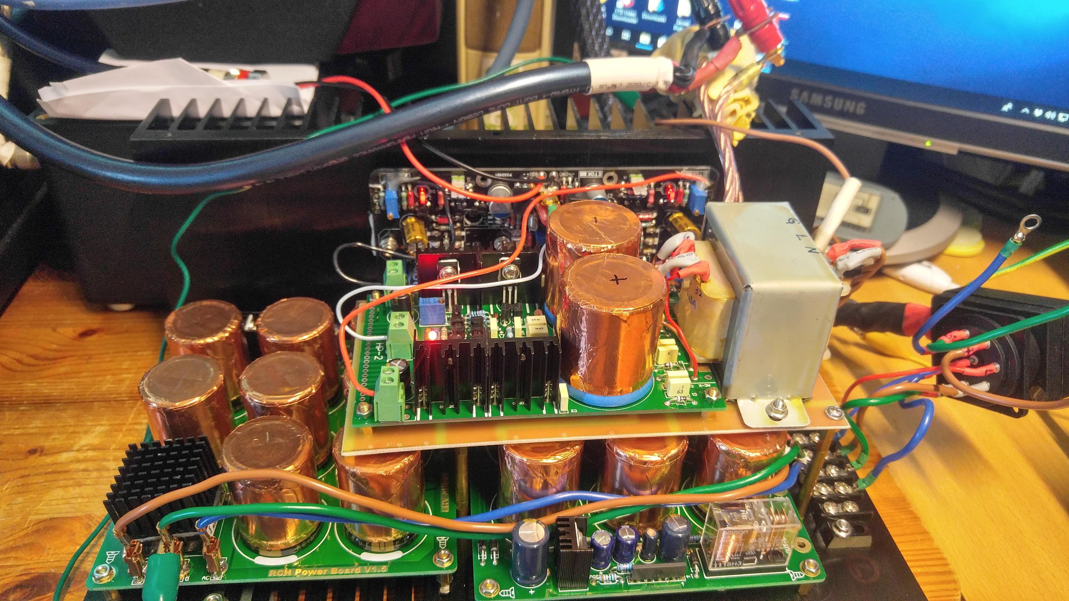

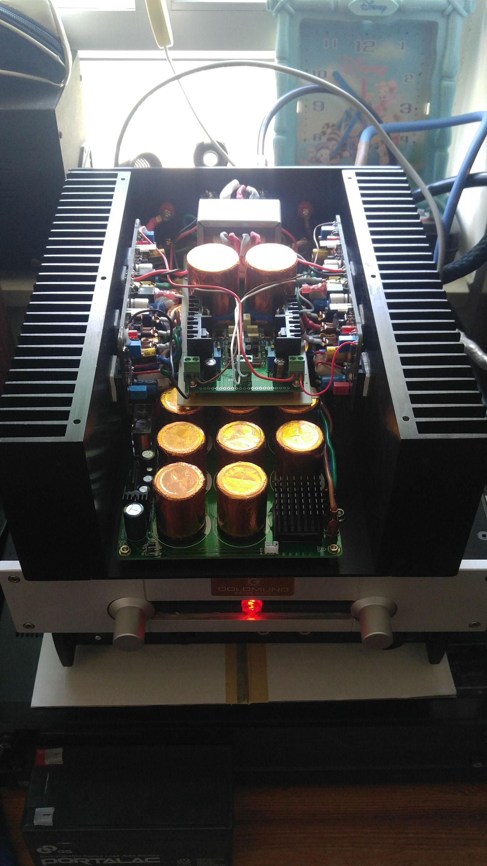

Hi Shaan ,finally i completed my V4H at 35Vdc with 500mA per each power FET. The sound very nice and open , the bass low band very good and punch. High-Mid band is crystal clear.
Again, i much appreciate your support and strive for this project

Nice and very tight build, congratz 🙂
What's you PSU ?

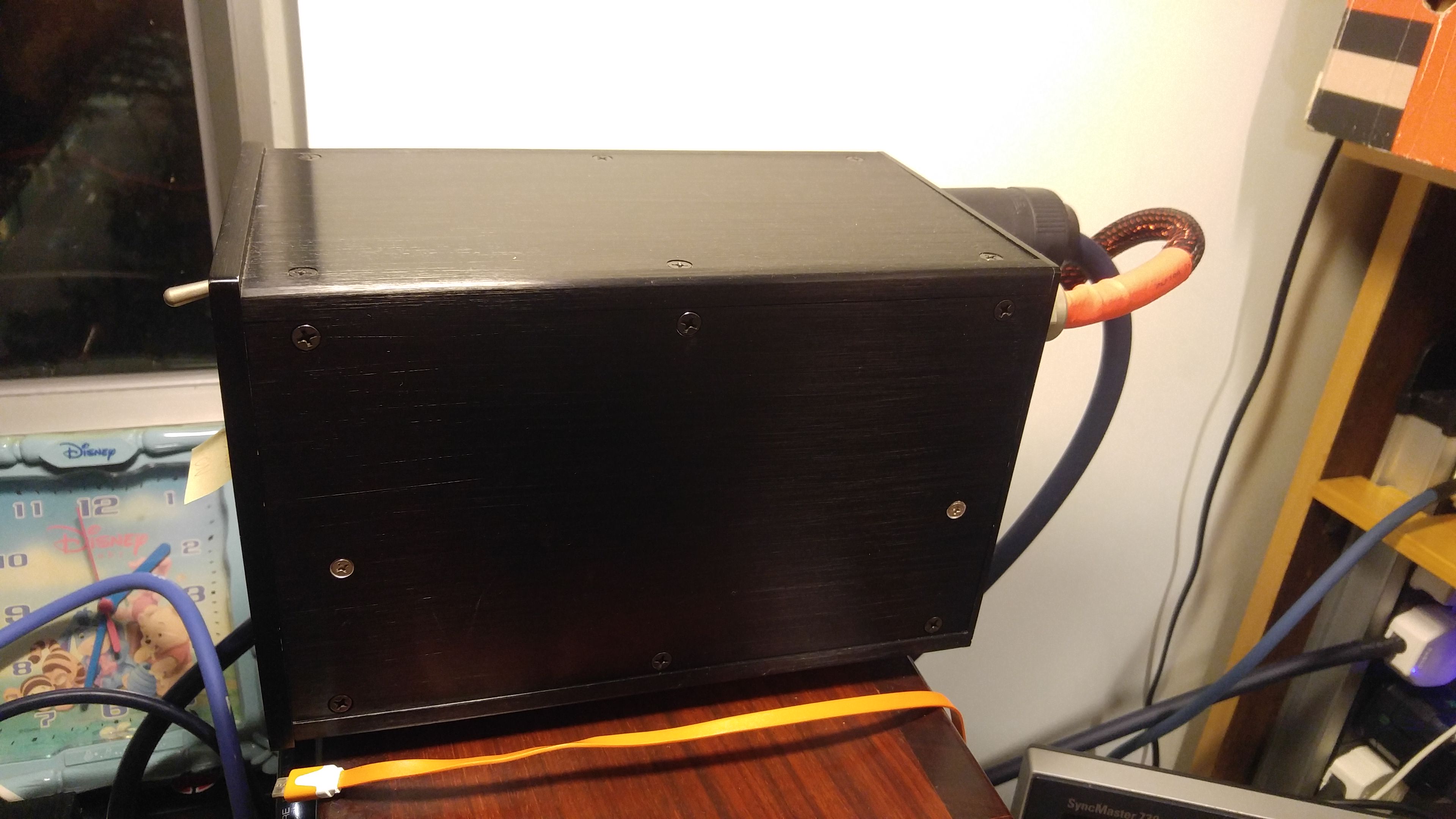

Hi Kheno, here you are ! It is external with two 250W toroidal and have AC filter inside and power soft-start control

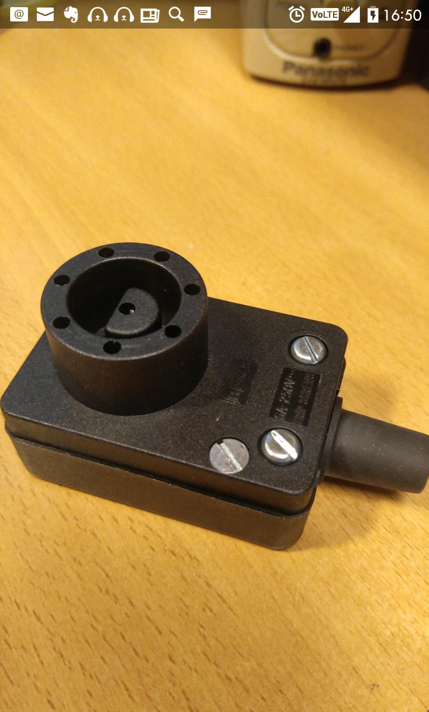

This is my connector for the supply. 230vac x 1 set ; 24-0-24 x 2 sets; 1x commond ground (additional)
Thanks !!
And what are the boards in the middle of the amp ?
You made a separate PSU for the VAS ?
Yes i just used for frontend and middle stages with regulated voltage (5v higher than main power supply) . it draw total around 60mA for both channels.
Do you think it impoves the sound a lot ?
How much capacity do you have on each rails of final stage ?

Wow that's a very pretty case, and great insides too! Congrats! Please do share some more pictures when you have free time.
Thanks for your interest in peeceebee and I am very happy that you like its sound.
A great no compromise design!
What regulators are you using for the front end?
Are you you using speaker protection?
Yes the speaker protection associated on the main dc recitifier for backend. U can see the picture
And the frontend , i use shunt type dc regulated supply with 30mA current (per each channel) backup real time, which is in parallel to the load.
Hi CK,
I see that you are using a uPC1237 chip and relay for speaker protection.
How are you powering the small transformer(s) for the regulators?
Are you running mains voltage (220Vac) from your power supply chassis into your amp chassis?
Regards
Harry
My another DIY friend told me the power toroidal and large cap wrapped by copper foil can make background noise more silent. I think so and try on my preamp. The result is better than not wrap version , especially the high band would change more silk and smooth .
Sorry shunt regulated supply i dont have a circuit. I just order the kit .
