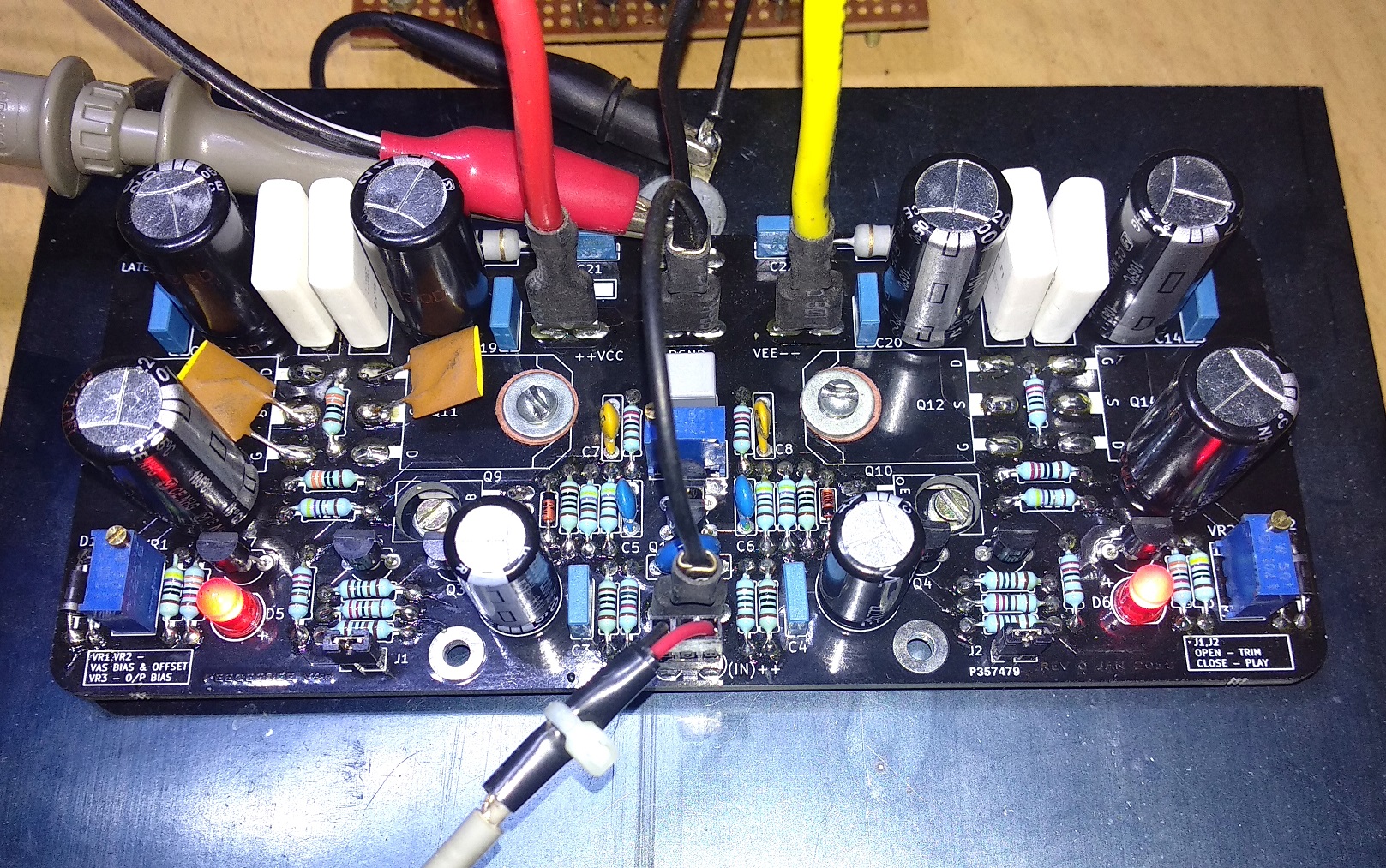

Since mid August I have been receiving a few reports of the amplifier setting up normally but running into oscillation and overheating as soon as the music volume is slightly increased. The sound is crackling and noisy with high current draw from power supply. No report of catastrophic failure, but it has been annoying the builders. Generally the suggested solution was to replace the 5W resistors with 2W ones, but even this didn't help a couple cases.
While I didn't face the same problem beforehand in my builds, recently after my last bunch of 5W resistors was exhausted I ordered another bunch. These were same value but from different manufacturer. And during tests was faced by the very same problem of oscillation with signal input.
I isolated the oscillation to the output section and tried whatever I could to make it go away. After a month of experiments, today evening it went away. 🙂

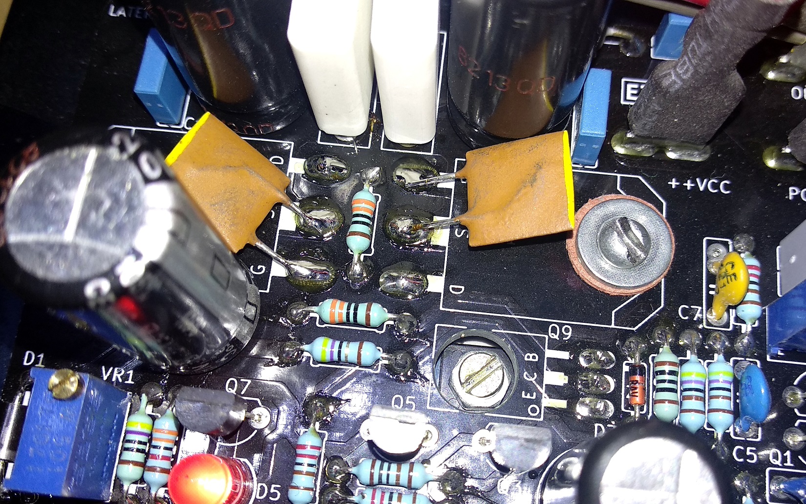

The culprit is the unequal gate-source capacitance of the N and P channel MOSFETs - the 2SK1058 has 600pF between gate and source pins while the 2SJ162 has 900pF.
Installed a 270pF 500V ceramic capacitor between the gate and source pins of each of the N MOSFETs (on the positive side of the board), and that's all. Now the amp is fully tame and calm. I cranked up the volume and gradually ran it right into clipping with music and no hint of oscillation in the scope. No crackle, no noise, no heat, just music, with the same 5W resistors that are very inductive.
I'm a bit embarassed because it's a very commonplace and effective trick. I wonder why it didn't struck me earlier 😱. I understand that in an otherwise well sounding amplifier this kind of problems are quite unwelcome and I apologize to everyone who faced it during their build. In the next bunch of V4H boards there will be accomodation for the two capacitors.

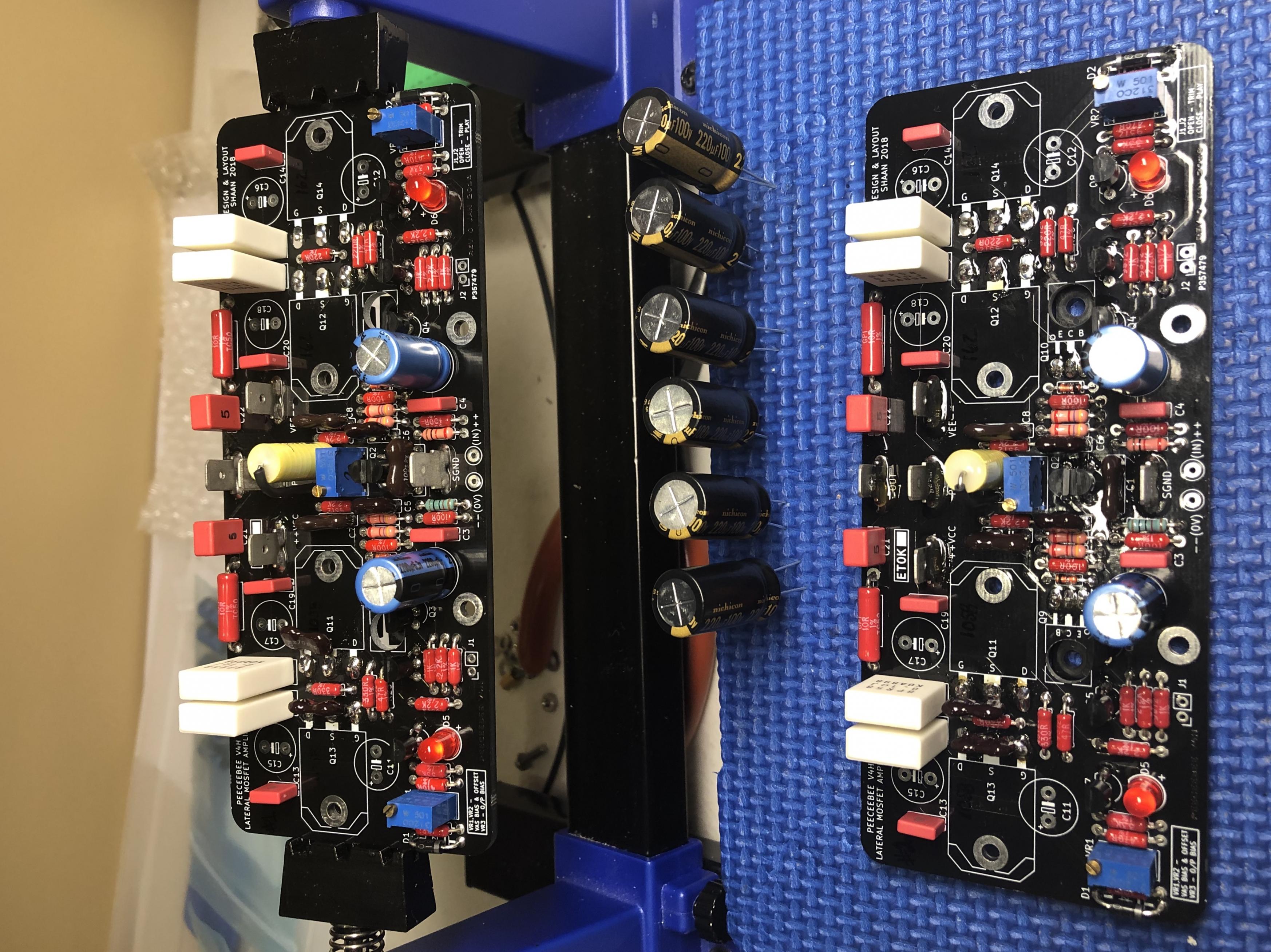

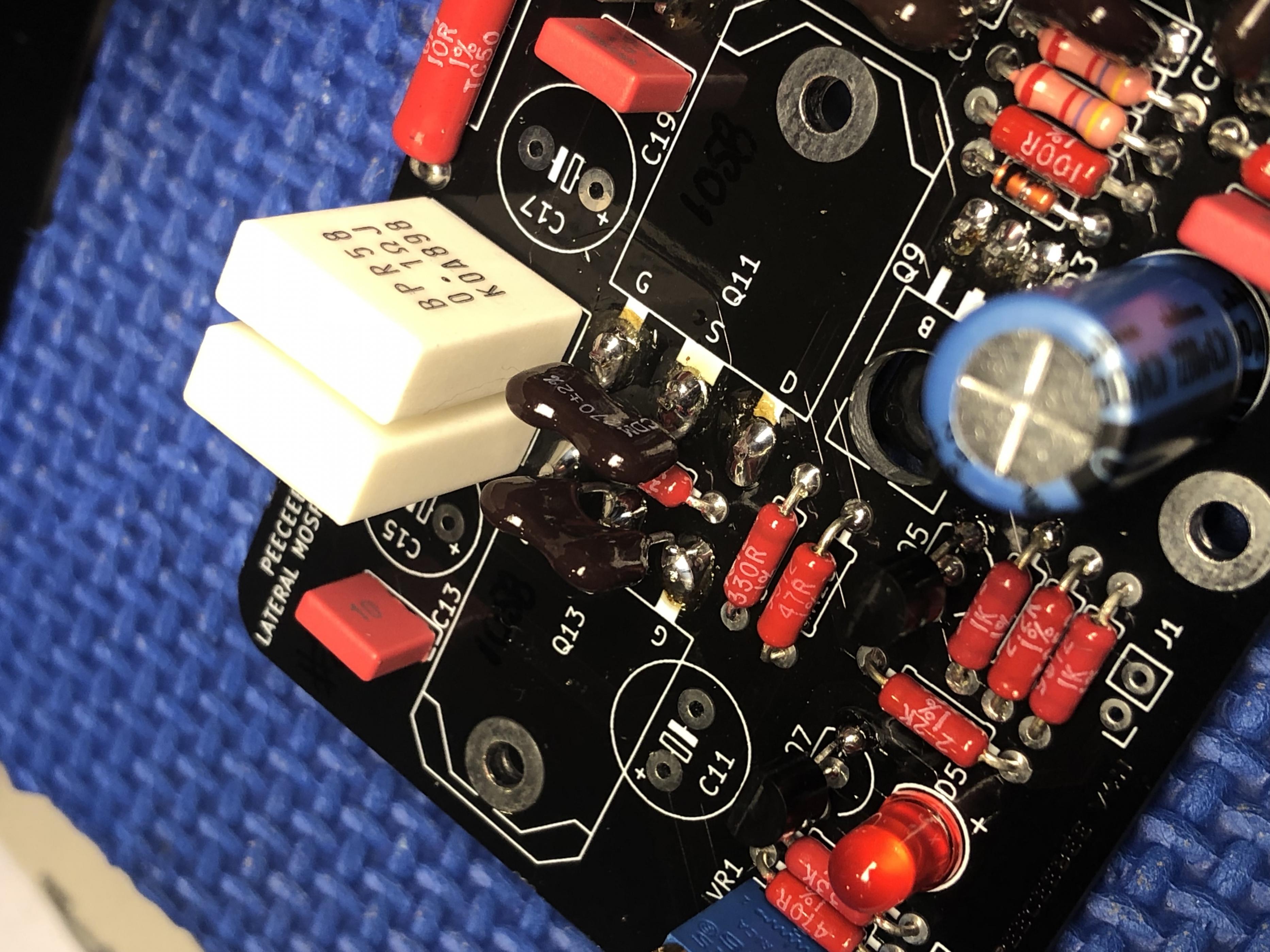

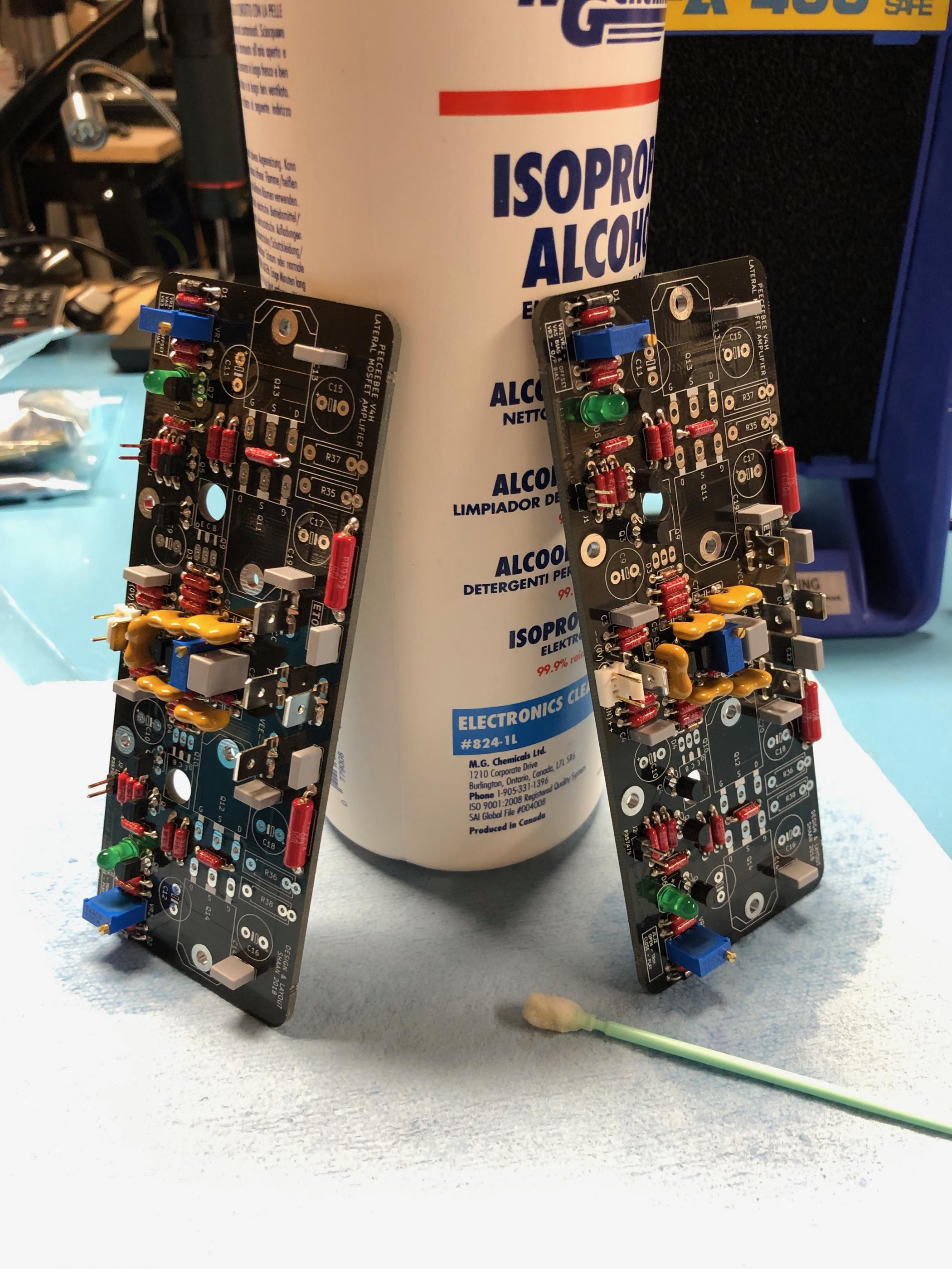

I finally got a bit of time to start the V4H amplifier boards🙂
Shaan,
From the start, I installed the 270pF caps to guard against potential oscillation like you had discussed.
