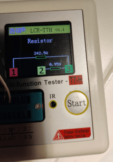

Shaan I need your help again. During my work to check the hfe of BC transistors I think I managed to destroy one channel.
First of all I had a solder bridge on Q10 and this lead to get some smoke from R24. I cleaned that bridge, replaced R24 and for few minuted I got few jumping milivolts on speaker output them R24 smoked again. Checked again, nothing looks bad but I get 30V DC on output and R24 gets very fast hot and smoking.
How to start troubleshooting? I would appreciate some help.

Hi Adrian.
It seems like the P MOSFET's gate terminal was overloaded by the solder bridge, which would mean the mosfet is dead. Please check continuity between each mosfet terminal and output terminal with power removed, red probe to output terminal. Pin 1 should show open circuit, pin 2 should show short circuit, pin 3 should show a few hundred ohms.Happy holidays everyone and a great new year.

Thanks for your advice Shaan. Still not clear if my j162 is broken but I observed it is impossible to buy a new one from the reputed dealers. Should I try my luck on ebay? I always avoid to buy semis from China but I see no alternative.
Using a multitester I checked Q4, Q10 and Q12 and all seem to be ok. I would appreciate some directions to troubleshoot.
Yeah, it looks like Q11 died and I discovered is a Exicon ECX10N20. Maybe I should replace both Q11,Q12? Anyone in Europe have a pair for sale?
