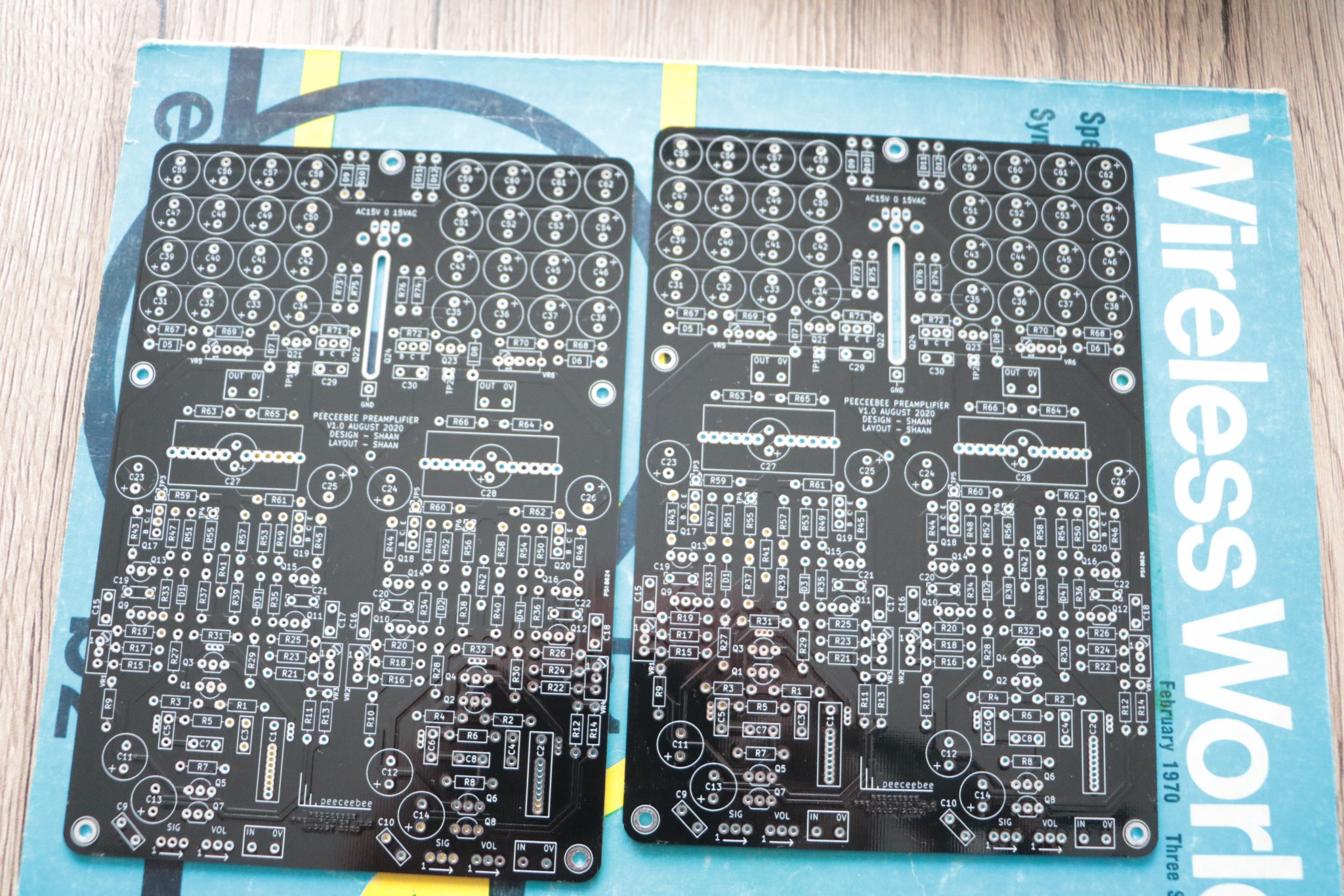

Hello Shaan,
Both boards arrived today. Everything is in order. Thank you very much !
