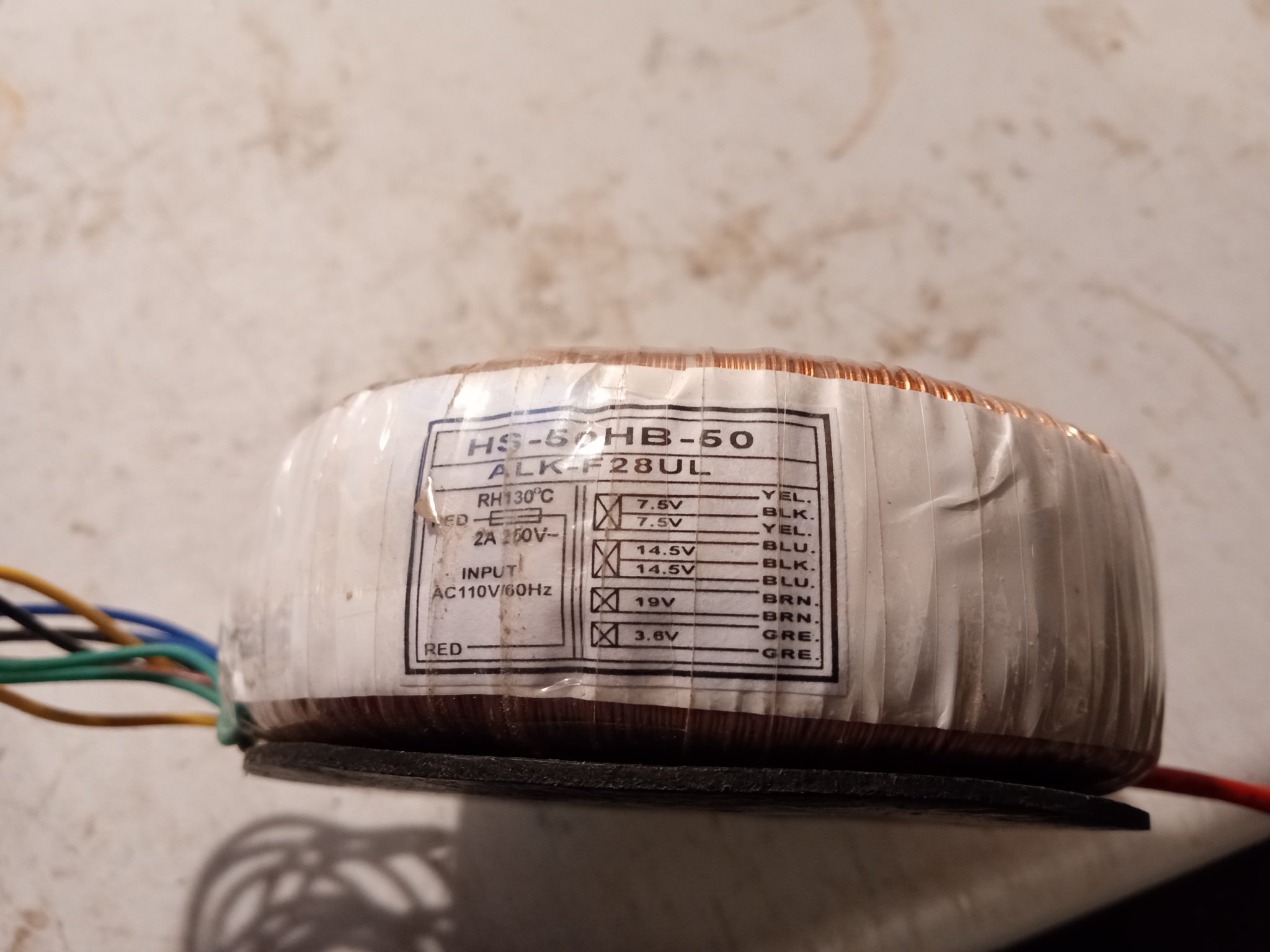

I am wondering if this Tx is OK for this preamp. I measured the blue-black-blue unloaded and got 16.2V for each blue-black and 32.5V total. Specs say 2A/250V as in the pic attached.

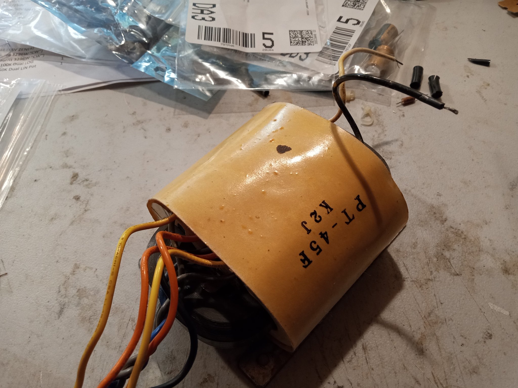

Also have an Rcore type, but the yellow V's are 28V, the orange V's are 20V, and the grey V's are 35V. So the 20V are a bit high for this. I will probably be able to use in another preamp or power amp. See pic attached.

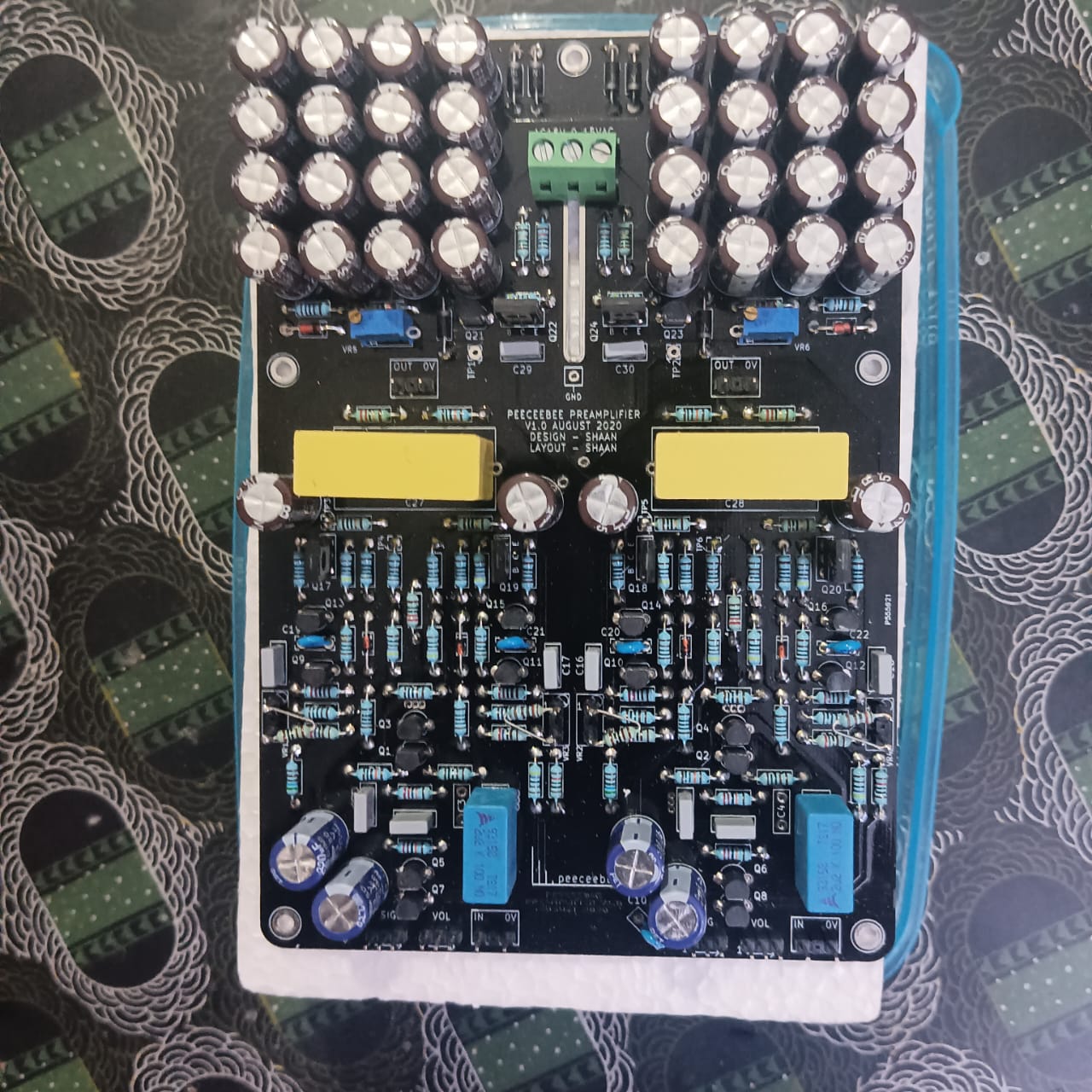

@shaan - do we have anymore PCB's left? Appreciate if you can message me the details directly
One PCB left from last batch. New batch will be printed next month.

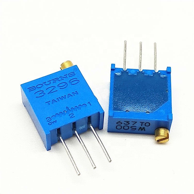

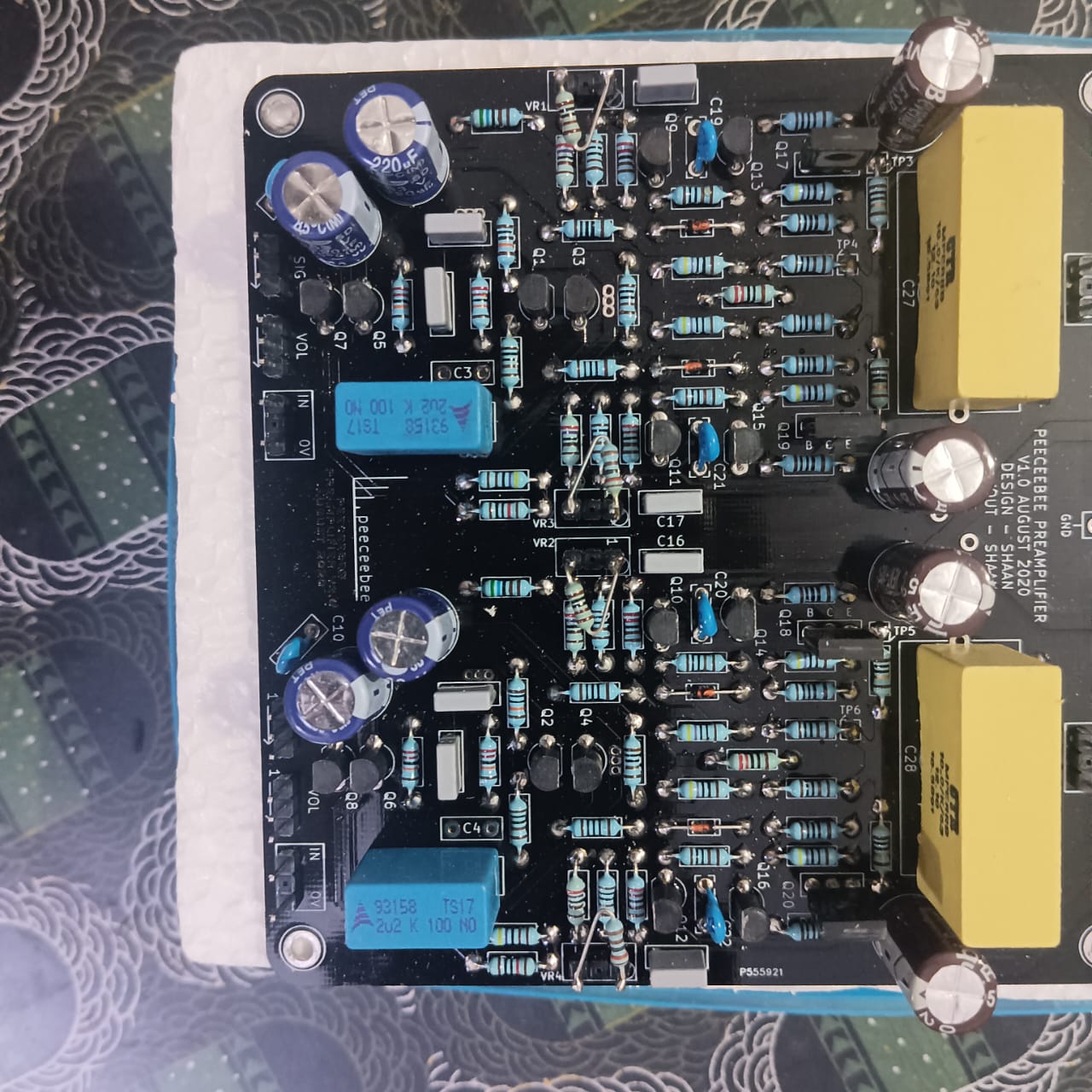

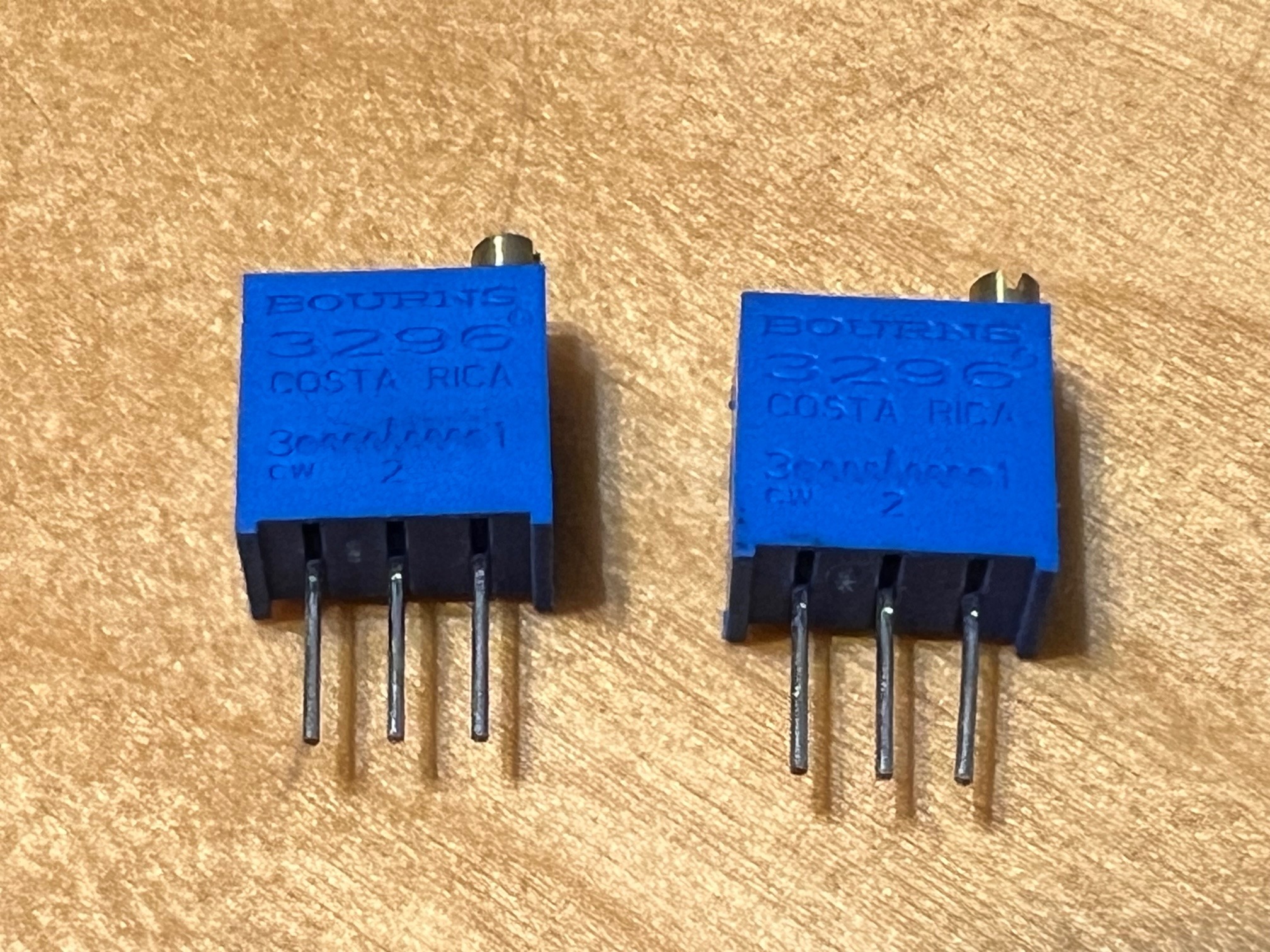

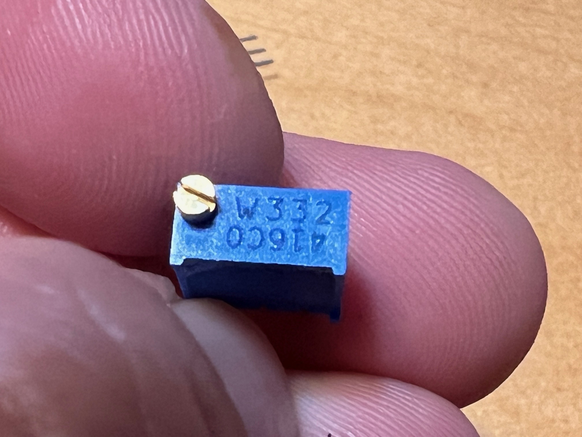

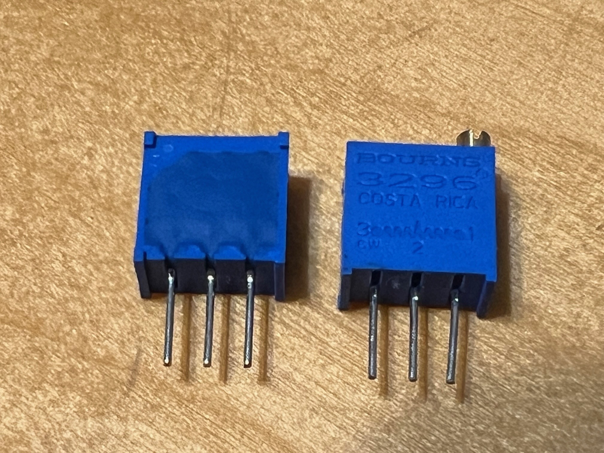

I got a Pre module from Shaan with resisters in VR1 to VR4 instead of trimmers without any note....
The trimmers I got were all fakes and caused crackling/static noise within a month of usage. So I measured which value give the required bias and install fixed resistors of nearesr value. Sorry for not telling you.
