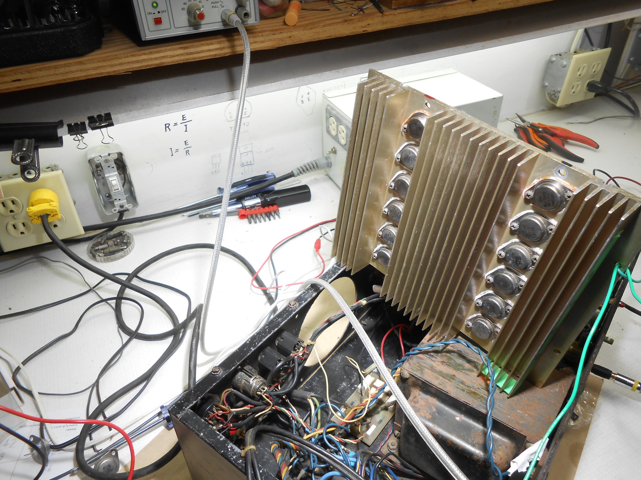

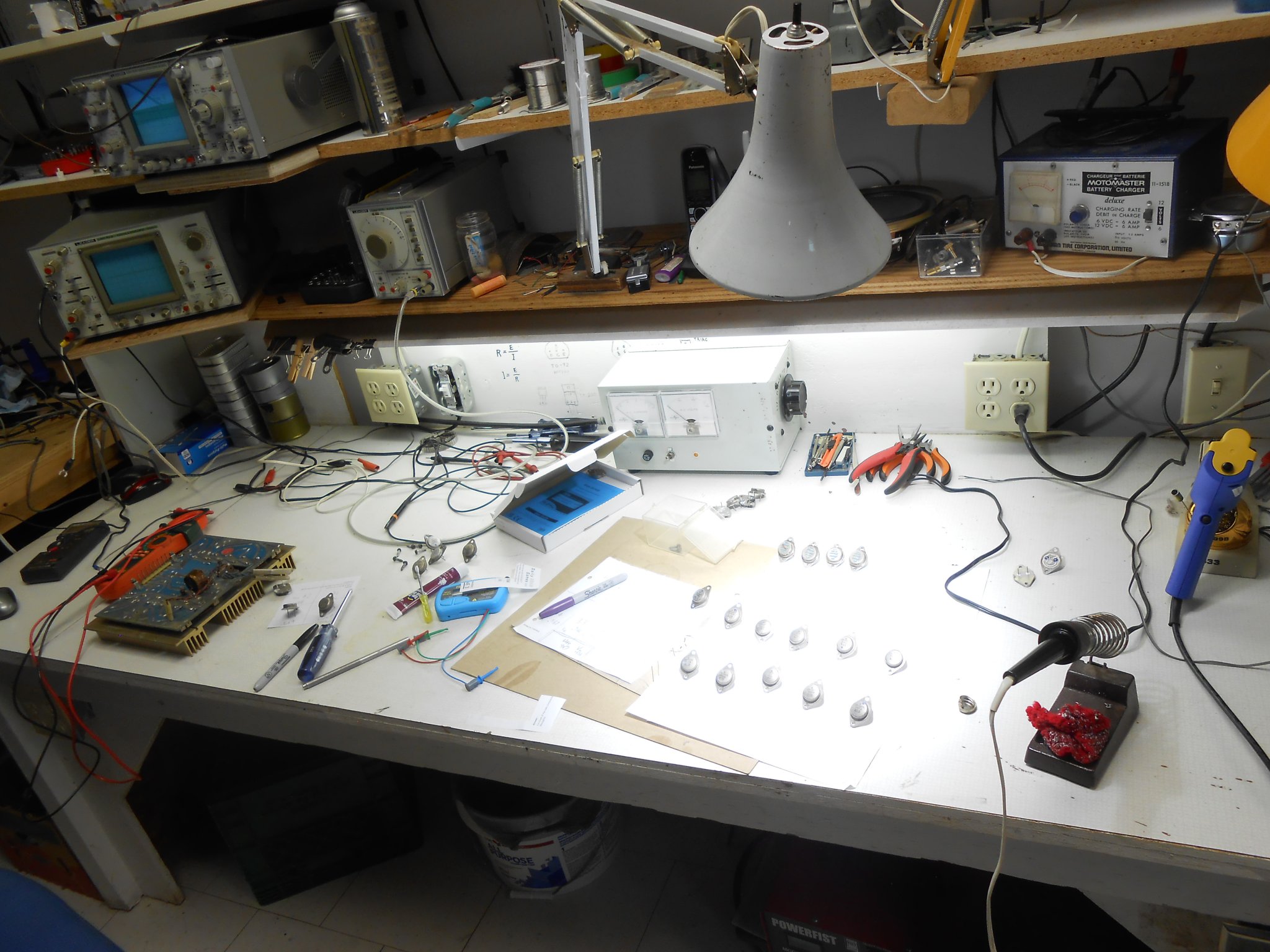

Merry Christmas! I'm still trying to put together the old CS800 on the cheap. I am matching Vbe as close as possible from some leftover transistors from other projects. I am trying to have each bank fitted with matching batch numbers. I also had a concern about matching the emitter resistors. Would it be an idea to place the transistors with the lowest Vbe with the highest measured emitter resistors? .... or have I got that backwards? Or does this not make any sense either way..

I suppose a lower vbe would benefit from more degeneration (higher R). But you are likely getting a better device to device match than anything they would have back in the 1980’s (Or 70’s).
Ive had amplifiers sitting a lot more than 3 years. Consider yourself lucky to have gotten back to it in 3.
Thanks wg_ski, I was hoping it was something like building a performance engine, put the biggest pistons in the biggest holes! I have heard that tolerances have improved over the years but my collection of outputs are not exactly spring chickens!
I am measuring Vbe with a Peak Atlas DCA55. I gather that this is a very low level test ( 2.5 mA ) but is it not better than nothing? Having measured the E resistors, could I check the current sharing by measuring V drop across them with the amp under load?

Any MJ2119x you might have are spring chickens compared to anything that was in use when the CS800 was developed. I still have a handful left from 1990, when I got half a tray of each from the sample program before they showed up in the Newark catalog. Being affiliated with a university had its perks.
I match output transistor vbe with the diode function on my DMM. Low current is more indicative of actual “diode” behavior. At high base currents, the parasitic resistance dominates (IV characteristic goes linear, and far exceeds the diode drop). You tend to get a better and better match at very high current because of the parasitic resistances (and the intentional sand box Re). Altogether different types of transistor have different values of those internal resistances which throw things off if you parallel them. That’s why you can’t mix old and new types, or one of the old RCA’s with Motorolas. Two random 2119x will generally be good enough, but out of the same batch the idle bias will match as well. If you put one new 21194 in with a batch of the old Moto selected 2N3773 (SJ6343) or RCA1B05(even worse), the higher gain larger die 21194 will hog current. It won’t take ALL the current, but enough that it will be the early failure.
Thanks again, wg_ski. That is interesting and helpful. So if I understand you correctly; the transistor's internal resistance helps with current sharing at higher levels.
I also gather that the Vbe measurements from the Peak Atlas tester at low levels are a reasonable method of matching (?).
In this particular low budget rebuild, I am planning to use all TP9054's in one channel, MJ15024's in the other. I do not have enough of each batch number to fill a bank of five, but each bank will have closest matching Vbe.
BTW, is there a percentage range of Vbe that would be considered a good match? In the amp channel with TP9054's; the neg bank measured from 0.570 V to 0.576 V. The pos bank varies from 0.561 V to 0.570 V Is this good/bad/ugly?

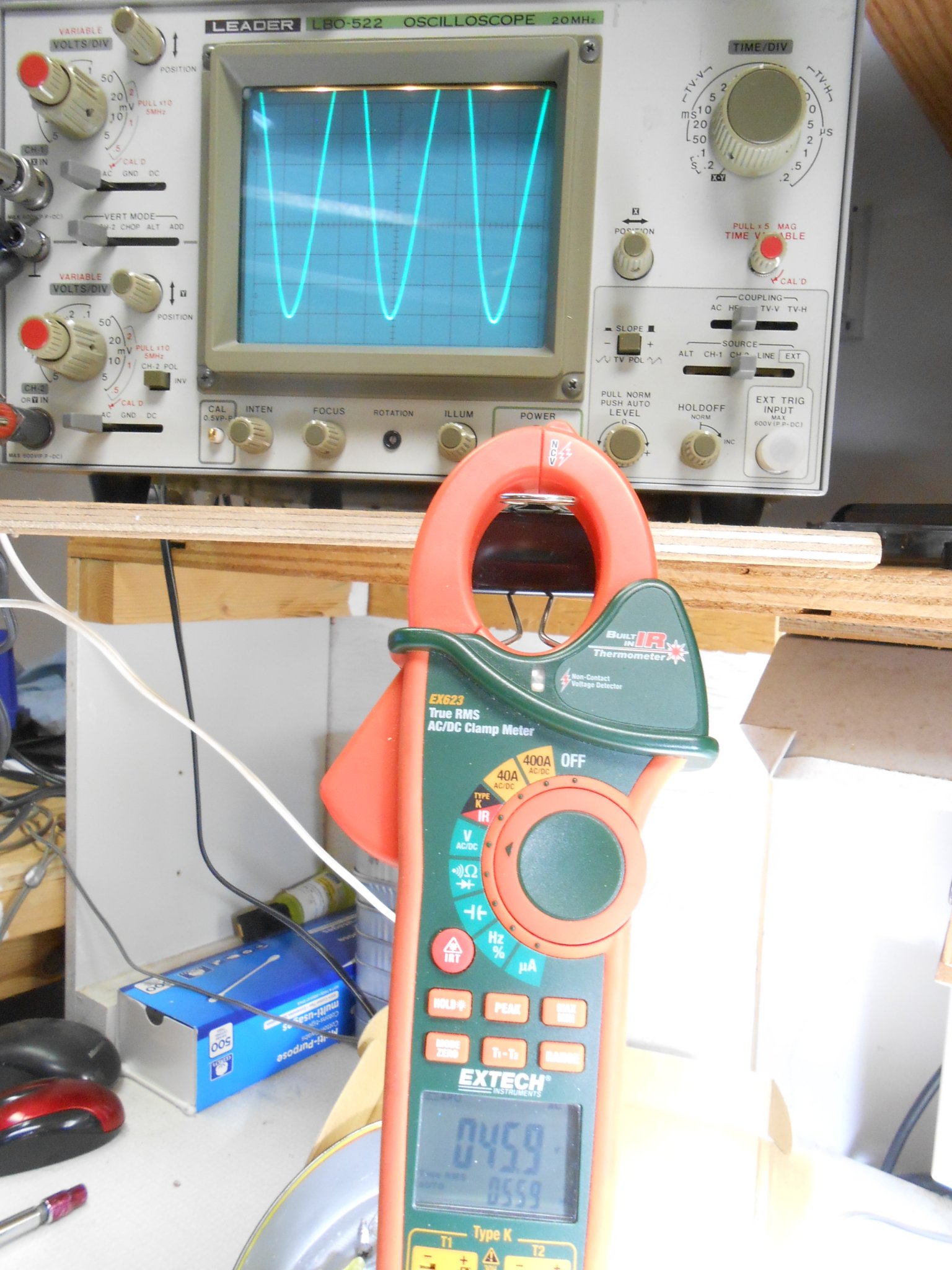

So there is one channel. 45.9 Volts into 8 ohms is about 263 Watts. Just to be 'OCD', would measuring the voltage across each Emitter resistor with the amp under load provide an indication of proper current sharing?

I like to see how well they drive up, too.
Using MJ15003 for drivers in that board? Did you check for Vceo first, or were they already known good at 160+ volts? Modern ones usually well over 200, but I always check anyway.
They did that with the original house numbered 2N3773’s (which you have one version of). I’m used to seeing the aluminum case SJ6343 but there were others. The top line in the part # (pretty blurry in the pics) ends in “0073”. Those might not have been tested and labeled exclusively for Peavey. Everybody and their dog used them - the MJ15024 was just coming out, and expensive as hell.
I used the MJ15003's as drivers because I had 4 of them handy. The Vceo is only 140 V. Is this not sufficient? Should this value be higher than the sum of the rail voltages?
Peavey suggested the MJ13330 which was a 20 Amp Ic and 200 V Vceo. I used the 15003's because they also had a 20 Amp Ic.
It was suggested to avoid used aluminum T03's because of a risk of failure due to mechanical fatigue caused by higher thermal expansion rates of the case. Could I use MJ15024's as drivers? or SJ6343's? (This is a budget rebuild and I would like to use what's at hand)
Thanks again for the help.
MJ13330 is a now-unobtainium switching transistor. The idea was to have the drivers with a higher fT. This is really unnecessary, as it will run fine with the same driver as output.
The 15003‘s 140 V rating is not really enough, but real ones will almost always go much higher. Lower SOA at 80 volts than the 3773 or 15024, but about 4X that of the 13330. The driver doesn’t need to be as rugged. But handling full voltage is necessary. Just put a 100k resistor in series with the collector-emitter, and check leakage current at full supply voltage. If you measure basically none (ie, nano amps), they‘re good to go. That’s how the original types were selected back in 1978. You could use 15024’s as drivers. If you have spare unmatched ones (say a couple with different batch #’s) use them for drivers.
The problem with aluminum TO-3’s is that they will eventually fail from thermal cycling even if never overloaded. If you’ve got an easy/cheap way to avoid them, do so. Especially used ones, which may have a lot of hours on them.
