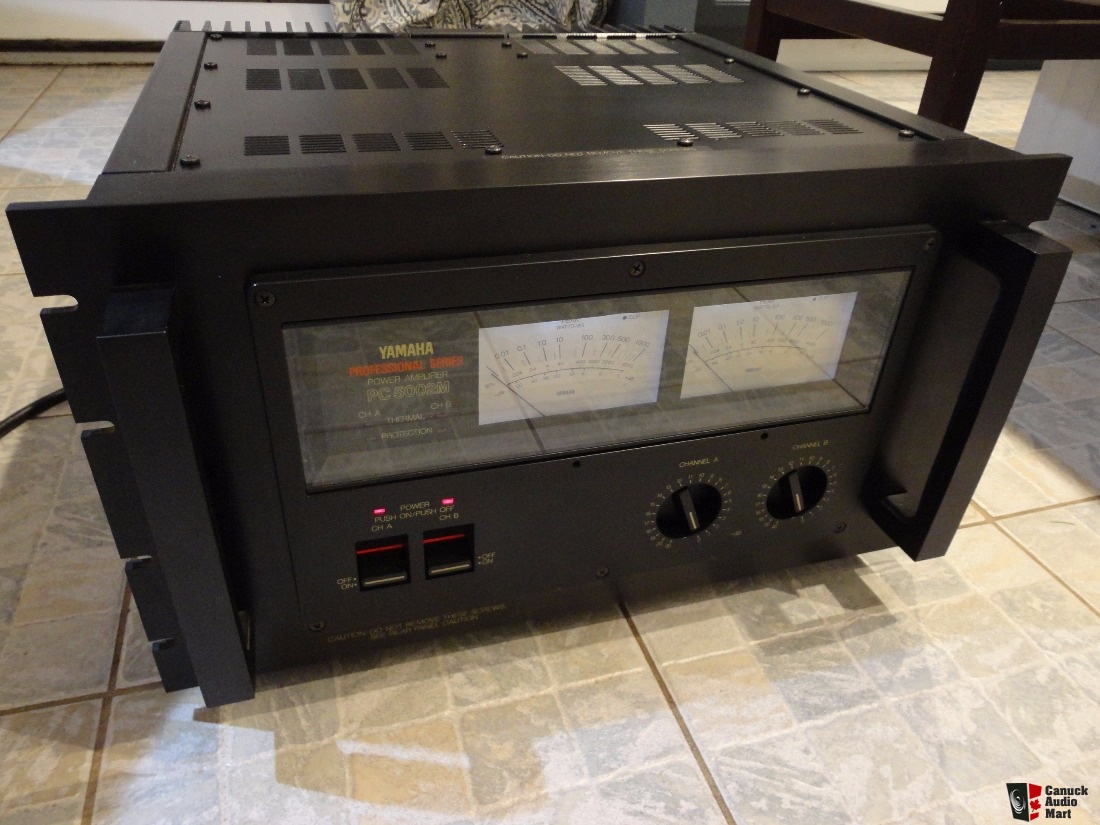

My (formerly) dream amplifier; the Yamaha PC5002M, as is turns out, has multiple power supply rails (class H, I assume). I am kicking myself for not picking up one of these, when I had the chance, back in the 90's. "Picking one up" may not be the correct phrase for this monster. Picture below from the net.
Most of these units seem to be in horrendous condition or incredibly priced these days. Are there any amplifiers with similar specs.. The distortion figure was fantastic (0.003%), surely there must be some other amps out there, attainable without getting another mortgage....still might have to hide the Visa bill from the wife!
The good news is that the rest of the mods to the CS800 are relatively cheap. Replace all the little electrolytics and get some lower noise op amps. You could also alter the gain structure a bit - reducing the gain of the power stage and increasing it in the front end. This will further reduce noise. You may need an new pair of soup can caps - just be on the lookout for a pair of 20,000 uf 100 volt caps on the surplus market. When you find some get four. A pair for this amp and a pair for the next.
Class H amps do have additional crossover distortion when the rail switches. In practical PA use it is inaudible. It can be heard with very pure tones and not a lot of spectral content masking it - but the lower the frequency the less audible because the feedback can correct it. Class G is cleaner, but requires twice as many output transistors. If you want a truly hi fi multi rail amp this would be the way to go. Power draw and efficiency are the same but it costs more to build.

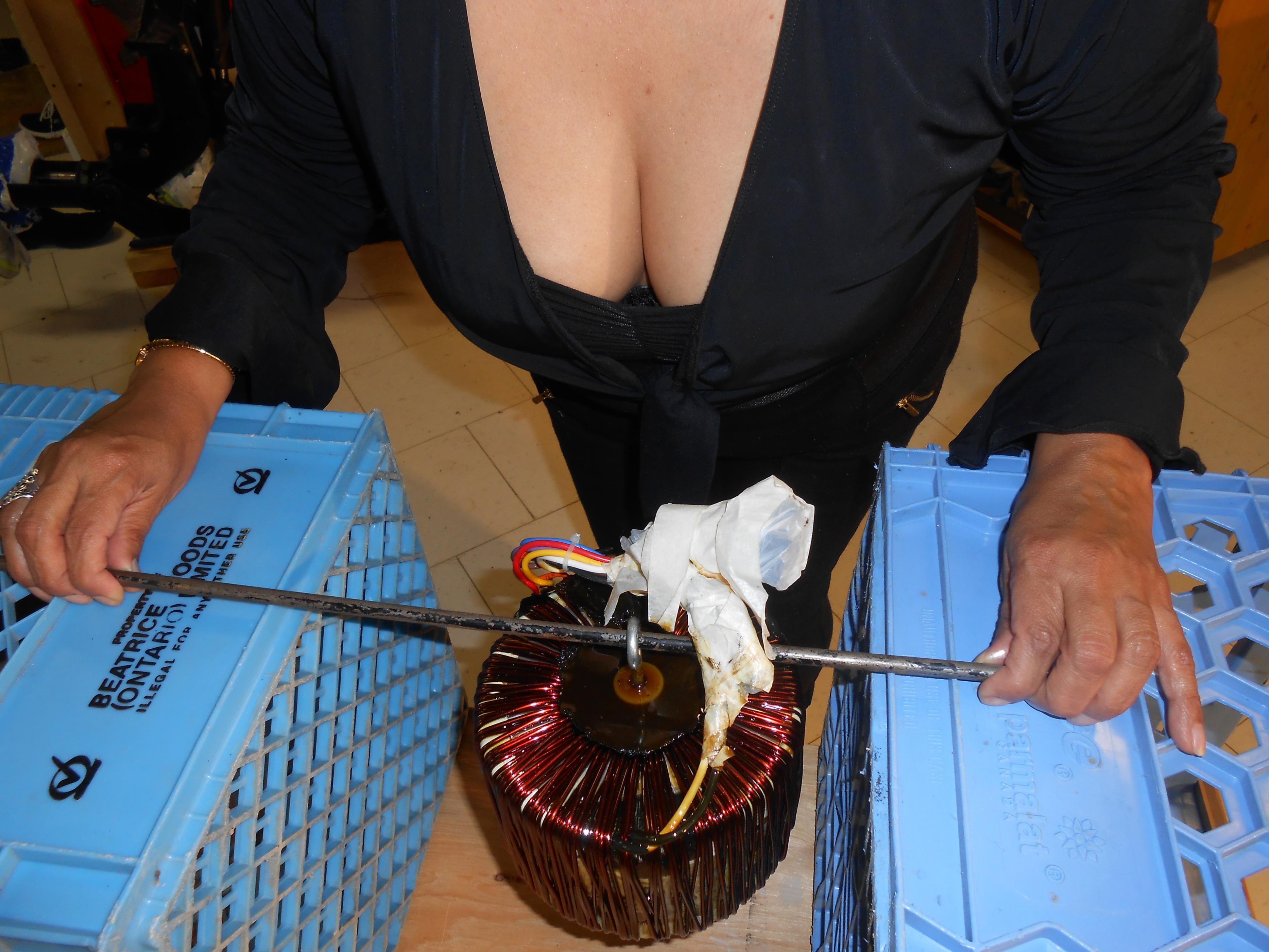

Attached is the 35 lb toroid from my Crest CA-18
