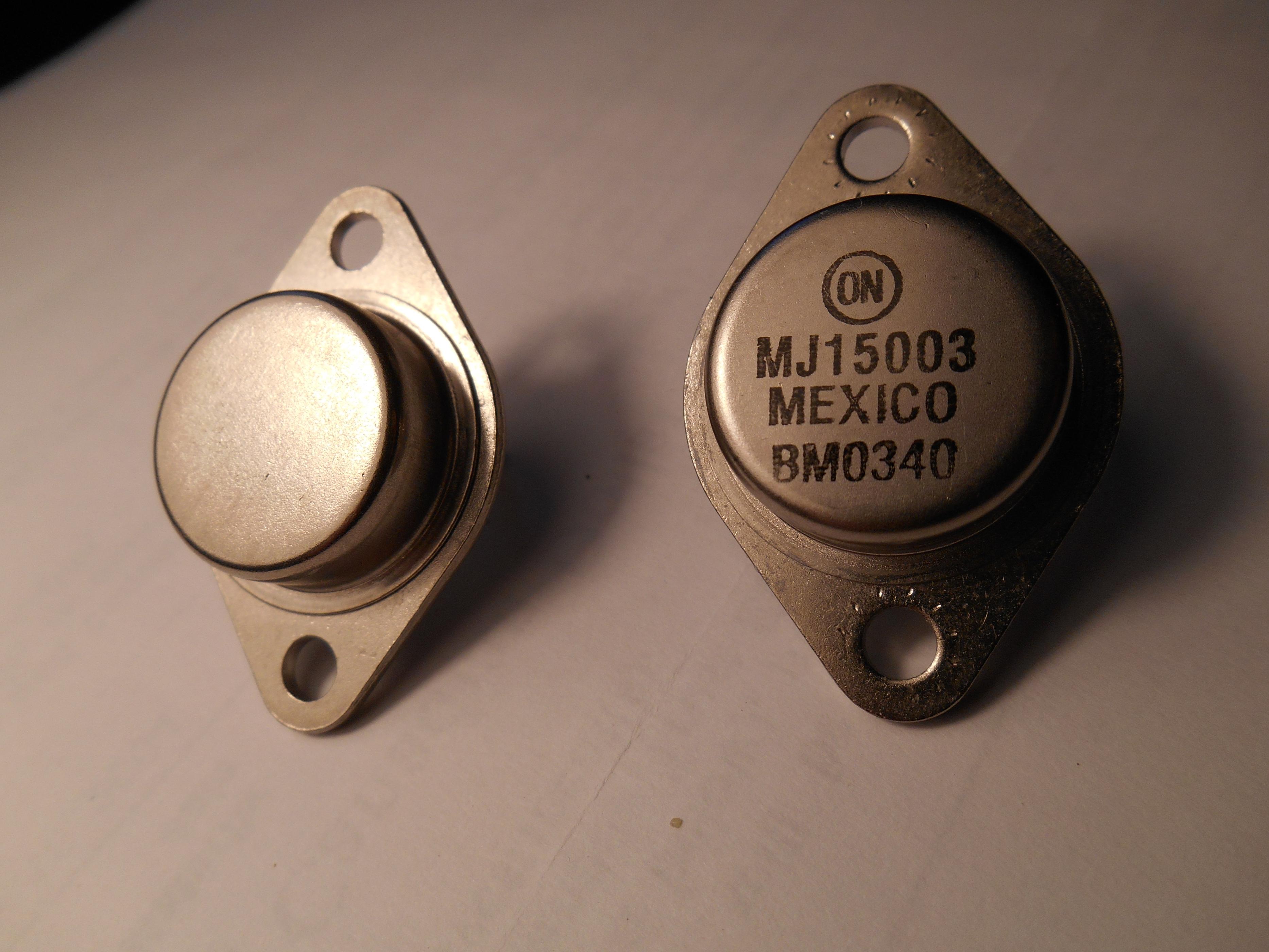

Ok, pop the cover, let’s see what’s inside. If it doesn’t even pass the acetone test you have nothing to lose.
Unless of course you want to build an amp in which those transistors will actually work. It can be done, just requires more of them in series-parallel. Assuming you can get a rough match in groups of three or four.
I’d trust the old ones more at this point. Or even those 15003 if measured Vceo is above 200V. The modern 2N3773 is a 15003 die tested to a different spec, and most of them are good for over 200V. I’m sure the original house numbered PV part (SJ43 something or other) was just a selected 2N3773 because the 15024 hadnt beeen invented yet and Motorola didn’t make the 2N6259.
Which brings me to something funny/fishy I saw on the Newark site. Pull up the data sheet for the Multicomp 2N6259, and you get what is clearly an MJ15024 data sheet. The $64,000 question is what do you get, and is it any good.

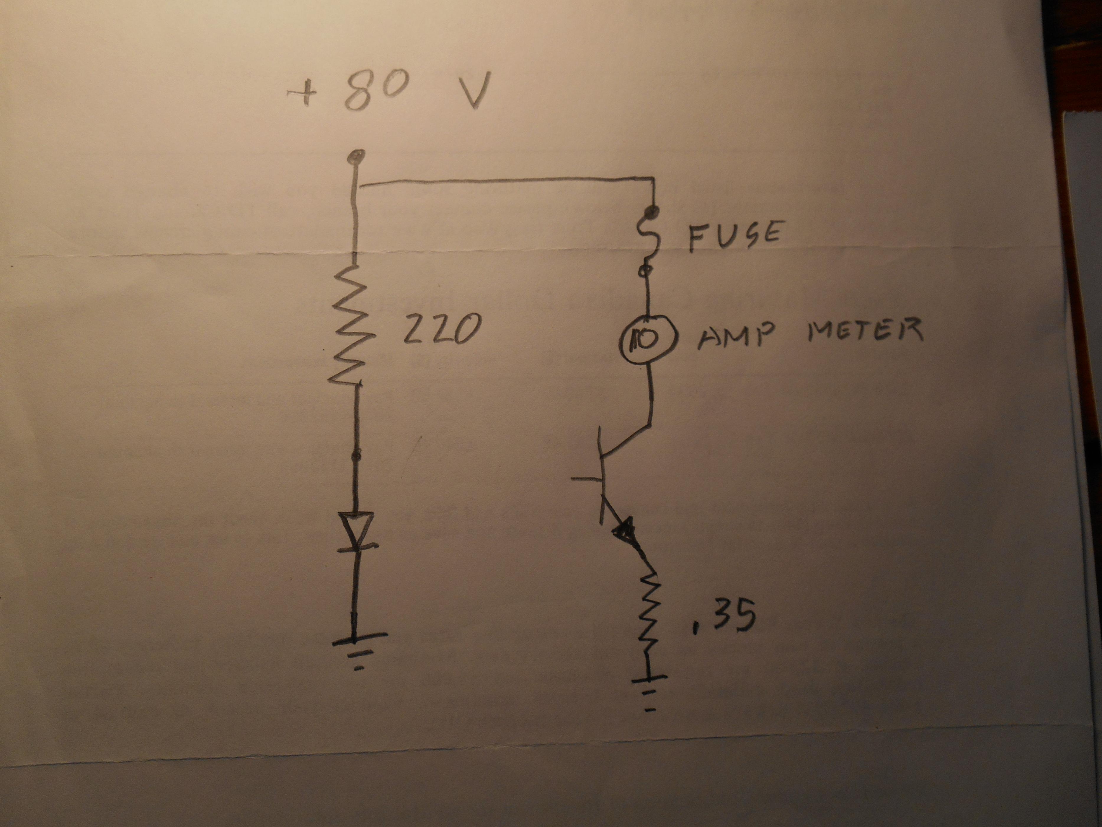

2 a ccs -
on a npn part, acquire a 220 ohm resistor, a common diode, a .35 ohm 1 watt or more resistor. Put 220 ohm series diode non-line, connect diode line to - PS, connect 220 ohm to + supply . connect MJ21196/4 emiitter to .35 ohm resistor, other end to - supply. connect MJ21196/4 collector through 10 a socket on dvm to + supply.
for 80 v soa test at 2 amps, use 80 v supply. Like the cs800. If you put a 4 a fuse in between the meter & the + supply you will blow it instead of the 10 a fuse in the meter if you short something.
when the DUT (device under test) leaks enough current to flow 2 amps, the emitter resistor drops .7 v and equals the diode drop. So the base stops cramming more current in the DUT.

Is this the test circuit you were describing? Have I interpreted it correctly? I was wondering if a larger resistor in place of the 220 ohm would work? At 80 Volts, this would dissipate about 30 Watts.
Is the base connected to the junction of the 220 ohm resistor and the diode?

Yes, you have interpreted the circuit correctly, but the problem is that with such a low voltage across Re it is very difficult to get the target current correct without jacking around with it. Jacking around with it is how accidents happen.
yeah, forgot to connect top of diode to base of transistor.
Since Vbe of a real MJ21196 is lower than 0.7, you may have to put a pot across the diode to get Ic up to 2 amps.
I'd put a switch on the power supply to limit test time to 1 sec like the soa chart.

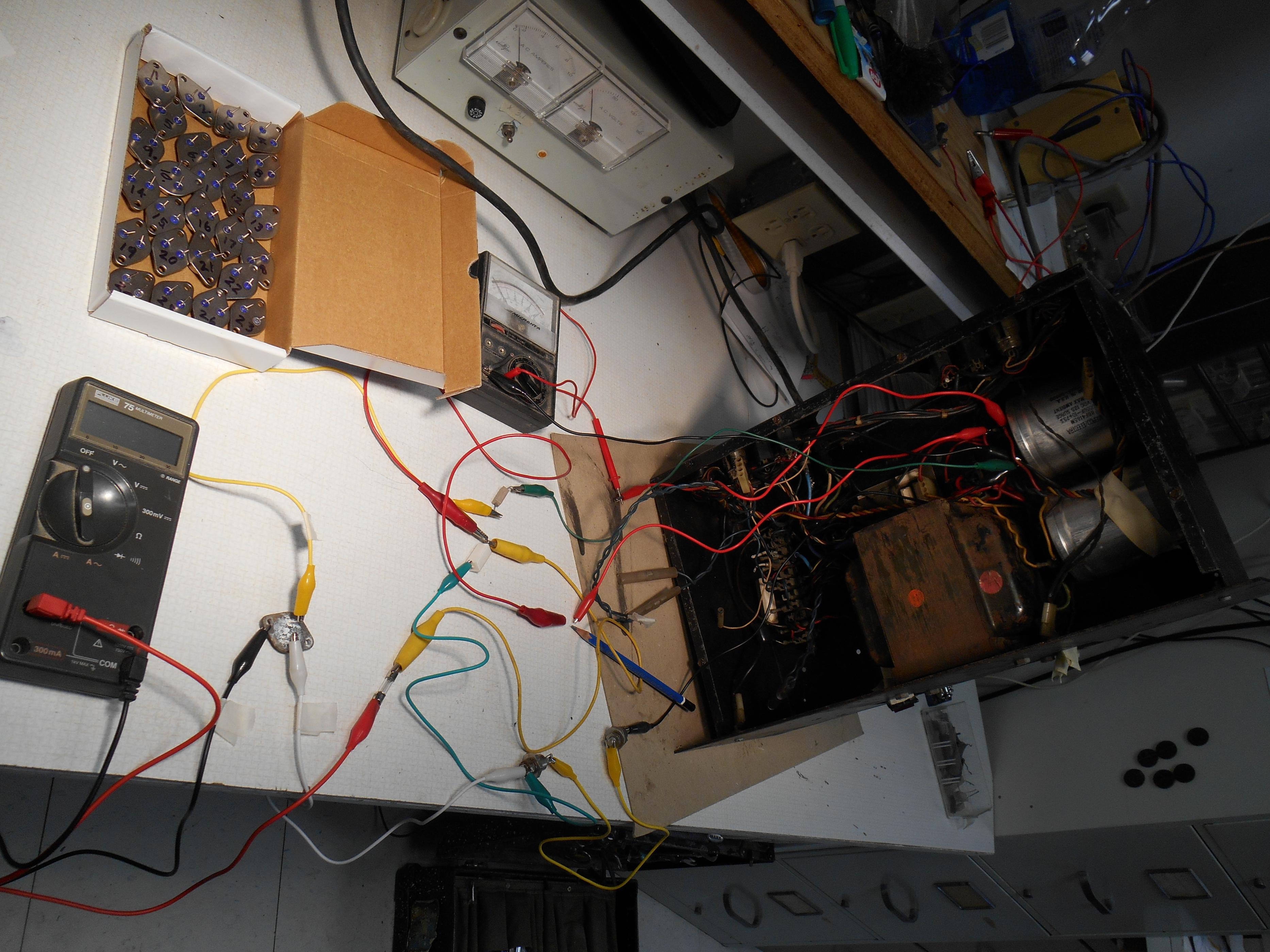

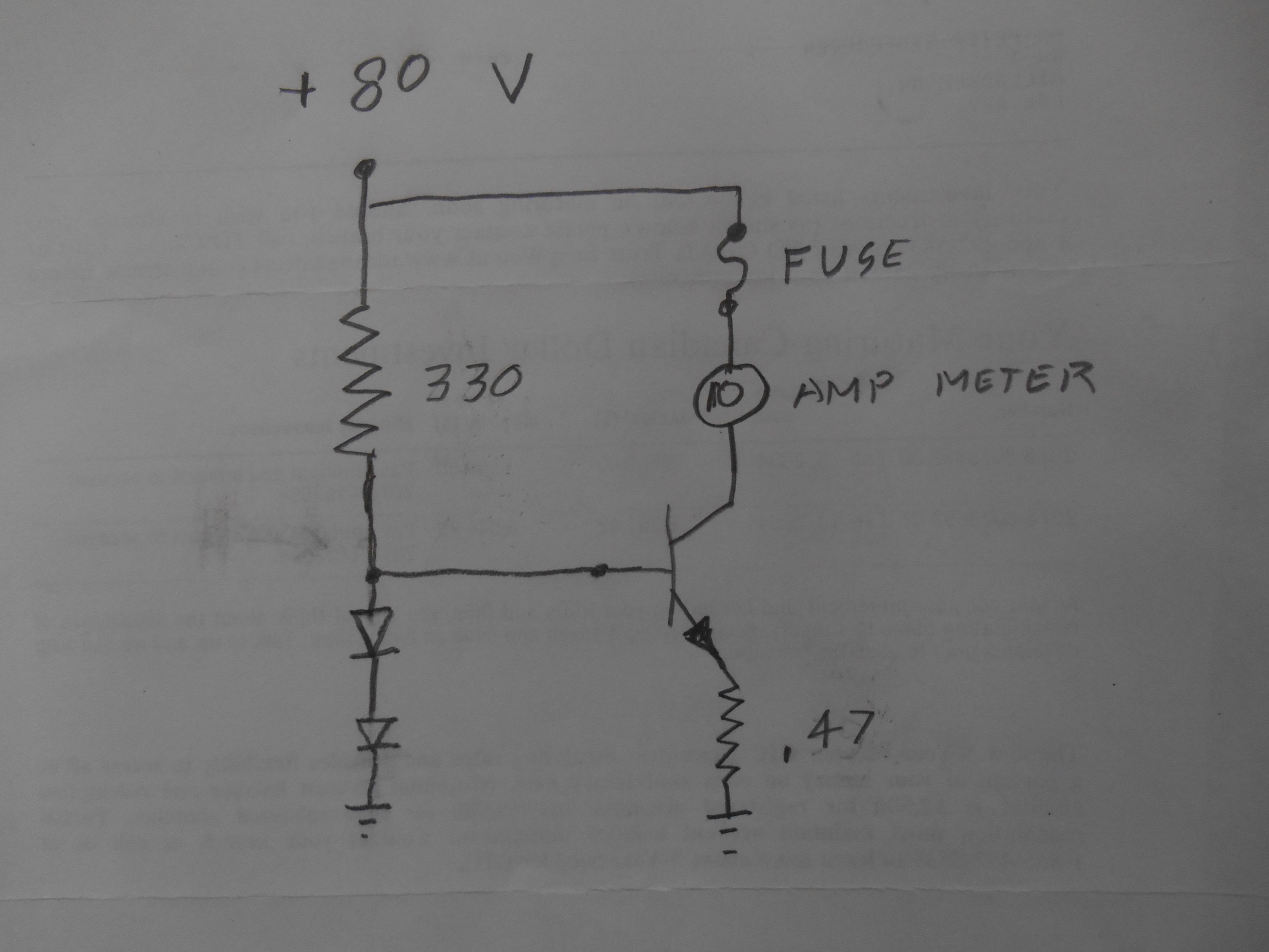

Good Morning Folks, A Test Circuit is Born--maybe!
Against good advice, I have been 'jacking around'. I used a variac and slowly raised the B+ voltage in increments. I used a switch (the 2 red alligator clips pointed to by the pencil) to keep the 'on' time just long enough to get a current reading on the Fluke meter. With the original circuit, I found very little increase in Ic, as Vbe increased. I assumed (and that's always dangerous) that with a .47 ohm emitter resistor and only one diode ( .7 V on the base ), the DUT was still cut off. With 2 diodes in series, Ic was .67 Amp at approx 75 V.
BTW; I Vbe tested all the 'fake' transistors and found them mostly around .610 to .622 V, (a couple were outside this) I would have no problem finding banks of five, that are matched to 1%). As mentioned, 2 series diodes got Ic to .67 A. What about 3 or 4 (or more diodes) to get Ic to 2 amps.

Mount a TO3 socket on a heat sink for these tests. While a transistor will take a 1 second test without any one (that’s how they are tested at the factory), the chances of something coming loose and shorting out are pretty high.
2 amps at 80 volts is a tough test, but MJ15024 is supposed to be able to take it. If Tj can be kept below 200C. At that power level that would be a case temp of about 85C. 1 second without a heat sink probably doesnt heat it more than that, but if you accidentally left it on 10 seconds all bets are off. If you used a heat sink in ice water you could leave it running till the water starts to heat up.
Even if these units turn out to be fakes or copies, you may very well have gotten a good batch (as in useable in a CS800). It will be interesting to see of they pass the full SOA test. The fake batch of 15024’s I had were working just fine in the application - six in series/parallel on +/-125V rails with an 8 ohm load without failing. What bothered me was the unequal current sharing due to the wildly different Vbe - much worse variance than your batch. Long term that would have been an issue.
If you want more test current, leave 2 diodes but decrease emitter resistance. Definitely use a heat sink. Foot long piece of window frame from the garbage, anyway. Use Be grease.

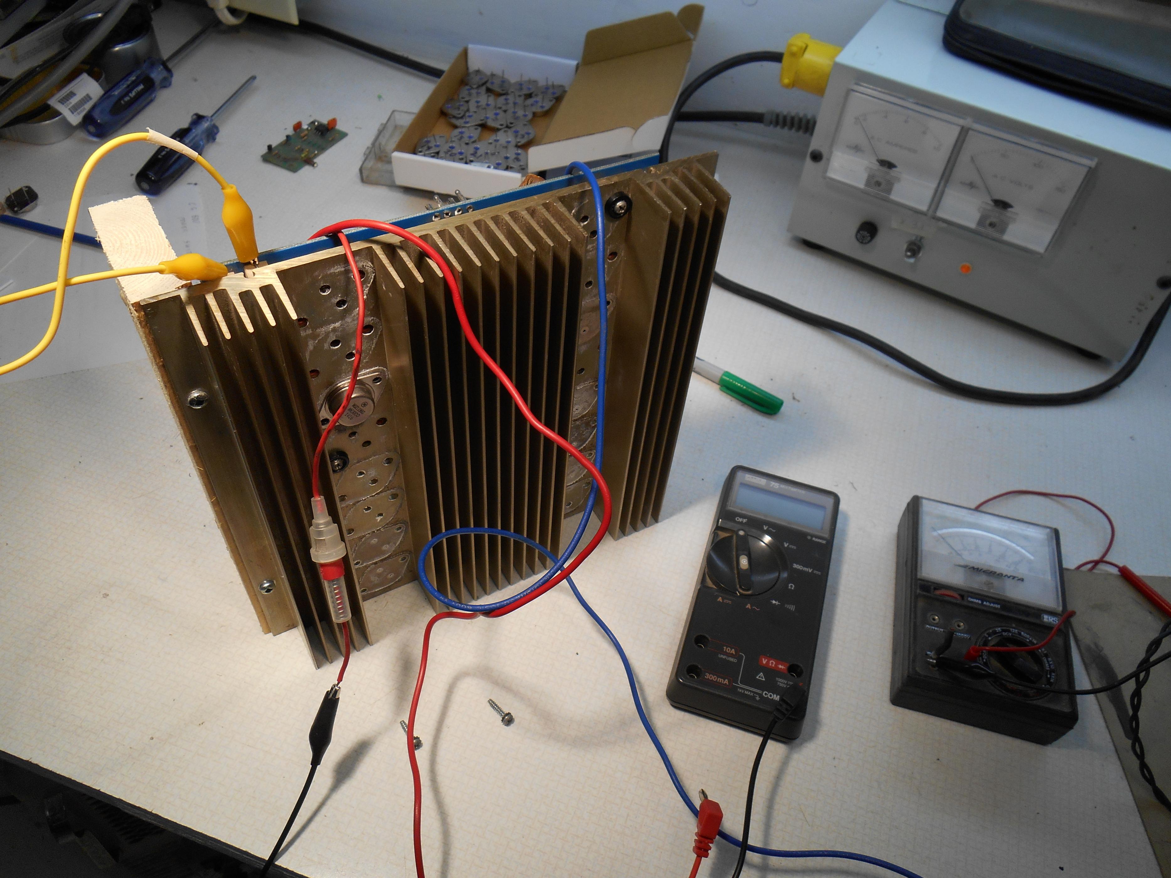

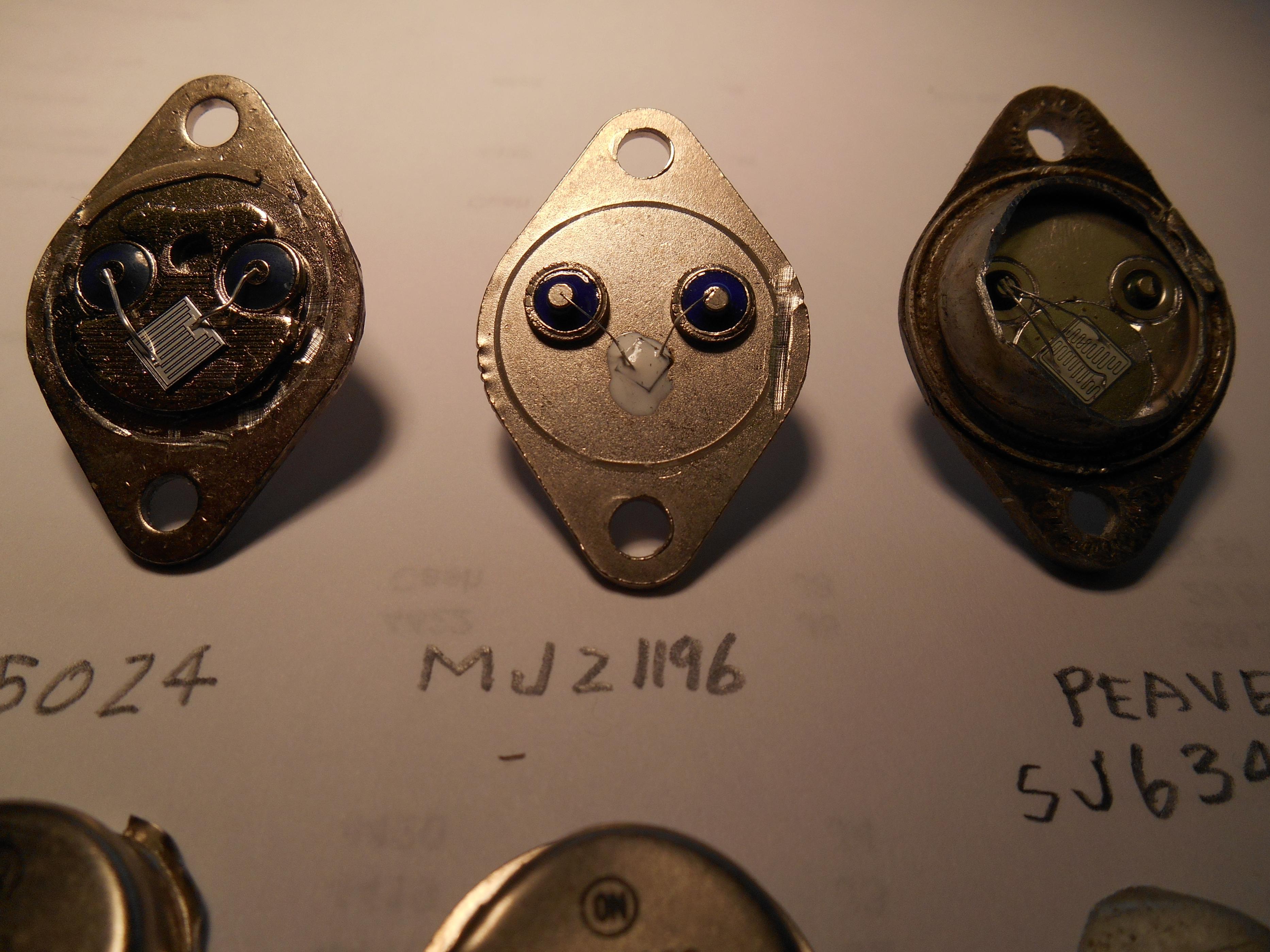

Well, I guess I'll be buying twice! I took the good advice and built a test rig from a CS400 heatsink and power pcb. With some 'jacking around', I found that I could get 0.6 amp at 80 V with one diode and 0.165 ohms of emitter resistance (two .33 resistors in parallel). I was using an aluminum Peavey transistor as a guinea pig.
The moment of truth; the MJ21196 was installed---curent went up to about 1.5 amps, and then POP! Here is the test rig
Notice how much easier it was to take the lid off the fake. I doubt the seal is even hermetic like it is supposed to be (hence the die-coat compound). And another suspicion confirmed - that SJ6343 is a 2N3773 (or at the very least a very close relative).
