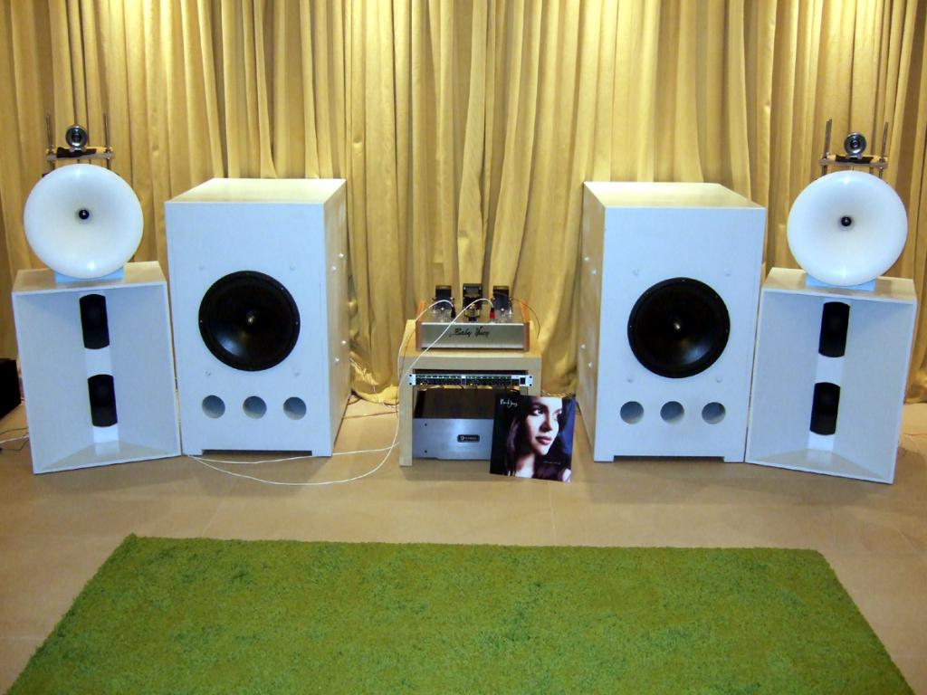

Keep getting distracted by this monstrosity
