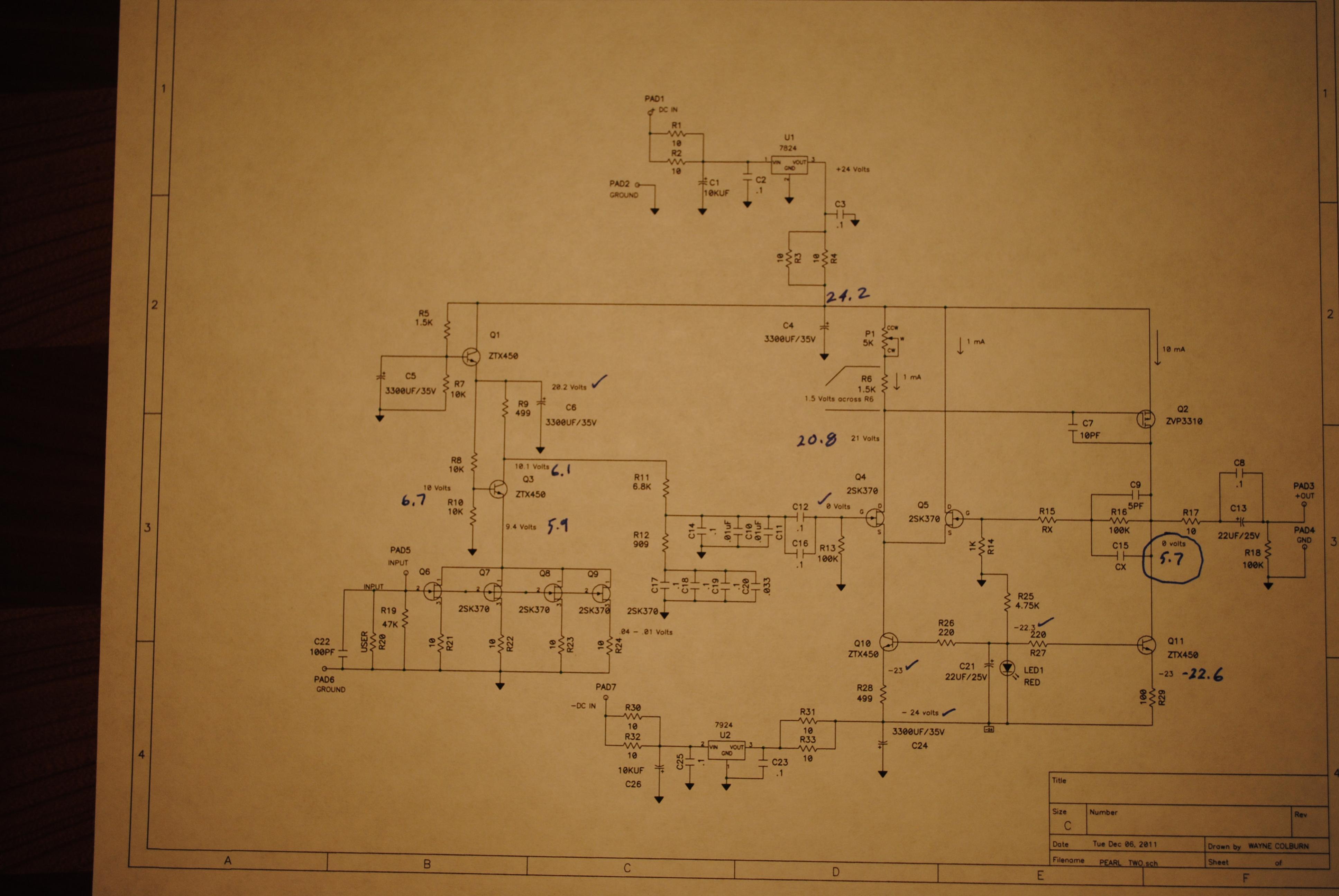

Jfet idss are too high, robbing folded cascode net of available current? Just guessing though.
As note, the working channel measurements are very similar except I can adjust to 0 at the output.

I have guess, but nothing more. As I said, i want to see the answer ont his one. It will be learning experience for me as well. sorry I couldnt help.
Close. 1.6-1.7 if remember correctly.
Try 1K trimmer connected as rheostat instead of R28 and trim for 1.5V across R6 first. Then see again with P1. Your LED is higher than 1.7V Vf most probably.
Q3 is squashed for Vce in your annotated schematic measurements. Try 15-22 Ohm R21-24 to give it breath. Your input quartet IDSS is probably higher than in the original.
😀 Buzz stop seeing folds everywhere. Its a classic telescopic. Therefore the local capacitance multiplier aid bcs of low PSRR.
To get Vc > Vb > Ve around Q3 you can experiment with lowering R10. Try 6k8 or 4k7. My quad probably also has higher Idss than the original, I had to lower R10 to 4k7.
That's adapting to another bias point on the fets curve and to another gm total than original though.
After looking at Wayne's simplified version, I knew i was wrong, thats why i shut up. Now i have to go look up telescopic vs folded.😀 I love being dumb.
Folding the cascode its used in low PSU voltage capability op amps mainly for saving yet another junction threshold across.
and for few other things
