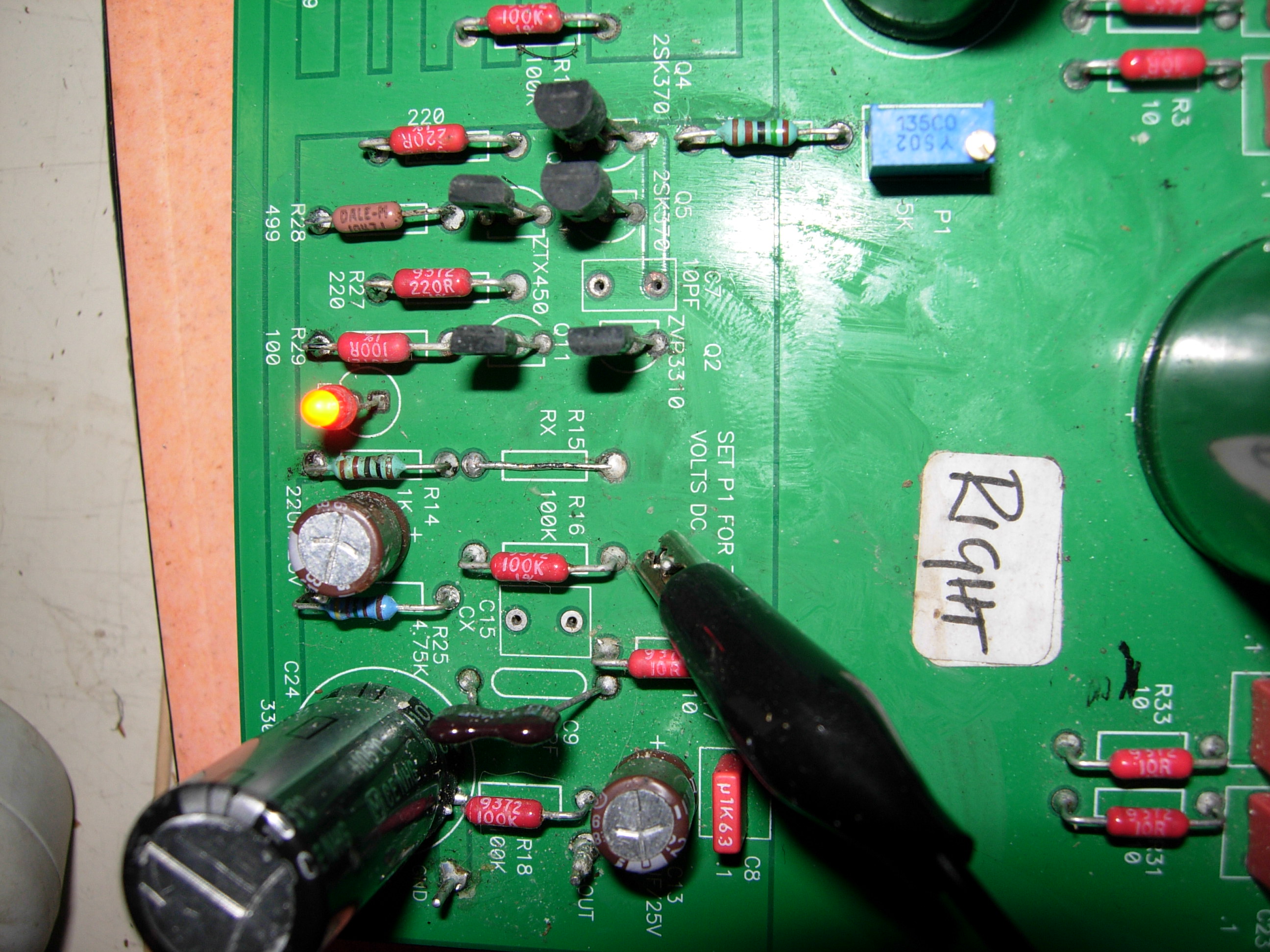

Rich - The circuit behaves like the potentiometer is the wrong value. Please would you verify that it is a 5 kohm potentiometer you put in. It might be worthwhile removing and testing it. Do you have a spare one ?
We want 0 v at the P1 test point...

Oh well... sorry about the trouble. Perhaps some pictures might give us a clue?
You are sure you cannot adjust the P1 test point to zero with the potentiometer?
The lowest that pad will go is 10 volts? Are you sure it is not -10 volts? It is a very sensitive adjustment. Quite easy to miss the 0 volt and overshoot into the negatives... Note that +/- 0.1 V would be close enough.
Pierre
good picture ..... but problem is that all solder joints looks older than I saw on some tube amps from yore time
in this moment I'm doubting that you didn't scorched even some passive part , besides active ones ........
I hate to say it, but it is also the way the pic looks unfortunately.
There's either a problem with soldering technique, flux and/or soldering station usage. Sometimes older stations iron endpoints do not work well with unleaded. Sometimes temp is set too high, unadequate to the flux used and it can nick some active and even passive parts. Are you sure you do clean the iron end with a wet sponge or metallic equivalent between each solder point ? The endpoint should be perfectly clean and shiny between each solder point with no residue, black or even gold one. When I power up station, once temp is reached I always "clean" the endpoint by adding some fresh flux, and letting it burn for seconds before cleaning the endpoint perfectly with the wet sponge. Then my solder session can begin.
Could you post us pics of an other amp you made ? Do the joints also look like in the pic you just sent ?
Again, I hate to say. But some errors couldn't be corrected if the work is faulty.

The amp I made is on loan at the moment .... I use a wetting compound and clean the tip often . I use 380 C for most parts and 450 C for the ground plane parts .
I think I should strip the output stage and check all parts for failure . Use new parts where needed ....
I was told that I wasn't using enough heat , now I'm using too much LOL
I guess it must be rocket science after all .
Perhaps someone could recommend some products ... I have mentioned the products I use for your opinions in this thread.

Please try accordingly to your flux. For using my Cardas tri eutectic for 1st time I tested from 150°C by increments. I then settled on 330°C which is plain high. Instead of pushing the temp for ground planes connections, you'd better stay on the same temp & change the endpoint to take a bigger one, flat screwdriver model instead of ballpoint small, that fits small dense areas and tiny resistors.

I bought my soldering station second hand ... Its been serviced ,but the points are not brand new .... perhaps Santa will be kind 🙂 I use 1.5mm chisel
point that has seen better days ...

Trying to get the V to stay in the mV ....
Rich - how close can you get to 0 volt at the test point? How much does the measurement fluctuate?
around 100 mv peak .Just watching it now .... from -15 mV to 100 mv
That's good ! I don't get any better than this.
Now THE question... What is the voltage across R6?
-2.36 v across R6 . I have got the P1 test Voltage down to +/- 50 mV .
Gate @ Q4 and 5 are still 10 mV apart ... ? Also when I turn it on I get + rail voltage .but it does go down . I'll check it again in the morning .
a grateful , Rich
Let's see... From previous measurements there are 3 mA total flowing through the differential. We now see 1.6 mA through Q4. This leaves 1.4 mA through Q5. Close enough. P1 test point adjusted to 0 volt. Good. Current through R29 tested good before.
Sir, I believe you have a fully functional Pearl 2 channel. Congratulations.

That's very good news. It's about optimal. Your previous measurements about P1 would let us think there was another problem.
