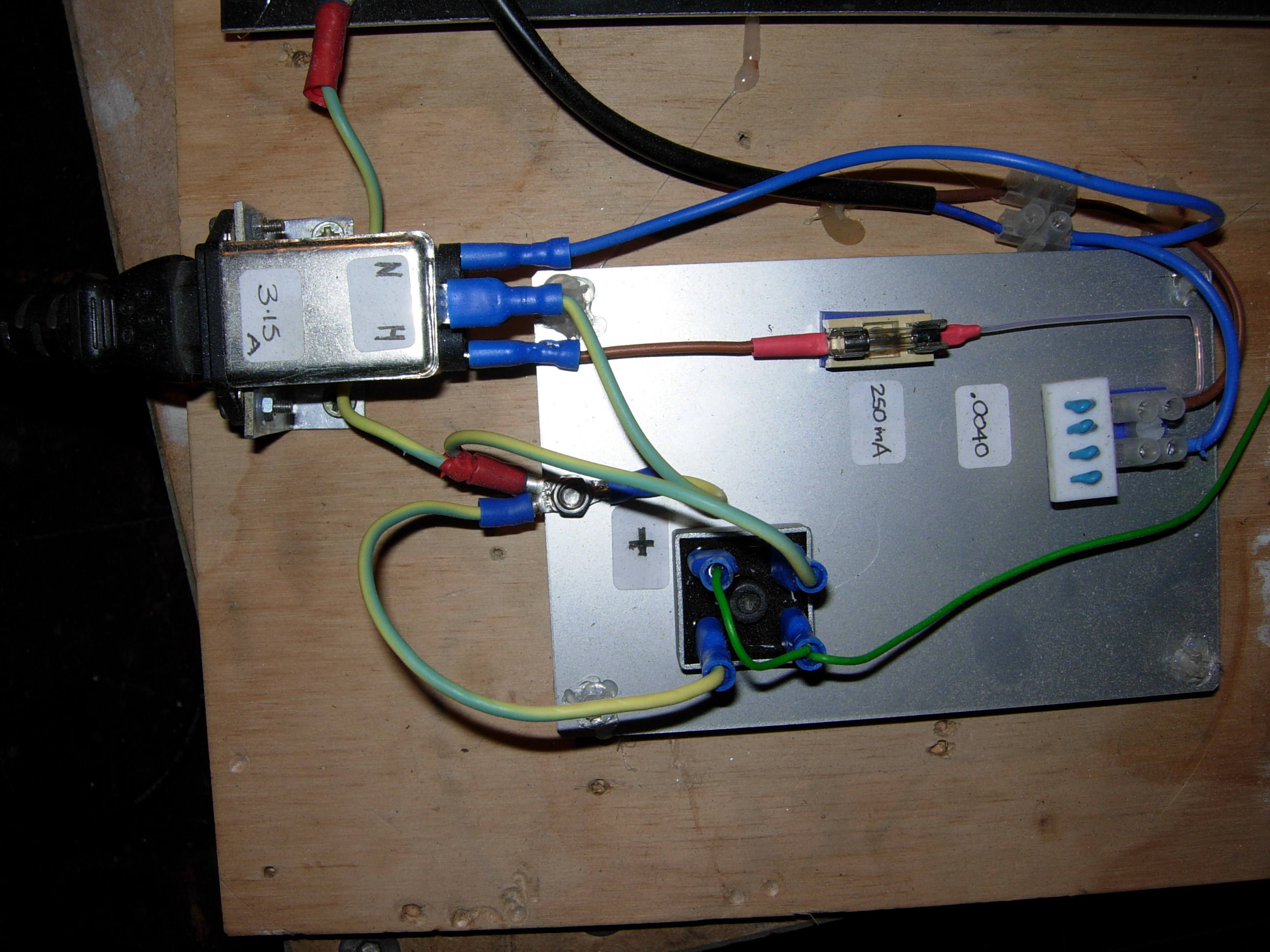

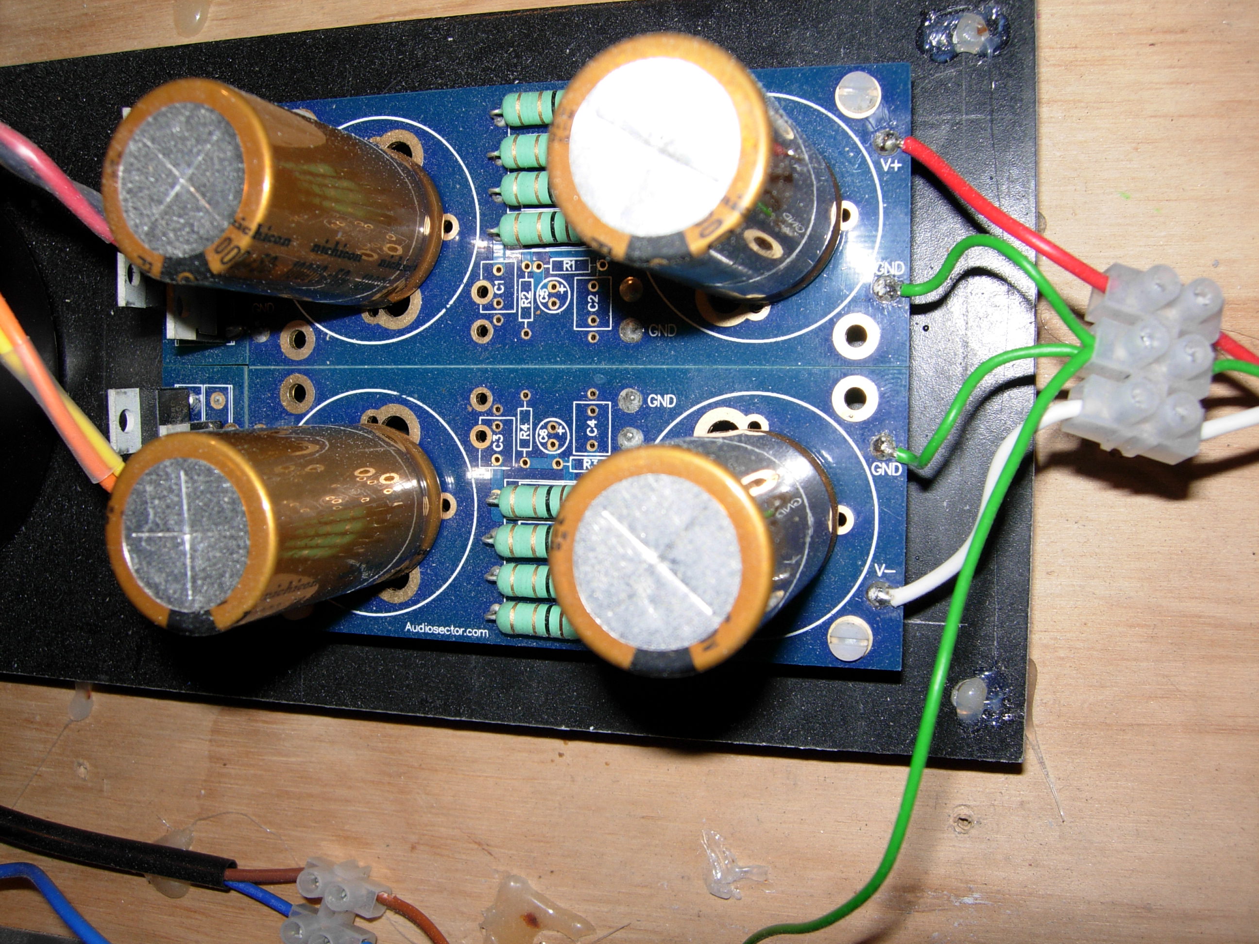

I keep blowing fuses .... I have checked one board and I'm with 1.5 VDC .
I unplugged it and plugged back in ... LOL fuse blew . Would an NTC across the
IRC stop it ?
I'm going to check the other board against the Voltages I have from Wayne . I'm checking one board at a time - the other board just blows the fuse as soon as I power it up !
Any guidance would be greatly appreciated 🙂

Check for shorts on the faulty board first with continuity meter. Probably a solder joint touches somewhere it shouldn't ...I keep blowing fuses .... I have checked one board and I'm with 1.5 VDC .

The read values seem fine at a quick glance except the -26.2 V at led reference point. Obviously value reading here should be : about 1,6V - 1,8V across LED1. Or, -22,4V to -22,2V between up leg (seen on schematic) of the LED and GROUND.

Thanks Nar,
I have removed all the active parts and checked voltages after regs and all good ...
I will test Jfets tomorrow . I have a transformer that will give me 9.75 VDC
will this be ok to use ?
best, Rich
best, Rich
You should use a 9 volt battery, because you need a fairly stable DC power source. If you have a good adjustable bench top power supply, you could use that, but a battery is a very good substitute.
Ok , now I have got 6L6 lost too ... when I wire one board at a time to PSU all good ,but when both are wired the fuse blows ( no actives on either board- all voltages are good post Reg ) . I'm sure that .250 mA is advised for 240 AC - 3.15 at IRC
6L6 has checked pics of wiring and confirms its correct . I'll put some on here if needed .
Thanks , Rich
Thanks , Rich
