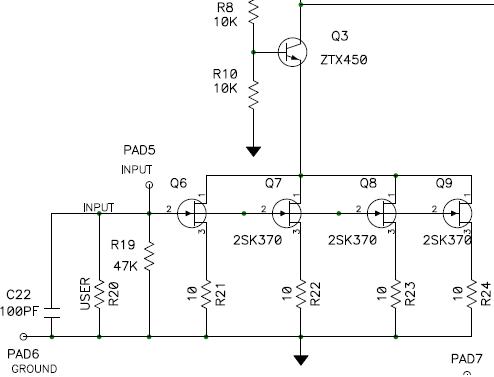

4 matched fets a channel, but I see 6 places for them?
The critical ones are the four paralled at the input. Four paralled to lower noise.
I suppose only 4 need to be matched. I dont know which ones, but I suspect its the two that are facing each other. ( 2 on each board) I'll have to wait for the article before I can build, but am anxious to start!😉

Each board requires four matched 2SK370 jfets at the input.
See post #322 for schematic.
