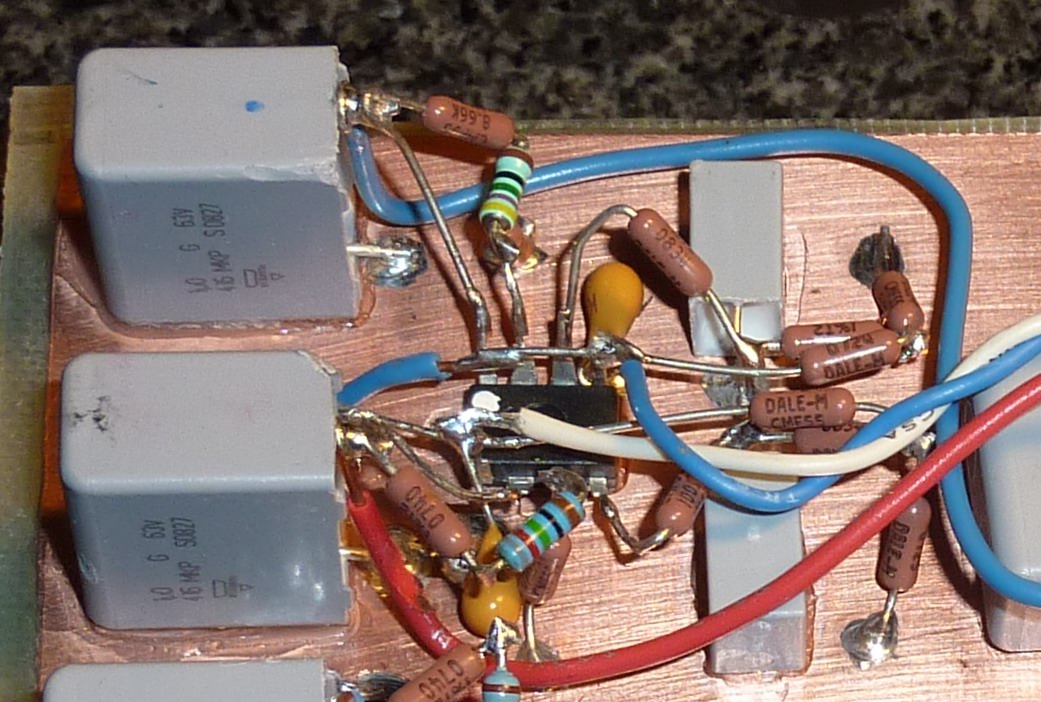

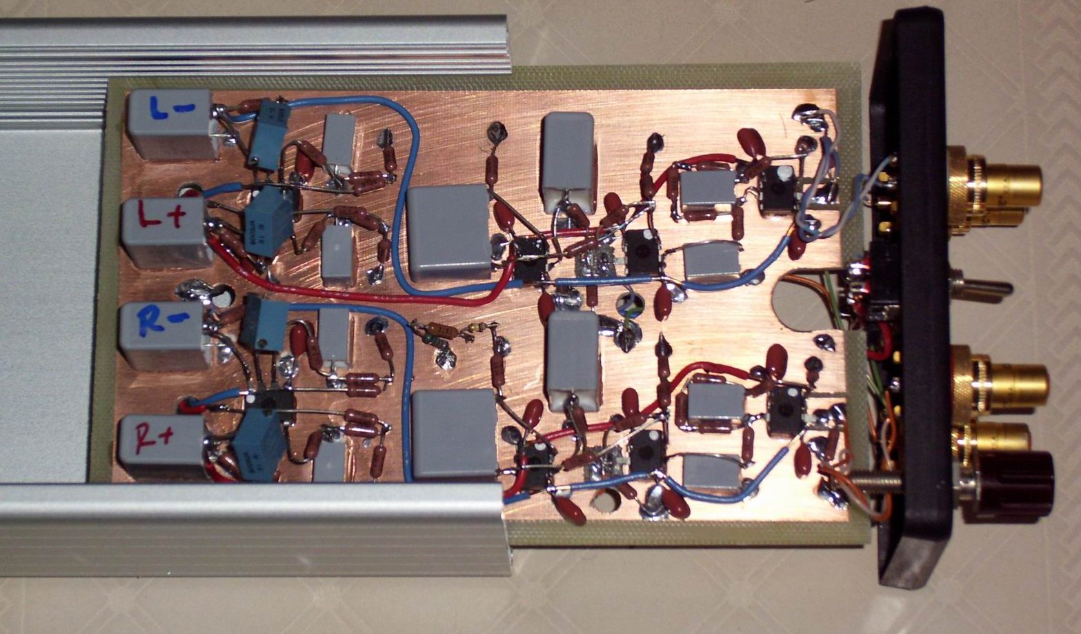

Here's a deadbug build of Joe Curcio's LM4562-based preamp from National's app note 1651 that I made last year. I designed a circuit board and redid it a few months ago. Building deadbug style and designing a PCB were both new experiences for me.I would love to see a pic of your P2P when finished. I've done it with tubes, but I just dont have familiarity with P2P with these tiny SS parts. Would love to see this done!

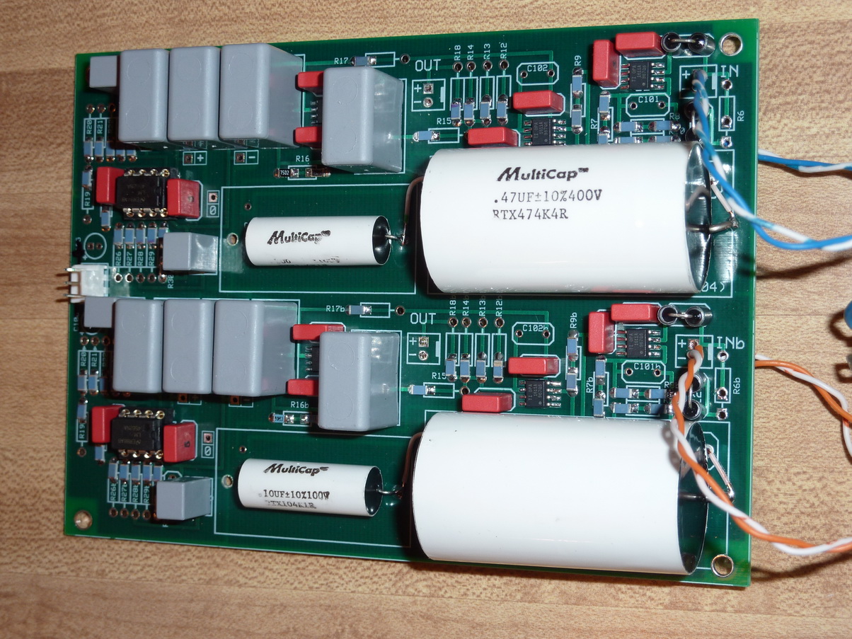

I collected my boards today. What a class act!!
They are BIG! Easy to read, nicely spread out... and they just have a classy feel about them.
Thank you everyone at Pass labs! Can't wait for the article.

Mr. Pass, is this for lack of better term?
There is also the setting of 5k variable resistor P1 to consider....
There's a TP & note in the silk to set P1 for 0 volts. So that's taken care of. Just need to figure out how to calc Cx & Rx. (I'm still confused by Cx. I need to brush up big time on my circuit analysis.)
But it's so much easier to wait for Wayne and Mr. N.P. 🙂
(uh... not holding my breath, but I'm sure it'll be done in due time)[...] time because a lot of the captured graphics have to be
hand-jobbed to be clearly legible. It's almost done...
Thanks!
-Chris
RX can just be a jumper wire or 10 - 100 Ohms. RX and CX are for future experimentation. Such as making EQ passive/active. Leave CX open for now.
Thanks Wayne!
