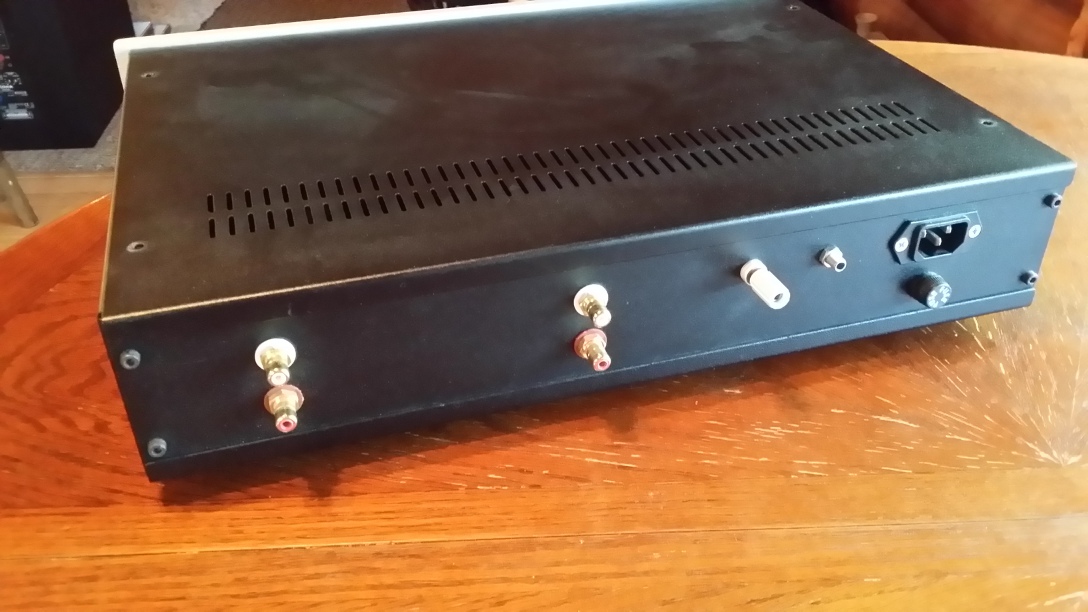

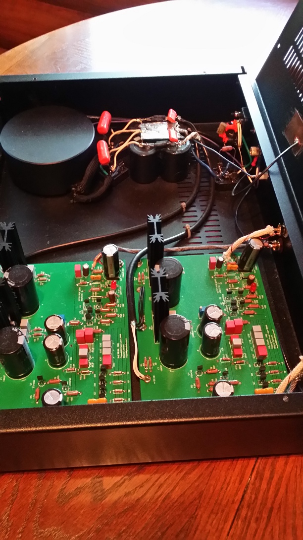

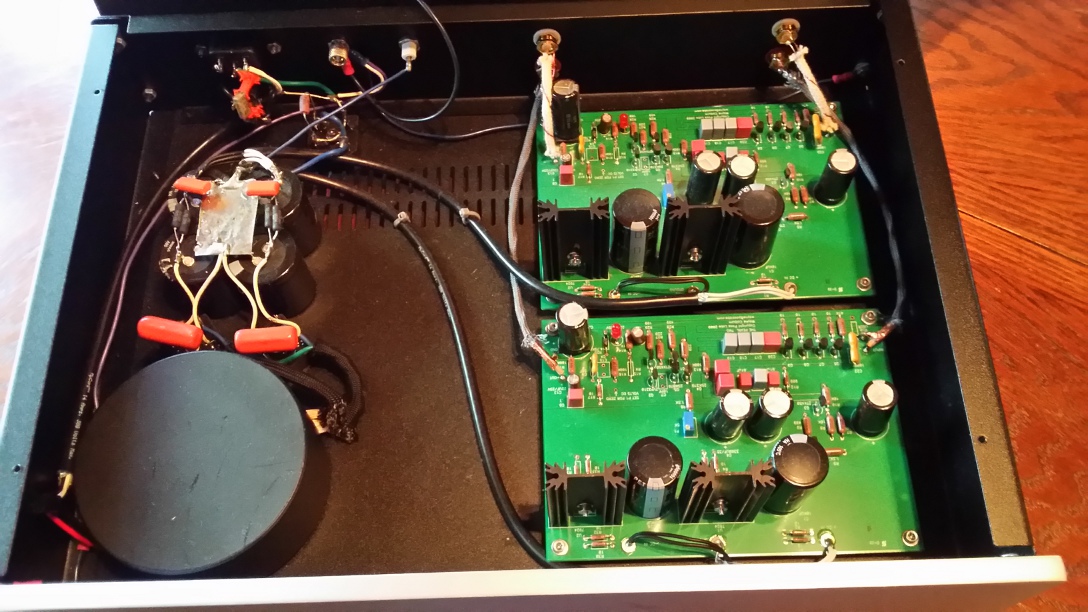

Pearl 2 in Pesante Chassis

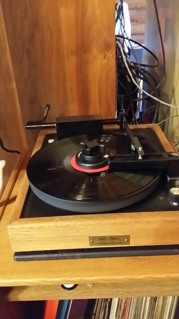

I built a Pearl 2 in one Pesante chassis trying to get it to fit in the shelf under the turntable. It resulted in no hum or noise at all. Here is some of what I did. I immediately went to a CRC to keep low voltage AC away. Put the inputs on the far side. From lessemf.com I bought a $30 gaussmeter to test for minumum emf. I also bought mucord from them and some mumetal sheets and foil (good source of small qts of mumetal). It turns out I did not need the mumetal for shielding. I used their mucord for AC in and DC to the boards. It did seem to lessen emf. I keep cables low as 6L6 suggested. From ground to earth I used just a 10R resistor and it worked great. I ran a wire from star earth to any panel without continuity. Notice the lid has a conductive copper tape with a wire soldered to it. The xformer is an Antek, either a 25VA 24VAC or a 50VA 22VAC. I cannot remember; I used whatever was in my parts bin.
The turntable is an air bearing Maplenoll which is very quiet to begin with, and a Denon DL-110. I cannot be happier with the sound. It is sooo....well..good (words cannot describe). My sincerest thanks to Wayne and Mr. Pass and 6L6 for the guide.

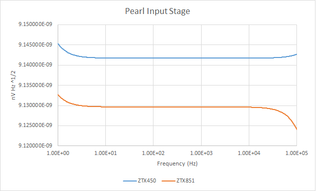

I don't think that you'd be able to hear the difference, but if you substitute ZTX851 for Q1 and Q3 (ZTX450) you might improve the front-end noise a bit.
The biggest factor informing noise is the paralleled njfets, the second seems to be the R7 bypass cap of 3,300u.

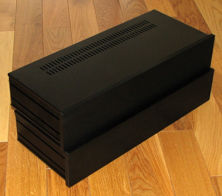

Craigtone:Woot! Chassis arrived today!
I feel pretty ... oh so pretty ... 😀
What chassis did you use on your Pearl 2 ?

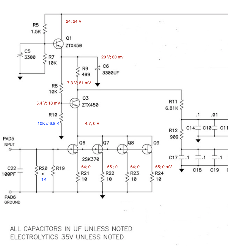

Need some help, please.
One channel went dead (due to statics, I guess) and
I try to debug which part(s) went south.
Q1 or Q3 or both?
Fingers crossed it's not input fets.
Please, find the voltages of both working (left) and dead (right) channels attached.

Hello Siberia,
My guess Q1 dead for sure. Not sure about Q2.
Change Q1 and power up to see if better. If not, change Q2 too.
Then re check again. If still nothing ok, might be the quad but unlikely

I just measured my Pearl
24.2 at collector of Q1,
20.5 at emitter of Q1
7.56 at base of Q3
6.87 at emitter of Q3
0.070 at source of JFETs
you have over 6.4mA flowing through the JFETs so you should be getting an output.
Isn't R10 supposed to be 10K?

Thanks, Nar, Jack, mlloyd1.
@aoc the reason for lowering R10 was getting closer to Wayne's voltages around Q3 and on the input fets. Done by quite some members here and learned on this thread.
