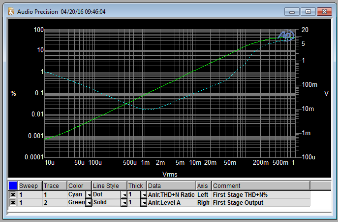

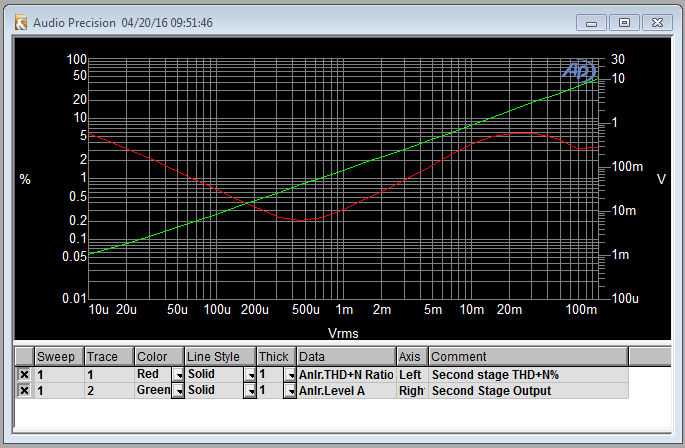

The Pearl 2 will not overload until you have about 10mV. That's more than just about any MM or MI cartridge available. And about 100X more than some low-output MC.

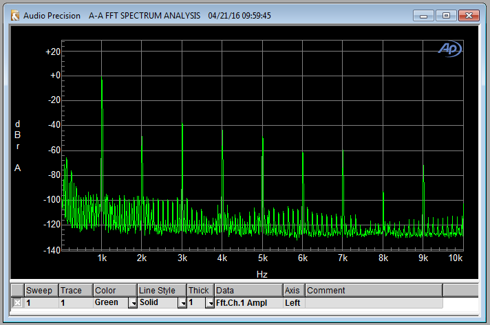

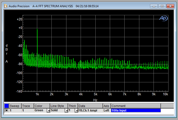

Some data. The charts are at 1kHz. The first three are inputs of 100uV, 1mV and 10mV. The fourth is THD+N% for the first stage alone, with the filter disconnected. The last chart is THD+N% for the second stage with the filter disconnected and the generator connected to the gate resistor.
If the typical MM cartridge has 1mV/(cm/S) this is what you're looking at in terms of possible signals which the front end has to deal with:

Jack, these are interesting data points that you are sharing with us. Since I'm relatively new to the technical side of turn tables, I'm wishing I had a greater level of understanding so I could gain more knowledge from what you've shared with us.
In the set of three FFT graphs you posted above, it looks like things are pretty clean a 0.1mV and 1mV, but falling apart at the 10mV level. This seems to leave a large space between 1mV and 10mV where some observations might shed some light on what happens with a 3mV, 4mV, or 5mV output cartridge and the Pearl II.
