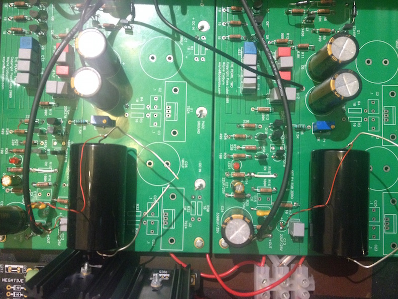

Motivated by the lack of music in my life, I've replaced stock output caps (22uF, Nichicon Muse) with my chunky radials (2.7uF 800V M Cap Supreme polypropylene) today.
The DC offset on the output is close or below zero mV on both channels.
But the sound is deceiving. Mid and top is A OK. But it lacks of kick, bass and lower register sound quite obviously comparing to what I've had with lytics. I also have to turn a volume more probably because of that.
My DCB1 preamp has 20K impedance load.
I've left bypass C8 .1uF film caps in.
Here's a picture of it. (I didn't remove the leads of those chunky caps in case I won't like them and would use in some other project.)

2.7 u is not enough to avoid rolloff in the bass seen your (relatively) low preamp input impedance
Try some other 22 u lytics, ... I used the green muse with satisfaction, those here :

Thanks, Anaël. I really thought my Supreme would be supreme, but maybe they really are too low of the value. I think, I've used Muses quite close to your linked ones. Mine were polarisé though. Leaked DC. Hope all is good over there in France. Cheers!
Try 10uF-20uF Silmic with M-cap as bypass.
PM me with your post address and I will send you some. 🙂
Or you can try 2 polarisés of your own but "tête-bêche" (2 x same value parallel and reversed) so they could block dc eitherways.
