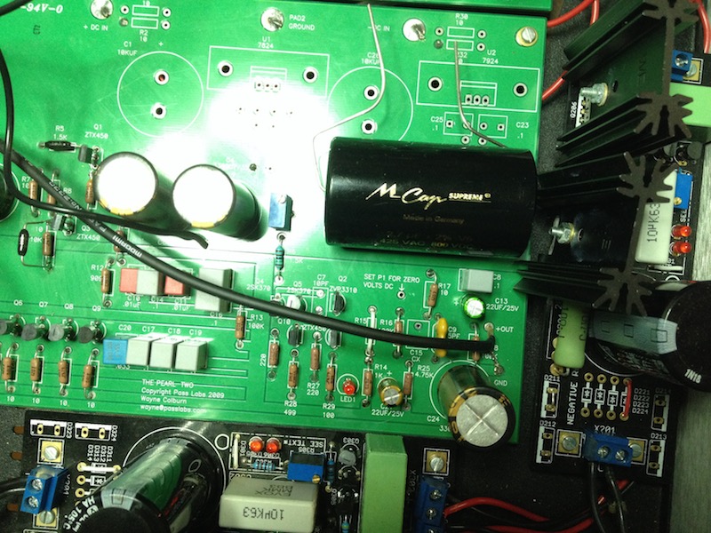

DC offset, measured at the pad, drifts the same regardless the polarity I set with P1.
But now I get that I should set it to the negative or positive and see if it affect the DC on ouput.
Please, tell me the value you are using for your C13 paper in oil.

So its a slow cycle that pumps that cap. Try a smaller value compact enough film cap in its place if you will not be able to solve the root cause.
Not sure about the value. 2.2 uF is OK?
I have some chunky 2.7uF mcap supremes somewhere in the box. Do those even make sense in that case?

Take it out and measure.
could put two back to back, to make a non-polar type, I am sure this reduces leakage.
try a lower leakage type ecap such as a UKL
493-10491-1-ND
UKL1E220MDD1TD
or a film type which is usually better.
A cheaper film is a stacked polyester type.
The drifting around, I guess can be due to thermal effects, with the lid off, try with the lid on and let it thermal stablize.
What type of gain stage follows the pearl2 phono, is it cap coupled? It probably should be!

That will make a difference with the lid off. When I built mine, just waving my hand over the board would cause fluctuations on the output looking at the scope.
Run a signal for 20 hours or so ( RIAA inverse box) thru it for awhile, and I bet your offset will come down.

Are you talking about the output cap - C13? Wayne voiced that with a Elna Silmic II and Wima MKP bypass. I have the Silmic in mine, I love it.
However, you could try anything you like in that position, with a value of 3.3uF or more. (3.3uF gives an F3 of 20Hz)
The measurement is taken from test pins and referenced to ground if I recall.
Depending on the PSU you use and ground wiring, 0V ref. might fluctuate a little, giving you
strange results, even measuring after the caps (whilst measuring between output of caps and ground).
I don't recall if there's an "output cap bleeder" on schematic, a high value R between cap out and ground, ensures that cap is properly DC loaded to block output DC.
Absolute tolerable DC at the output depends on the preamp you use after. If coupled with input cap you shouldn't have to worry ...
