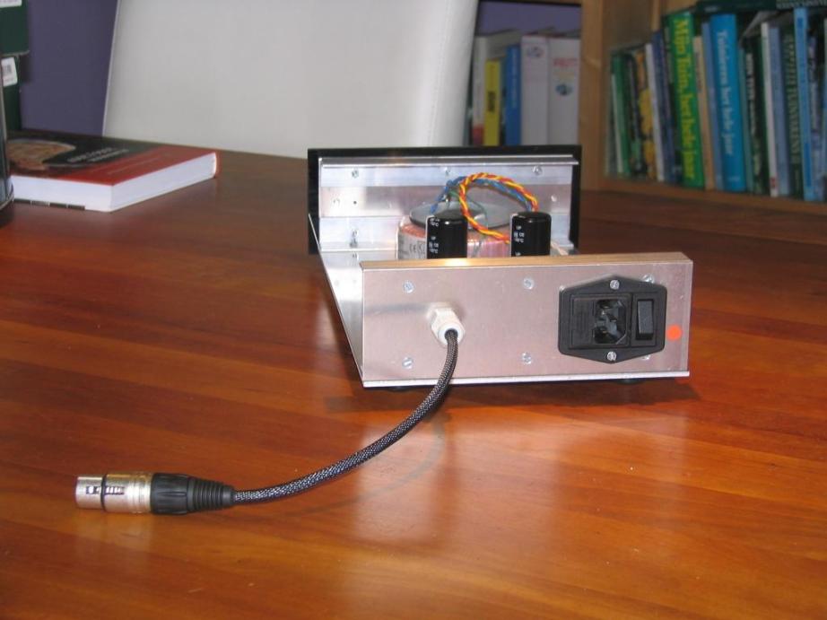

Manu,
A friend of mine is working in the maintenance business. To be specific in the rewiring of F16 fighter jets. He was so kind to give me some feet of "stranded silver plated copper teflon cable". The cable configuration consists of four strands of this silver plated copper teflon stuff in starquad covered by a shield, which is covered again by another layer of teflon. The nylon sleeving was added by me to pimp the looks. I use this wire in the power supplies of all my DIY projects.

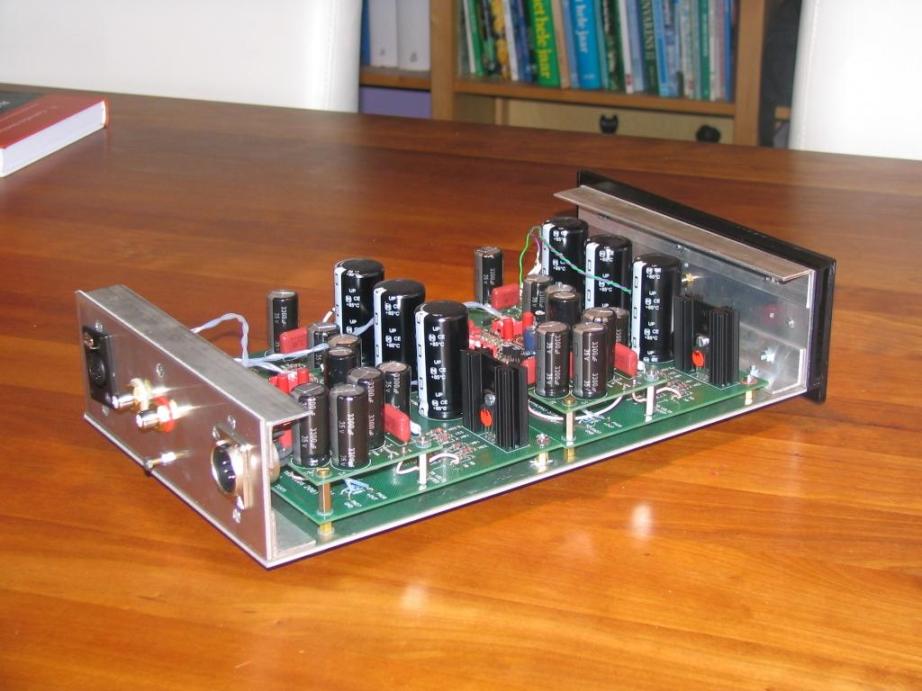

Here is another MC-pre-pre and Pearl in working condition.
And it sounds very good, just a few minutes of running now.

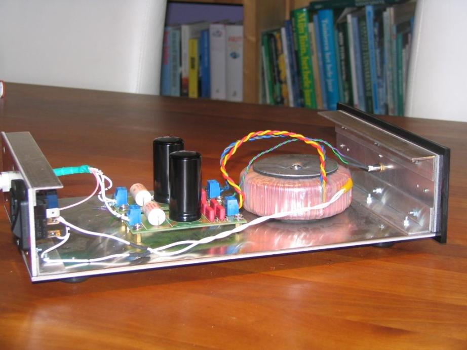

Whole picture inside:

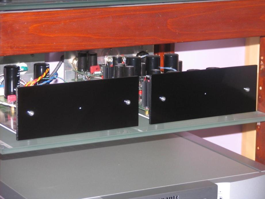

The MC-pre-pres are in separate boxes:
The PSU at ens of two meter cable:
And the front:
Still missing some texts at front and back, but listening of it is more
interesting.
