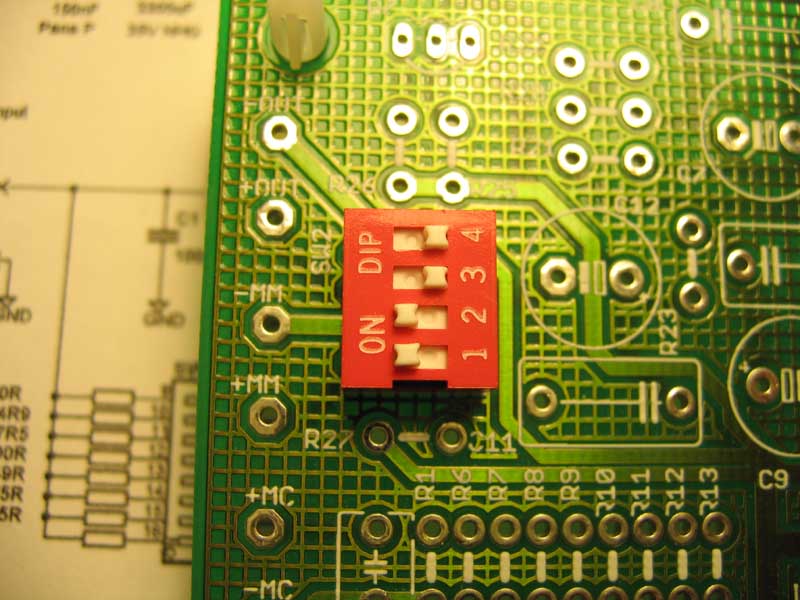

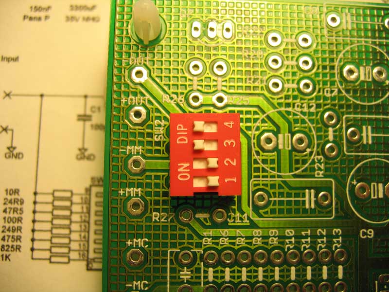

SW1 is used to set the load.
The easiest is to use 1 switch.
SW1 1 R6 1000R
SW1 2 R7 825R
SW1 3 R8 475R
SW1 4 R9 249R
SW1 5 R10 100R
SW1 6 R11 47R5
SW1 7 R12 24R9
SW1 8 R13 10R
You can of course use multiple resistors to parallel them and get values in between.

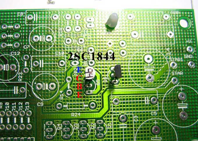

Some people are asking about the placement of the Q5 Transistor.
If you are using a BC550 just follow the layout.
If you are using the 2SC1844 from the KIT you need to solder it like in the photo. because it has a different pin out.
You need to move one position up.
Check the new Photo to see the 2 different pinouts.
