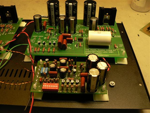

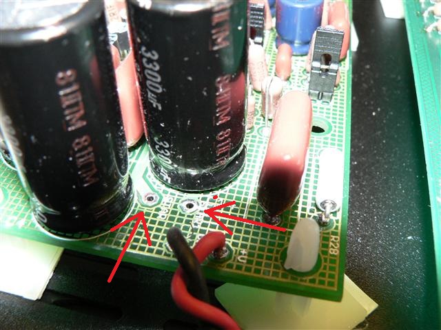

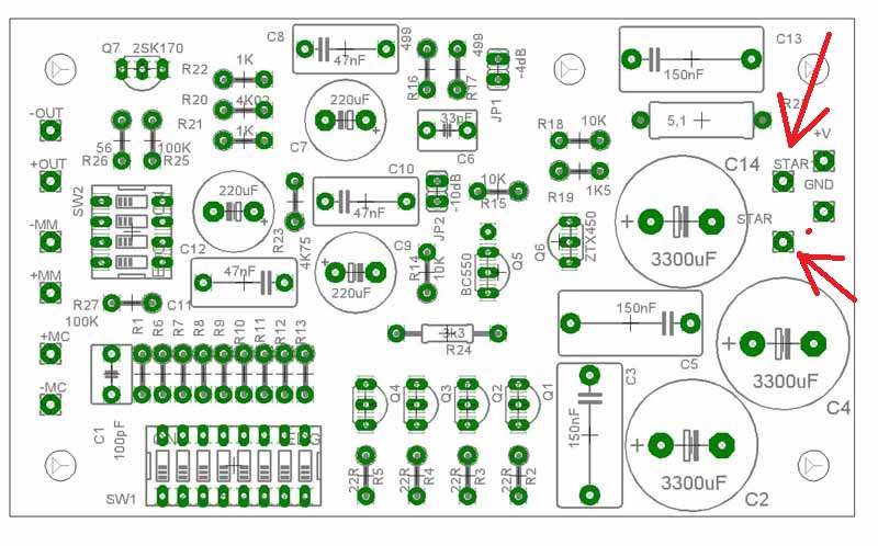

I got the complete kit a few days ago. That kit contains 2 mainboards, 2 MC pre boards and 2 PSU boards. This threat is about the MC pre boards, so that is also what my question is about. Once again, Why wasn't "Star" not connected to "Star1" when there is room on the PCB to do so?
Is it better to connect "Star1" to GND and leave "Star" connected to 0V (so not shorting 0V to GND via this connection)?
That doesn't sound like a description of what's available from Pass DIY, so it would appear you've bought a preamp from another source? Where did you get it, and what is it? Can you post photos? We'll need more information before anyone will be able to answer your question.
I got the kit from a friend. The board I'm talking about is the board from page 3, posting #23 of this topic. I attached the drawing of that board and marked the "Star" and "Star1" point with a red arrow.
The qoute in my first post is from posting #38 of this topic.
My question remains. Why were "Star" and "Star1" not connected in the PCB layout?

This is the correct schematic.
