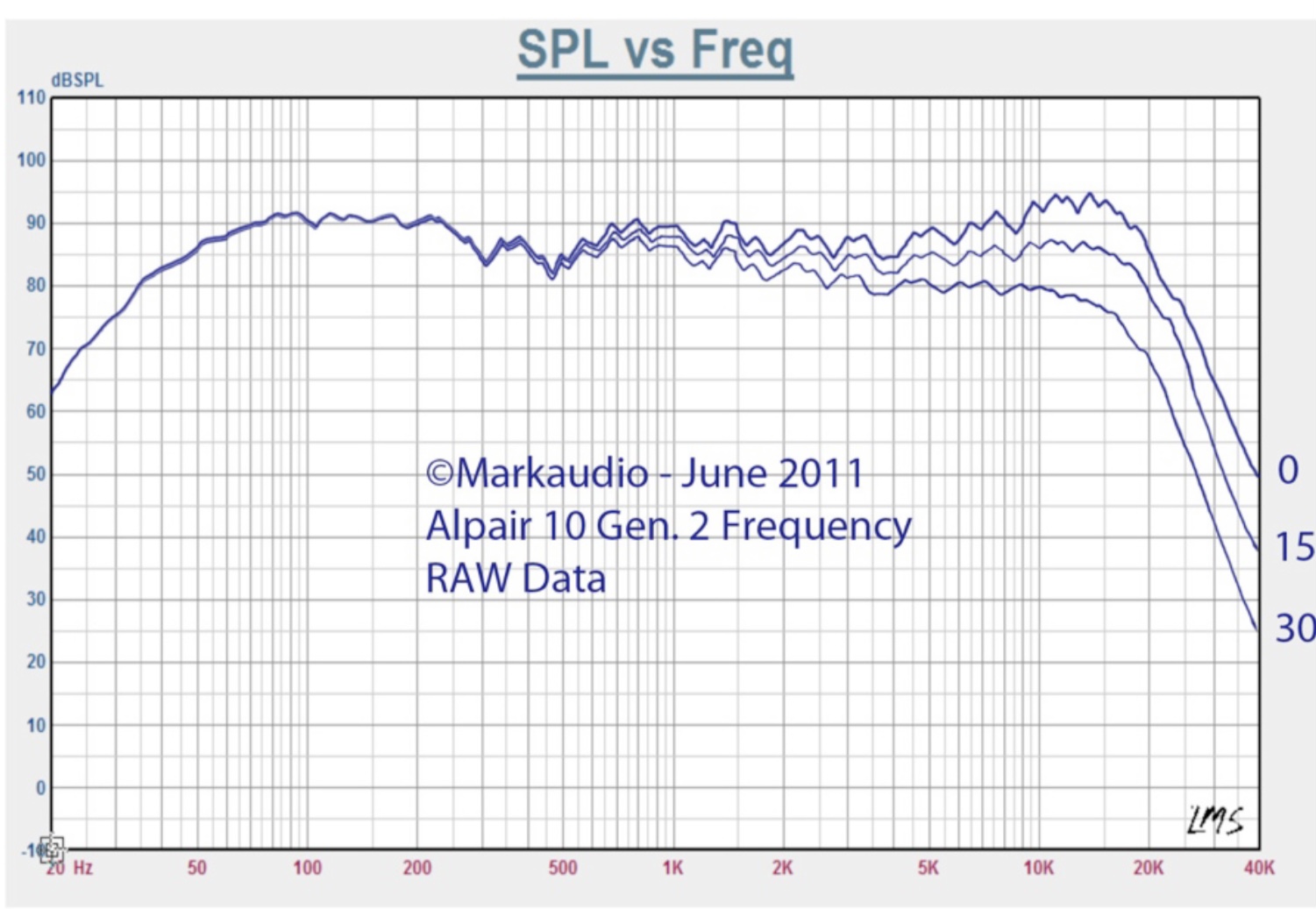

This is because a driver measures very different in a cabinet compared to without a box or in an infinite baffle. The measurement result will differ more than 10 dB at some frequencies.
The cabinet will give you difractions, bumbs and dips and baffle step losses, - all depending on the specific geometry of the loudspeaker box.
Understanding this, one realizes that frequency measurements are wortheless from the driver manufacturer because in the real world you always put the driver in a cabinet.
Markaudio has 100 dB on the measurement scale. The standard measurements procedure at stereophile for loudspeakers is 50 dB . You have 70 dB on your measurements. The graphs will look very different only because of that.

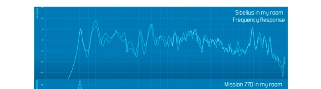

Measurements from an actual Sebelius by a reviewer “Pursuit Perfect System”. Thoughts?I don’t know why I measure at 1 meter from the driver in the Sibelius clone cabinet a dip at about 4K while the frequency response graph on the Alpair datasheet does not have this.View attachment 1391261
Baffle step ” bump” at 1 kHz ( the cause is the box shape ) and the inbuilt dip at 3,5 kHz caused by the driver . Psycoacoustical correct to sound good with two stereo speakers.
The mission 770 has this 1 kHz bump to, but to lesser degree. Its because of the box shape. A flat response in this area makes the speakers sound boring with two speakers and very much sounding like two boxes and not the real event.
As I wrote earlier, the Sibelius is much more ” right” than any Harman corrected speaker when used with stereo listening, but the bumps and dips in the Sibelius might be a little to much ( can be corrected with dsp - see the post 1070 and 1093 )
Edit : the measurements done by Pursuit perfect system seems do be done by an amateur , no gating used meaning one can not trust anything below 300 Hz . Maybe he also used two speakers at the same time measuring from listening position , this will give comb filtering issues making a false result from 300-20000 Hz. The measurement is probably wortheless.
The correct way to measure a speaker is much more like this , 1 meter from only one speaker. ( ignore result below 200 Hz ).
The sloping frequency curve is only the bass port.

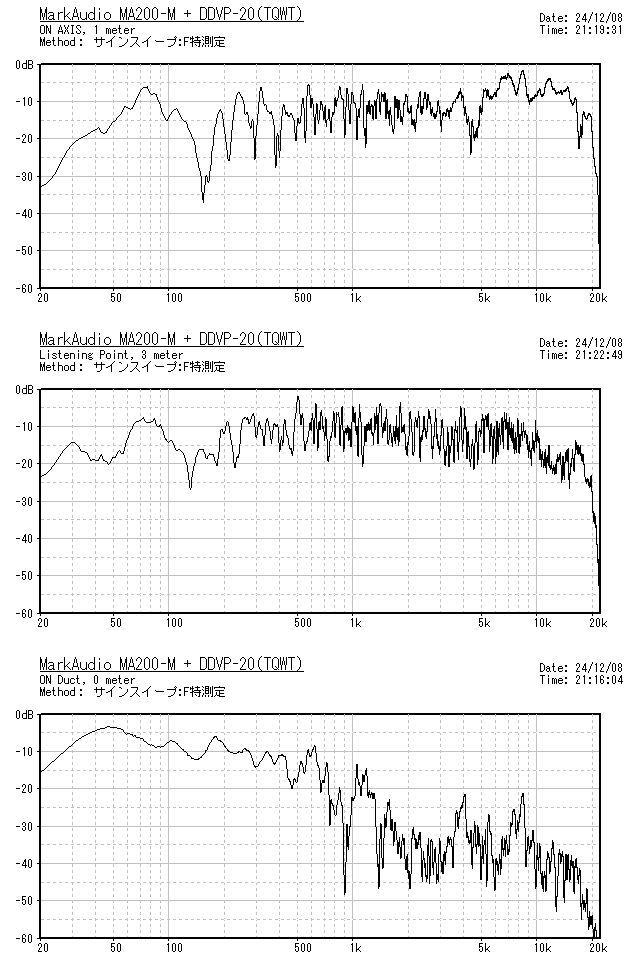

Quite consistent to both the driver & other clone measurements as far as trending goes -it appears mostly a matter of difference in scaling / smoothing / window applied, and potentially some mic. positioning differences -a few mm difference in alignment can make quite a difference.Measurements from an actual Sebelius by a reviewer “Pursuit Perfect System”. Thoughts?
With my generalising hat on, as far as measurements are concerned, when it comes to smaller or single driver speakers, I tend to follow Jeff Bagby's preference for a mic. distance between 3x - 5x the effective radiating diameter of the driver, providing this also provides a distance at least double the effective baffle width -if not, it needs to be kicked up to that to correctly show diffraction. Levels can be normalised to the 1m/2.83v standard after that if desired, although that's not really necessary unless you want to show that SPL value. Vent output needs to be taken using the normal nearfield techniques of course, normalised to the direct driver SPL & spliced or preferably blended into the driver output for a reasonable average.
for this box?Another interesting measurement for the MA200 by @nandappe, just highlighting the techniques used
