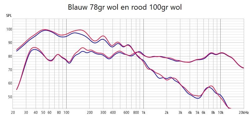

Back to building the Sibelius myself, because that is what this thread is about. Here are the measurements in my room at 1 meter distance from the driver and at 0 meters from the bass port. Of course you can also see the resonances of my room. I measured here with 100 grams of longhair wool (red lines) and 78 grams (blue lines)Excellent work! Pretty impressive
Care to show us how the measured response looks like e.g . near field of the drivers and fb from the bass port? thank you ☺️
The sound of the Sibelius is very natural and spacious. I have never heard anything so beautiful! You don't want to spoil that with filters. The power of design is that the driver is connected directly to the amplifier!Biggest upgrade for the excellent Sibelius clones is a steep highpass filter below tuning frequency . This can be done with a WiiM Ultra. If fb is 35 Hz , set the stereo highpass filter for the main speakers in the subwoofer meny to 35 Hz . It will roll off below that frequency with 24dB/oct electrical. The Ultra puts out a filtered signal through spdif also, if one want to use an external dac as I do.

Back to building the Sibelius myself, because that is what this thread is about. Here are the measurements in my room at 1 meter distance from the driver and at 0 meters from the bass port. Of course you can also see the resonances of my room. I measured here with 100 grams of longhair wool (red lines) and 78 grams (blue lines)View attachment 1390561
Very nice, finally some significant information that indicates the correlation between what is measured vs. what is heard. Well done 🙏☺️
That is with 10.2 or 10.3?Back to building the Sibelius myself, because that is what this thread is about. Here are the measurements in my room at 1 meter distance from the driver and at 0 meters from the bass port. Of course you can also see the resonances of my room. I measured here with 100 grams of longhair wool (red lines) and 78 grams (blue lines)View attachment 1390561

Nice to see some relevant measurements 1 meter from the Sibelius speaker.
I hope your measurements is with only one speaker active ?
What microphone did you use ?
A dsp would surely make the sound even better . In not saying that a flat response is the best , far from it, but the -5 dB dip at 3,5 kHz would sound better with a -3 dip instead. And that diffraction peak at 850 Hz ( + 2,5 dB ) coming from the geometry of the box is also easily bettered with some mild help of PEQ.
All of you with the Sibelius that have a dsp : Just print frequency : 850 Hz , gain : - 2,5 dB , Q: 3 . And PEQ = frequency : 3,5 kHz , gain +2 dB , Q= 1
Try it and come back for report.🙂
* the dropping curve is only the bass port.
We see diffraction at 850 Hz and a bit to little energy at 3.5 kHz .

Blue = more stuffing = less output, no?I measured here with 100 grams of longhair wool (red lines) and 78 grams (blue lines)View attachment 1390561
Well, if your filtering /EQ is upstream or even inside the amp, then isn’t that connection still direct?The sound of the Sibelius is very natural and spacious. I have never heard anything so beautiful! You don't want to spoil that with filters. The power of design is that the driver is connected directly to the amplifier!
Red is more stuffing (100 grams) and more output. More important; the resonance frequencies are equally high, what means that the transmission line and the bass port are tuned to the driver.Blue = more stuffing = less output, no?
