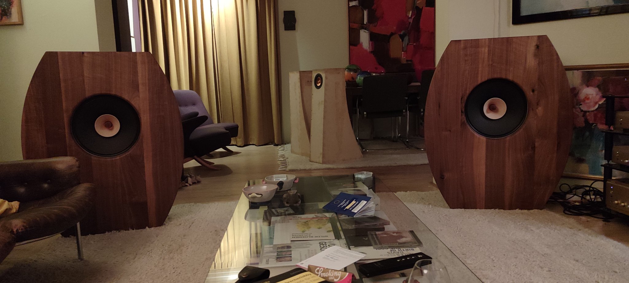

I have their Lii F15.
Too big also.
Reactions: Hondasnl
