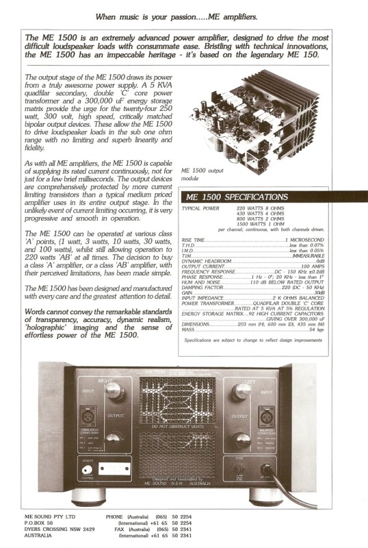

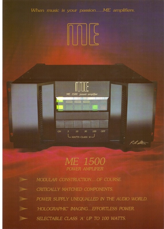

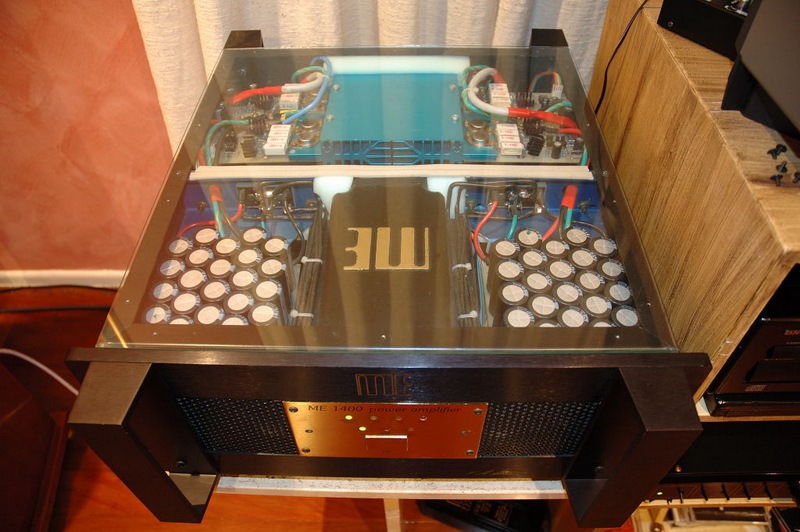

And I'm not in the Class-D camp, I use them with their drawbacks because they are the closest amps I have found that get near to the sound of big high biased Class-A push pull BJT enviroment killing amps, like this magic sounding amp (again with no global feedback).

The NC500's didn't have enough current for me for my last speakers, (2ohm 87dB) like my above ME amps into them had without a sweat, so I sold the speakers and replaced them with some 91db ones that don't go much below 3ohms. These Hypex NC500 work quite nicely into them, still not quite as good sound as the ME sounds into them, but at least I'm not killing the planet.

It's not just GaN or Hypex/ etc, it's Mosfets in general even in linear complimentry push pull amps. They just can't cut it into the real difficult to drive speakers like the "better" complimentary BJT power house amps can, into speakers like Wilson Alexia, with their .9ohm <100hz in the bass where you relly need big current without amp breaking into a sweat.
That's why you see the Grypnon's, Krell's, D'Agostio's etc etc are still staying with linear BJT Class-A/B amps for the higher end of the market, I'm sure they would go over to Class-D if there was a way of using BJT output devices without any draw backs in them.
