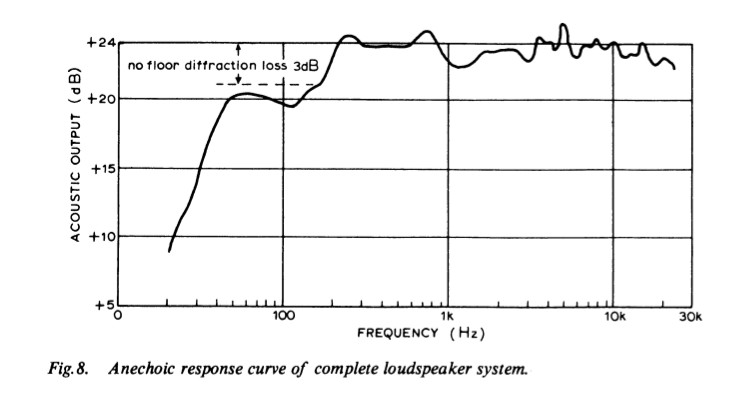

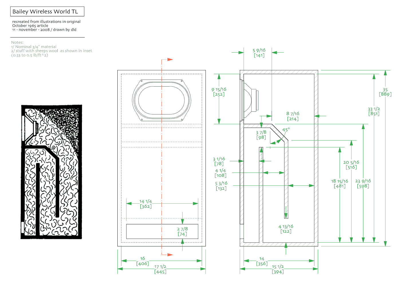

It depends what 'calculations'. You can measure (or model) the response of his enclosures, and by definition they each possess some kind of alignment because it's physically impossible for a speaker not to. They don't 'provide' alignments though. They simply show the response characteristics of the measured or defined speaker.if you plugged in Bailey's two instances of TLs the calculations would provide alignments.
It's technically possible, if you know the LF characteristics of the drivers Arthur used, to take those, his enclosure dimensions and a near-approximate for the damping, then empirically work out a set of formuas that will allow you to consistently achieve the same alignment* across a range of suitable drive unit characteristcs. And somebody has done that: they did 24 years ago. That's roughly the starting point George Augspurger's extended alignments. Not identical, but similar. With a bit more time available, we can probably come up with something even closer. But there's a caveat to that, which is the reason for the asterisk above and below. 😉
*Arthur was general, rather than specific. His two WW articles were 6 1/2 years apart, and the two nominally completed speakers presented actually had two different responses, so there wasn't a great deal of consistency there, and while it's technically possible to work out and therefore repeatably track the alignment of one of his offered designs, you can't do both at once because they're different. Name your poison, as they say.
A couple of other points on his '65 WW article that often get overlooked are worth noting. Arthur's experimental folded pipe (Figure 5 in his '65 article) had an adjustable terminus flap, so it could be run closed (a 1/2 wave pipe), or open (a 1/4 wave). He settled on the latter for the production speaker design, mainly because of the bass reinforcement from the mildly resonant line. He was also very careful, when presenting the data and stressing the low pass nature of the pipe, to show a graph (Figure 6 in the same) indicating its behaviour when the pipe was run as a sealed 1/2 wave type (terminus closed) rather than open, since this naturally shows a more effective / rapid acoustic LP. 😉 His exploding wire impulse response is often (rightly) lauded as one of the earliest examples of such measurements -but even then we need to be careful because the comparisons are loaded: the pipe was run in its closed not open form, unlike the two bass reflex enclosures, automatically biasing the results in its favour, because a sealed system, being 2nd order, will almost invariably have superior performance in this regard to a 4th order system -whether Helmholtz or 1/4 wave based. This wasn't deception, since he does state what it is, but it's certainly presentational sleight of hand as it isn't stressed, and many at the time (and even more since) have missed this aspect as a result. I don't blame him, as he had a modest financial 'interest' in the matter, but it's a significant detail that's best kept in mind.
This is also why you see the deviations in the FR of his production speaker in the 2 octaves above Fb (Fp), because the LP effect isn't as rapid as with a sealed pipe for obvious reasons. Not unless you rammed it so full of damping there was no usable output from the line (which is what he was after) and risk mass-loading the cone / suspension, which he also refers to, albeit in slightly different terms.
A starting point:
dave
The response of the TTL is not great by his measures (the significant step at teh bototm does not look like step=-loss:

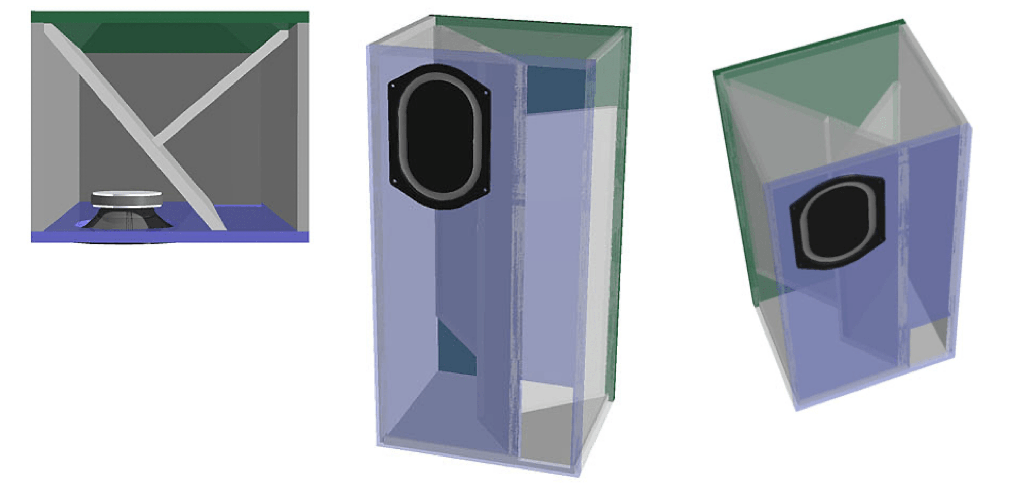

Notionally, I always thought of Jennifer as a lobster trap... what goes into the line doesn't come back up -- a ratchet. Maybe an asymmetrical "saw tooth" wall would perform better than the simple reflector that works as well in both directions.
I believe the time smeared stuff coming back to (and through) the cone from the enclosure were of prime concern to Bailey. Less so the bass augmentation.
Yes.
I seem to remember hearing that about the reflectors. Any idea why? At first blush they made sense (at least to try).
The expansion in the line if the deflectors are left out creates an acoustic low pass filter, killing more of the top you do not want out the terminus.
The function of the line & terminus is to be a sufficient low pass to filter out the unwanted harmonics and preserving th efundemental (if your goal is extended bass/more bass gain)
