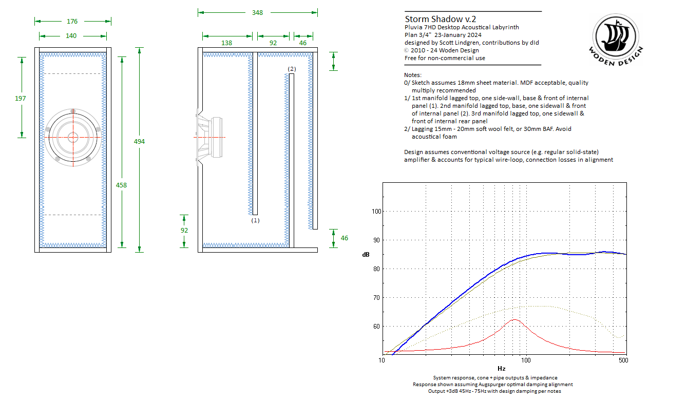

You touched on this in your presentation back in 2018 (which was a good show by the way). I run into the same problem with my main passion, electoral reform: poor language gets in the way of meaningful discussion with little progress and often leads to unnecessary acrimony.
it's too bad Bailey didn't publish more on his empirical work... he obviously did a fair bit.
By the way, what did your aperiodic line wind up looking like?

'Near-aperiodic' rather than aperiodic. Just a continuation of my desktop / standmount labyrinth series (attached). When I design them it's to the alignment shown (this is a specific, repeatable alignment of my own -the frequencies & SPL vary of course depending on driver, but the actual alignment in terms of shape, behaviour etc. is consistant) which is quite similar to Augspurger's and Bailey's, but they're run as acoustical labyrinths with the lagging indicated in the sketch & notes, as most people want / require the higher gain with small drivers.By the way, what did your aperiodic line wind up looking like?
