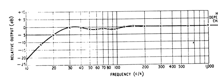

Bailey’s title suggests the target was an anechoic line with no gain from the back wave. What he built and showed did have some, using the (mostly) fundemental resonance to reinforce the bottom.
You can see the unwanted harmonics appearance in the ripple from 40-200 Hz.
He did a good enuff job to spawn a wave of (classical) TL development (Radford/IMF/TDL + many diy articles). Augspurger, and especially King’s models showed us and allowed virtual experimentation in a much larger design space, taking more degrees of freedom into account.

Agreed. I think Bailey did a good job stating his approach and achieving his goals.
He aimed to build an enclosure that minimized harmful resonance effects rather than fiddling around with them. That he used one productive resonance effect shouldn't detract from his effort (nor should the piling on of the expansion.
