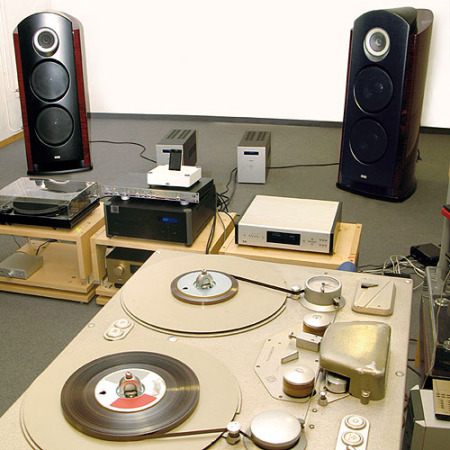

Re the Wadia test:
it seems like there are a couple of missing steps?? Like analog to digital conversion and mastering before the Wadia even comes into the picture. Of course those processes have zero impact on the sound being transfered to cd in audiophile phairyland. 🙄

spzzzzkt said:Re the Wadia test:
Ideally speaking, the music is always being recorded in natural acoustics and one does not need any intervention in altering the recorded sound later on.... The problems start however when the recording-location is not ideal, like it is in reality. In such a case (and there are many), artists might face some sound-engineers whose ego is much bigger then their capability 🙁 .
Good to know that we don't have anybody like this on this forum, of course 😉 .
And there are very positive examples: Listen to Aulis Sallinen (* 1935) Symphony 8 & Violin Concerto on cpo 999-972-2, with Jaakko Kuusisto (Violin), the Staatsphilharmonie Rhenland-Pfalz conducted by Ari Rasilainen: It was recorded in the orchestra’s rehearsal room - the very small hall called Ludwigshafen Philharmonie, a not great sounding location, where my very dear friend Stephan Reh did excellent recording and post production job. It sounds "Wow!".
Post-production is quite a reliable process nowadays and many sound engineers are very sensitive to critic. Concerning the Wadia-Test, it seems to me that the engineer Andreas Spreer & his “Tacet” company (who are declared to be purists) have done some good mastering/post production job, so that the Wadia sounds - all in all - like the original Master (very probably).
There are good recordings around and we should arrive to this level of true Hi-End soon....
To be continued.
Greetings,
IJ.
IJ,
I'm sure the recordings are good. My point is that there are processes applied to the original recordings to prepare it for CD which mean that the CD is not going to be 100% perfect representation of what is on the master tape. To then compare a master tape with the playback from the Wadia is comparing the sum of differences resulting from these multiple conversions, and not simply the contribution of the Wadia.
Can you identify with any degree of certainty where in that chain the loss of overtones from the violins originates? It could be at A to D conversion, in mastering or dithering the converted data for CD, or at playback. This is why the using this process to make specific claims about the performance of the Wadia is nonsense.
best
PJ
best
PJ
spzzzzkt said:IJ,
Should not be so, of course.
Agree. It would have been much better to have a different chains, like having at least 3 different recording desks, 3 different A/D (includes the Lavri..), etc. etc.
Might well be! All what it IMPLYS is that the Wadia is not realy a bad player... Still, we are looking here for having it better with our PCM63, with no intern upsampling - no data boofering - no digital volume (etc. etc.), so unless the Wadia is a pure manipulation - BTW I assume it is not - we might not have it so easy after all. However we already know this 😉
Remember, the Wadia is here only as a reminder (after Regel's remark) that PCM1704 can still be a good Chip.
Warmly,
IJ.
Unfortunately the real world falls short of perfection. For example it is not possible to down sample without loss of detail for example. If the Wadia is playing red book CD the source has been down sampled and CANNOT be 1:1 with the source. You lose detail at this point no matter where it was recorded, who the performer was, or which selection of esoteric gear was used to capture the performance.
I don't doubt the Wadia is an excellent player. What I question is the value of comparisons between original analog source and CD as a means of identify the characteristics of the player alone. If the comparison had been done in the mastering suite comparing playback with the digital mater through the same monitoring system you would have a meaningful comparison. As it stands the test is of the entire digital chain, and looks like nothing more than a marketing stunt. I wonder why that might be
I also agree that the PCM1704 is an excellent chip. It's been used in some very good products - Mark Levinson No.36, Krell , Wadia, Tent Labs DIY, Shanling, Primare....
